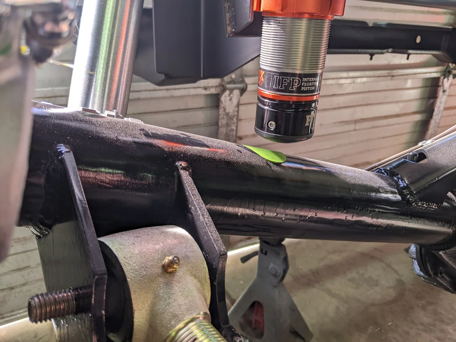

You have it right, the bump stop is slightly inboard of the shock meaning that it (bump stop) doesn't have to compress fully at full shock compression.
The shock is at full compression in this pic. The hydro has 3/8 to go. One thing I'm new too is hydro bumps. I don't know if they are more or less resistant to being compressed in a rock crawling situation versus a standard jounce. They may not compress at all under static weight. I can lift the jeep off the jack stands without the moving at all when they are charged. But the "jeep" is just a chassis and body at this point... So many unknowns.
I don’t have any experience with hydro bumps either. When the weight is pushing up through the tire on the trail instead of a Jack on the axle, that may put more leverage and help compress the bumps. You are able to lift the Jeep with all the weight on just one bump can?
Yup, but remember, no interior, roll cage, engine, transmission or transfer case in there at the moment.
Makes more sense. If you build it with the shocks as the hard limit, you can always adjust your bumpstop situation later if they aren’t compressing to your liking
