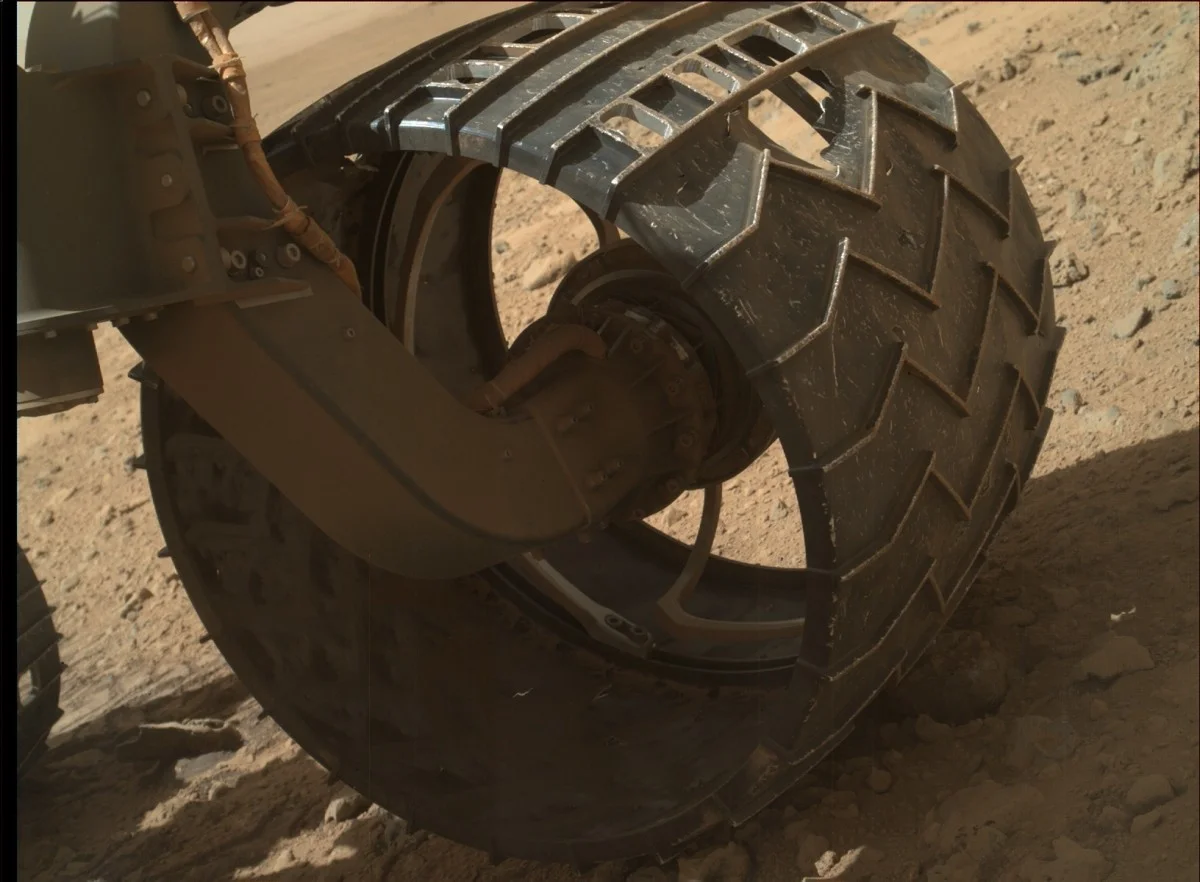

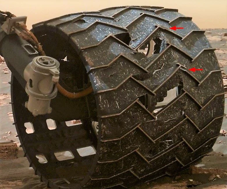

That picture really confuses me. I get the mold is screwed up but that is a detail that won't affect functionality by any appreciable amount. What confuses me is the rectangular hole you can see through the backside and why you can't see them on the other side where you are looking at it from the dirt side. WTF is going on with that?
That's a wheel from the Mars Curiosity Rover. My recollection is that it was designed to be as lightweight as possible and just tough enough to do it's job. Though they are breaking apart faster than expected. Then the tread pattern allows for different types of digging, scraping and excavating for the test equipment. The rectangle holes are part of that design. Also, the rectangles spell out JPL in binary, morse code or something. There are a neat wheel.
