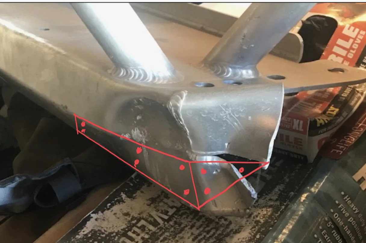

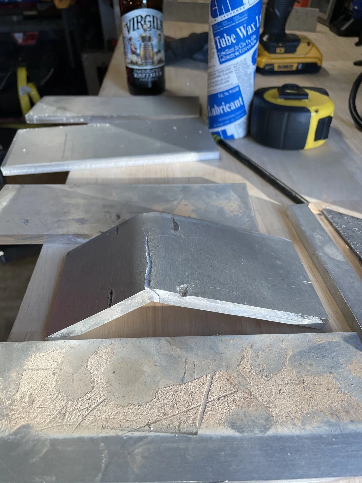

Here’s a piece of 6061 T6 that I broke (literally) with a small inside rad.
Here’s another with a larger rad.View attachment 229856View attachment 229857View attachment 229858

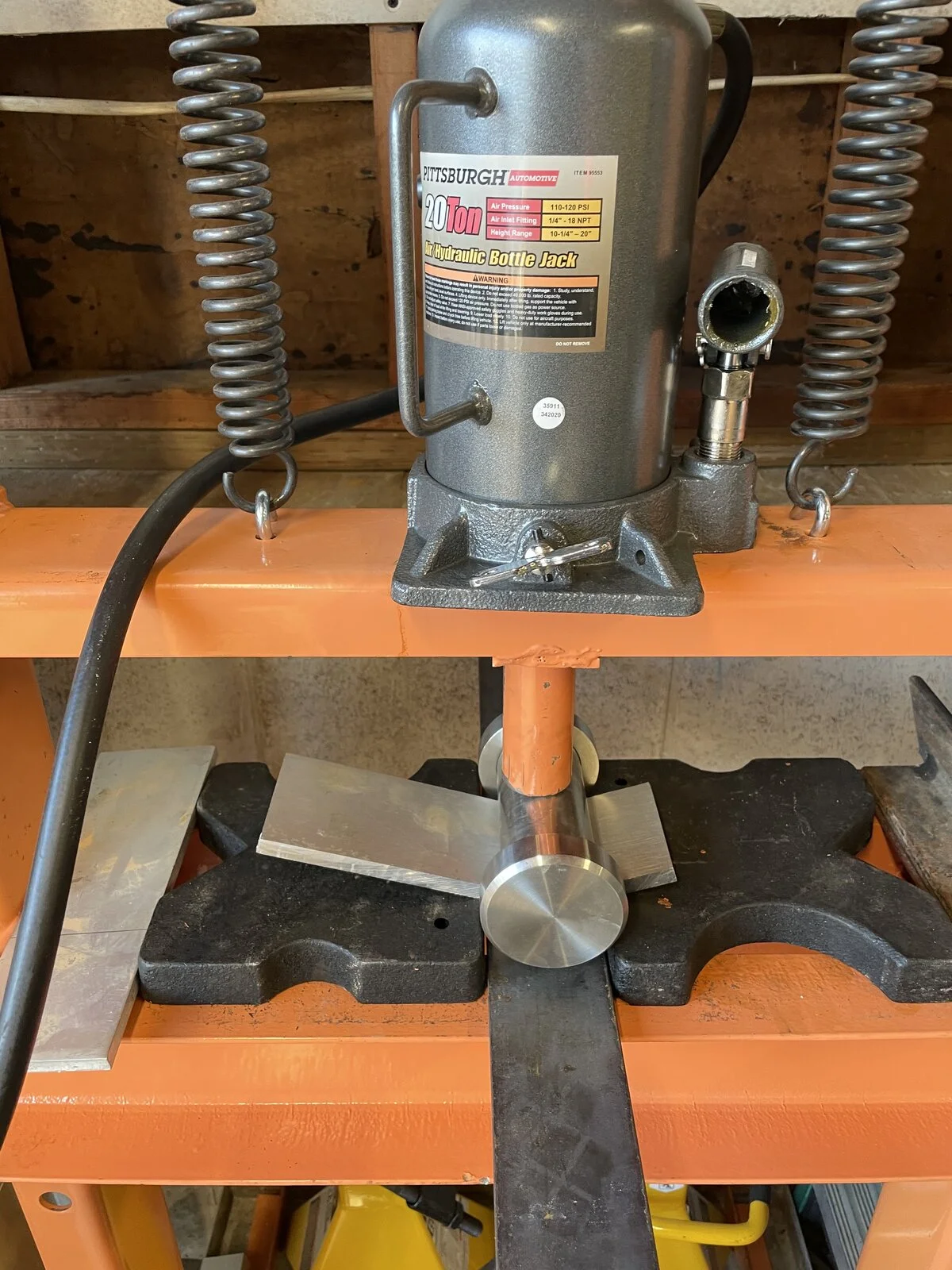

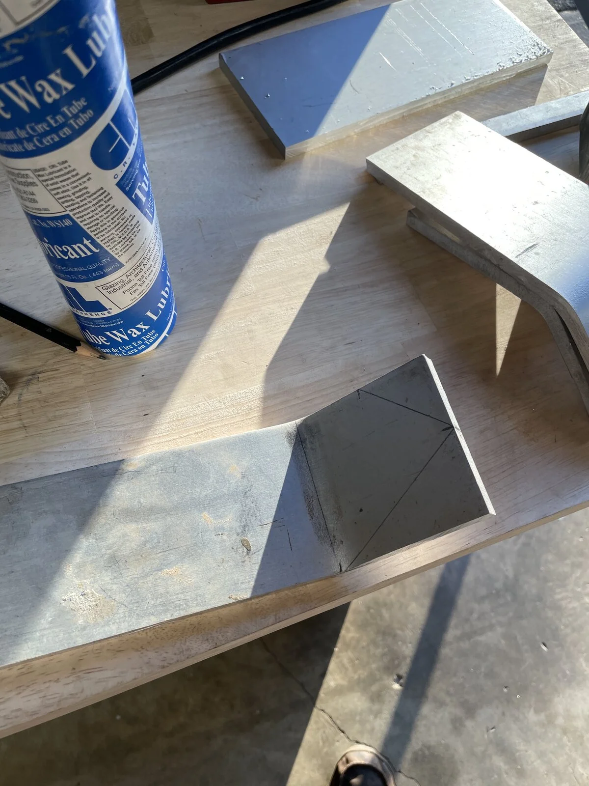

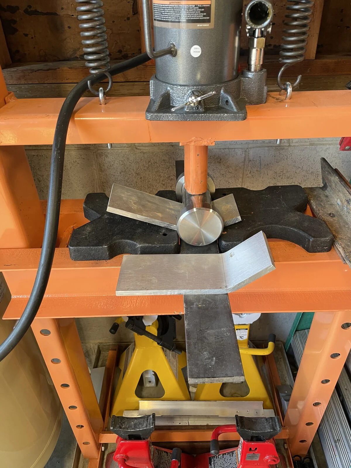

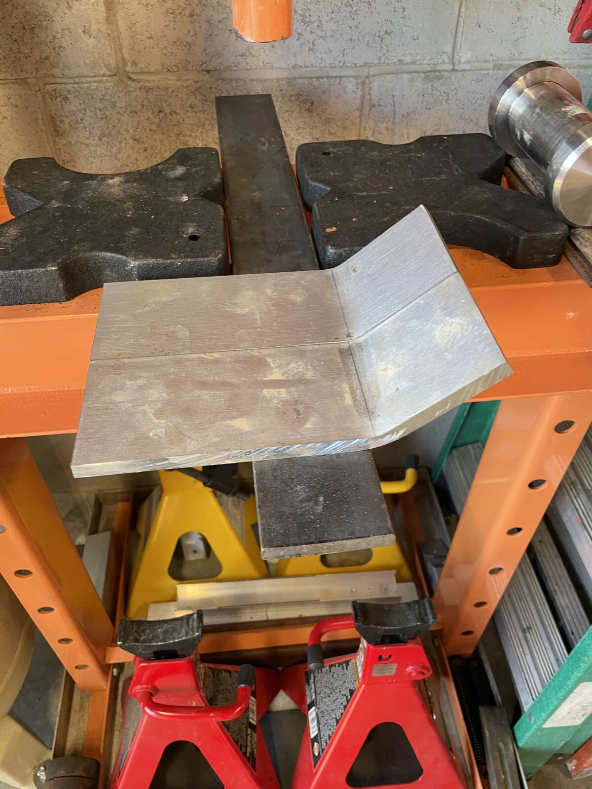

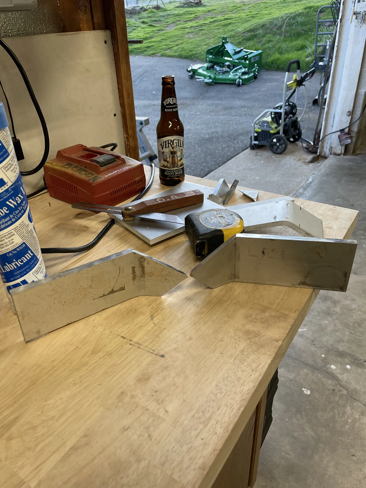

All this talk about bumpers has inspired me to make some bash plates for my GR bumper.
If you want to make that a tad bit easier, take a piece of plate and weld two pieces of 3/4 or 1" round bar to it for a quick and easy lower die. Even heavy wall tube will work.
edit- if you want to keep the scuffs on the outside less noticeable, lay a piece of old t-shirt across the lower die.
That’s a great idea, got just the scraps of plate and pipe to do it with too.
