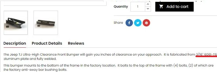

I have the UCF aluminum bumper which claims to be 6061-T6.

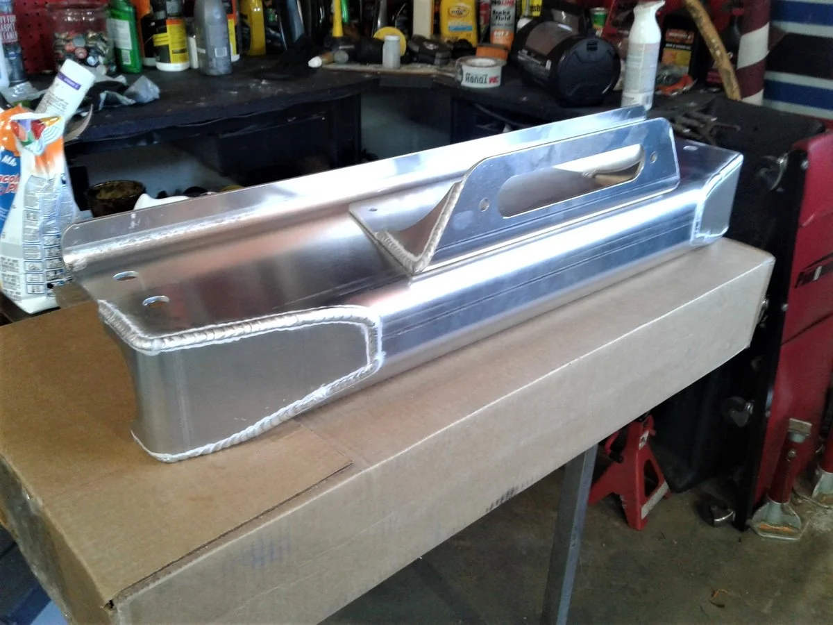

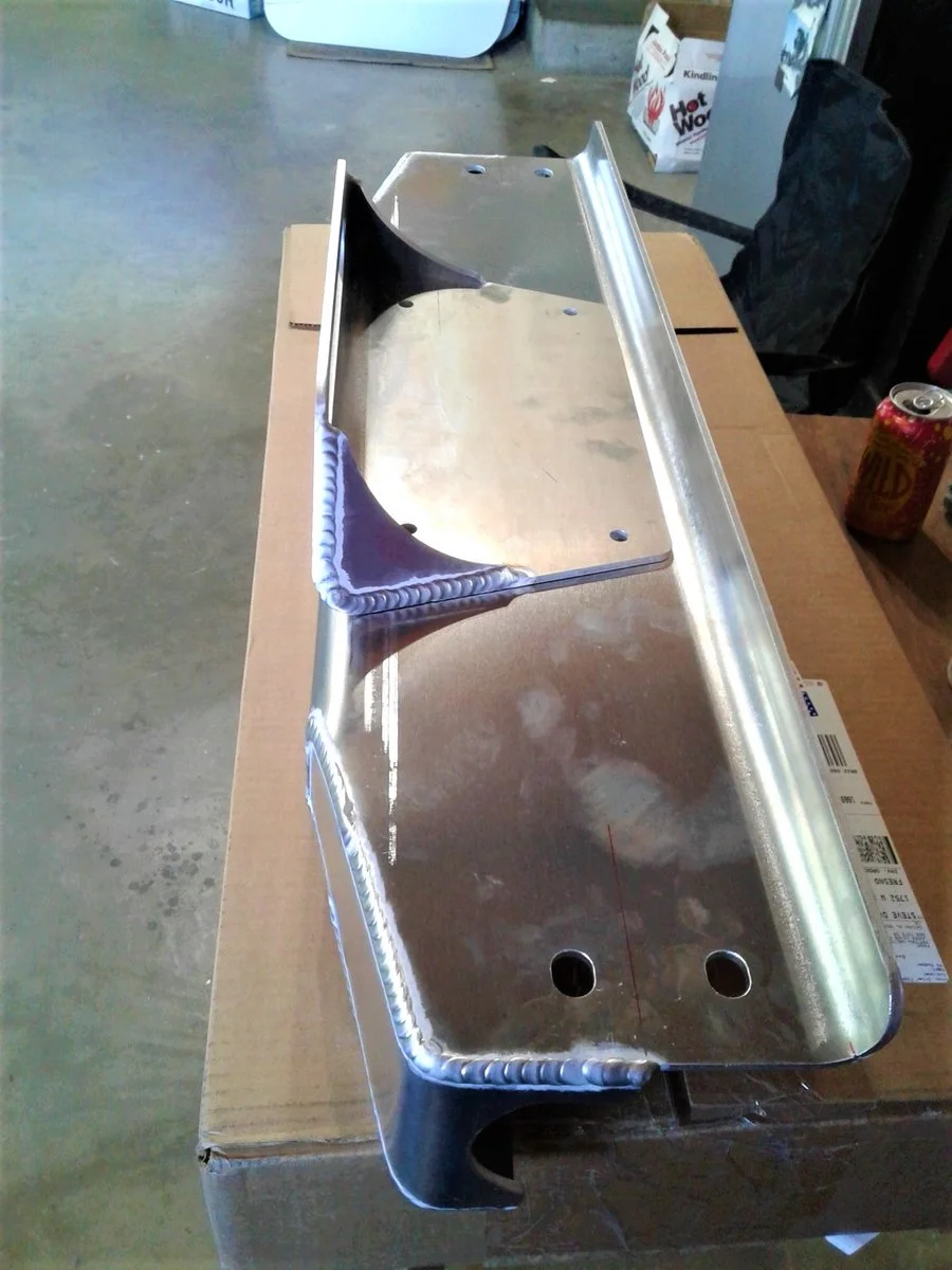

@mrblaine, this question is purely for my own education and anyone else who might be interested since we are on topic..
I don't make any claims to its strength, however it works well for my purposes. (Haven't dropped it on a rock yet).
What is your opinion on the bend radii of this bumper?
Is it legit, or possibly incorrect?
Give it to me straight... I can take it...
Those are at the minimum bend radius for 6061 T6. The only problem is it suffers from the same issues as the Savvy. Where it is welded drops the temper back to the -0 condition so those areas are not as strong.

Much rounder bends so possibly I’d say based on Blaine’s info.
The bend radius being that large does not make it 6061 T6 since that same radius can be used on the lesser strength alloys. All we can tell from the bends is what it isn't.
That doesn't mean it isn't 6061 T6. It just means we can't tell but the bends are appropriate for that material. If they were tight 90 degree bends then we know it isn't 6061 T6 but again, we don't know what it is, just what it isn't.
