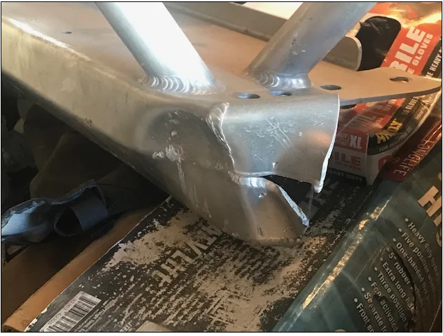

out of curiosity, can 6061-T6 be formed/bent/broke to a 90 with that small of a radius in the same thickness as a Savvy bumper?
No, not possible.
Nice looking bumper, especially in the raw finish, but it appears that it was built like a steel bumper. I would imagine I would see stress fractures on a close up.
Not in a 5000 series. You can bend up 5000 stuff like steel because it is softer.

Why do we have to keep doing this? 6061-T6 can not be bent in a tight 90 degree bend. It is impossible because it will break. Look at the bend at the front of your bumper, then look at the bend on the front of the Savvy. The Savvy has the tightest bend you can do in 6061 T6 and I know that because I stood in the shop helping the owner build dies and test them to see what was the tightest bend possible so we could design the bumper around those bends.
So you are saying GR is fraudulently claiming they use 6061 on their website? And that my eyes can’t read? Pretty arrogant of you to make both claims.
I don't believe it is fraudulent any more than I believe Savvy's claim of a 50 lb. weight for that front is fraudulent. I believe it is an overlooked mistake is all.
You do not have to take my word that is based on 20+ years of building stuff out of aluminum. The internet is full of ways to deal with 6061 T6 and what it can and can not do.
https://www.thefabricator.com/thefabricator/article/bending/strategies-for-bending-6061-t6-aluminum
Minimum bend radius is the the tightest bend you can put in a material without it breaking or suffering some ill effect. Note the chart below calls out 3t which is 3 x the thickness of the material being bent as the radius of the top punch and it has to be an air bend. That means the top punch has to be 3/4" in diameter to meet the min. bend radius which coincidentally happens to be the diameter of the punch used on the Savvy bumper. Wonder how that happened?
http://www.cumberlandmetals.com/aluminum/minimum-bend-radii/
If you need more, I can do it. I've been working with aluminum for a very long time and I know exactly what it takes to make parts out of it.

There are only so many ways to say the same thing. Your bumper is fine unless you plan to abuse it in the rocks. If you do, it will not survive as well as a bumper made from 6061-T6. There is no other way to say that and nothing you can say will make that untrue.
