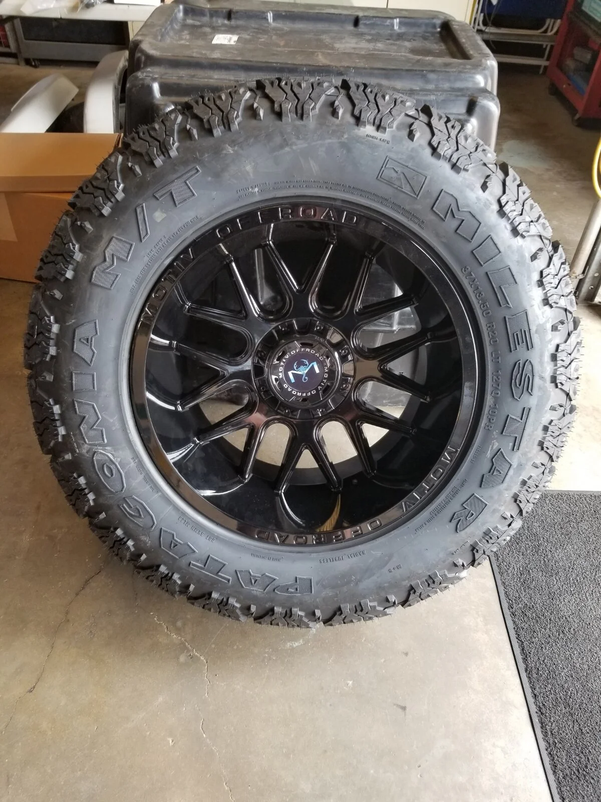

Aired up to 28 psi and total diameter is 36"`s dead on the money. 4.88 is the best oeverall choice for this build.

The 13.5" would be good if you're wheeling a lot and have the clearance all around for that wide of a tire. Plus your turning radius is going to suck being that wide. If you're not wheeling it much, you're better off with the 12.5" wide tires.
The 20" wheels: Fine because as previously stated, you're not wheeling much. Considered a mall crawler wheel, would get ruined with offroad use.
It just seems like a mismatch to have the 13.5" wide with 20" wheels. I get it though, it's all for looks, not for function.
Reactions: Steel City 06
Don't forget, they're 20x12 wheels. Most of us run 8" wide wheels...
13.5 might actually be more appropriate for those wheels than 12.5.
