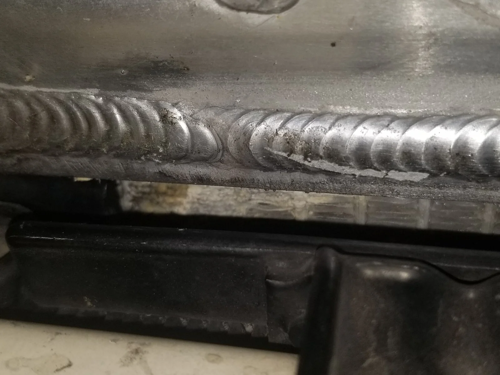

For what? I love the radiator I have in my Jeep. Not my first time using one. Do you even know what the benefit is to using one of their single "big tube" radiators or even how a radiator works? Hurry now fan boy, go do some google research so you can reply. Lmao, phucin dork
If Google were effective at disseminating correct information, there is no possible way you could be this wrong for so long...
I have several rigs I take care of. I know of more than a few that are on their 2nd and 3rd Griffin radiators that failed in far less time than even the used OEM versions I have swapped in.
My experience is very similar. Got talked in to a Griffin, started leaking. Repaired by a local shop, started leaking again in a different area, got a warranty replacement which I sold nib and went back to Mopar. Mopar has yet to leak 12 years later.
My brother also had a Griffin in his TJ go bad, replaced under warranty.
Reactions: mushdogs and L J
Did they try to tell you that the reason they failed is the grill shell flexes too much?
