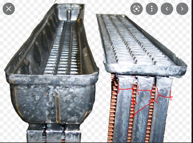

Not even close. The reason a large single row tube works more efficiently in the same core depth is the interstices between the rows of tubes reduce the amount of contact with the fins. Assuming that the same fin density is employed, a single row full depth in the core will always work better than a 2 row. There is far more to it than exposed surface to the air flow.
Wrong ther contact "patch" of the fin to tube is the heat transfer point. Period. REDUCE that patch you reduce thermo transfer. I may be loaded reading this or your off out there bro

Stop already. You can't fix your lack of understanding or Griffin's shit radiators that have already been posted up. If that was your position, you should have stated from the start that Griffin is a shit company that builds two radiators trying to catch the ignorant thinking they are getting a good NAME unit. Besides, none of the folks I deal with are price shoppers.
You aren't making yourself look good. Read what you replied to again, slowly this time. In the same core depth and we'll use a 1" version as an example or one that is maxed out with a 1" wide tube. The tube to fin contact at each tube is just a smidge less than one inch due to how the tube is shaped.
If the below were the same core depth, it would have less tube to fin contact due to the spaces between the tubes. That's is why in general in the same core depth, a row of wider tubes is more efficient than a multi row.
I've never thought of it this way but it makes perfect sense the way you explained it here. Thanks for that Blaine.
That's one aspect that affects efficiency. The obvious leap is to use the fact that wider tubes are better so why not two rows of them in the same core assuming it will fit, or even 3? The thicker the core depth, the harder it is to move air through it. There is a balance between depth and fin count. Higher efficiency depends on getting air through with the highest fin count. Get the fin count too high and you slow down how much air can get through the core.
Thick wall tubes are more robust and last longer. In aluminum or copper for that matter, that slows down heat transfer from the coolant moving through them. Thinner tube walls are more efficient but don't last as long.
