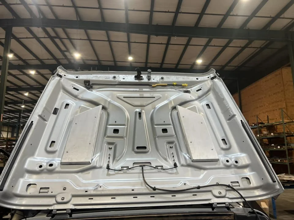

For those who are worried about water getting on the engine from installing the hood vents the Motobilt version has drip trays similar to what was installed on the 1998 Grand Cherokee.
I know this is a JL hood but the drip pans are basically the same.

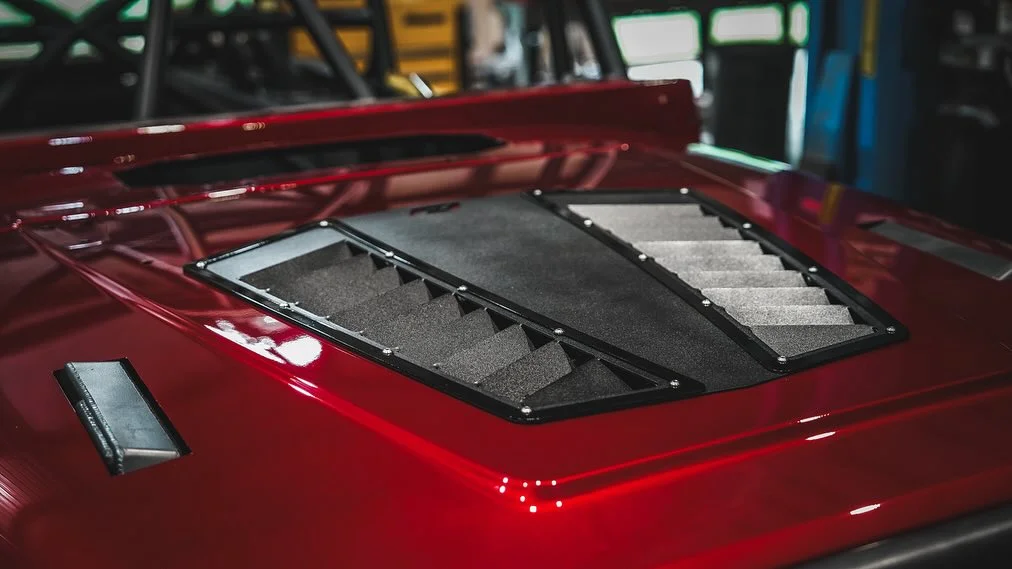

I'd like to put in some hood vents, but what with all the rain we get here, I'd like to put them in the side of the hood. Maybe Buick port holes or something.
Genright used to sell some longer vents that weren't as wide but I looked and they don't seem to have them listed anymore on their website. But these are very similar to them
https://hoodlouvers.com/shop/side-l...IlisXduliE-nTFs4OhQj8-KY7YFYSxtEaAmdqEALw_wcB
