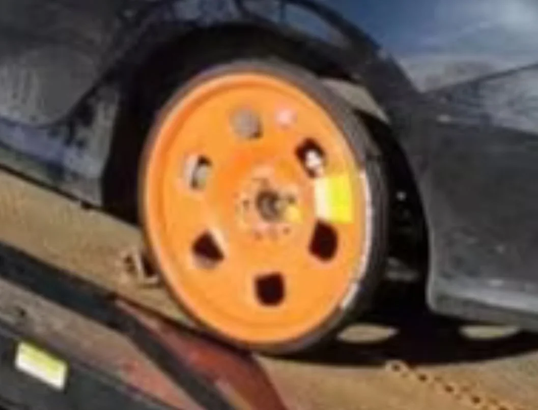

They're universal wheels for towing and recovery. One feature is they freewheel independent of the axle...so if the vehicle's running gear are locked up you can still roll it on to a trailer, rollback or something.

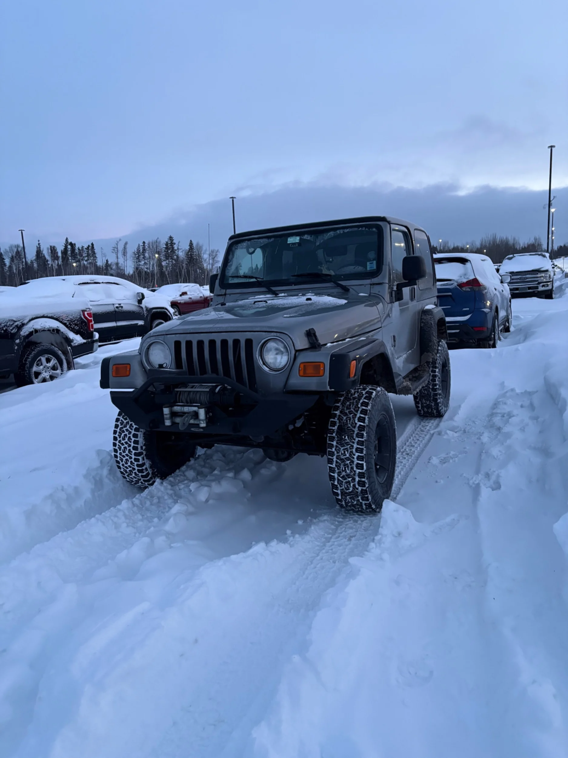

I have 33" pizza cutters on my daily, they're pretty great in the snow and rain. But my jeep has the fatties and needs a diet 😅

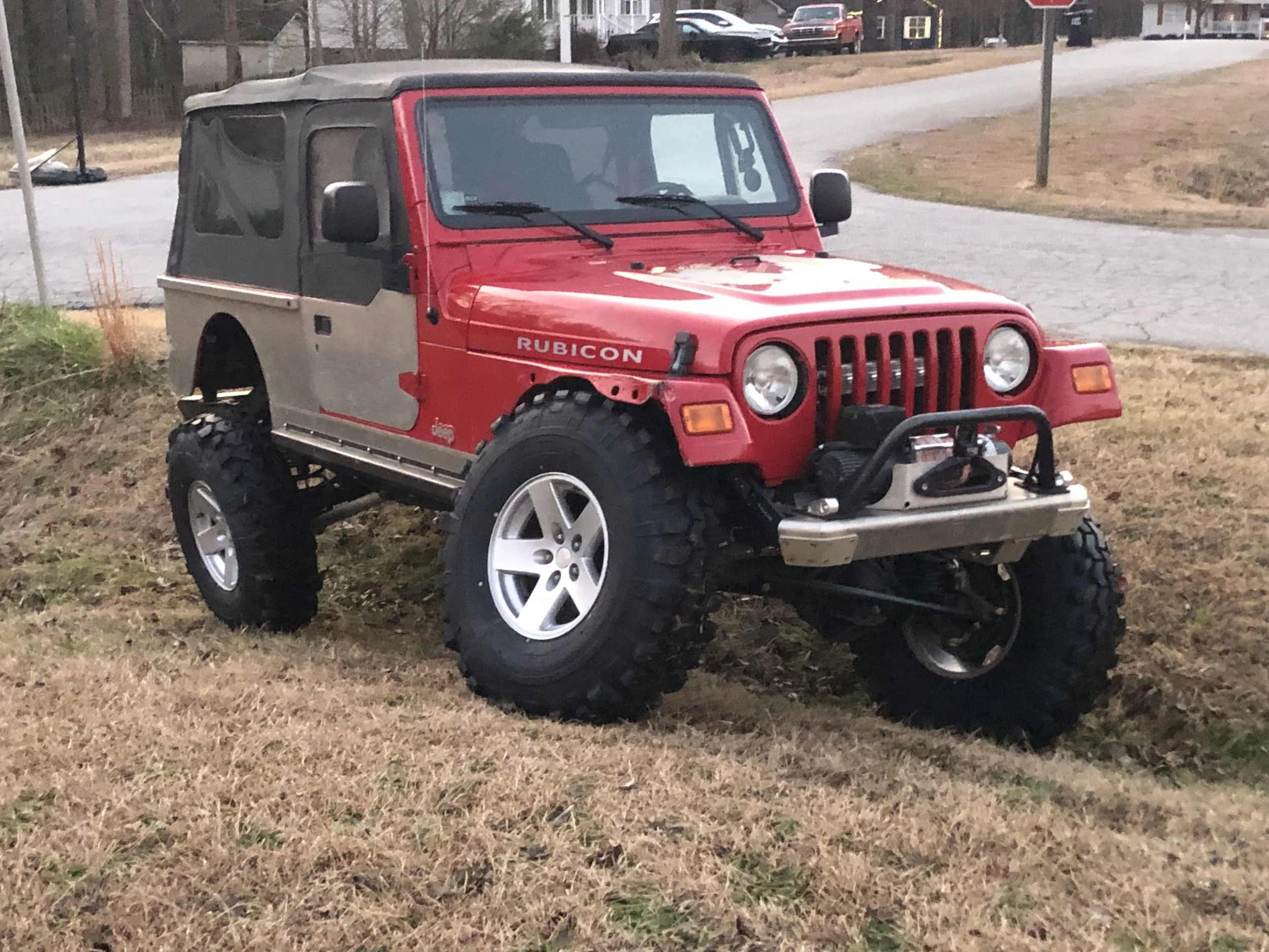

Here’s my LJ with a 1.25” body lift and 3.25” suspension. 2” bumpstops front and rear. 11” of travel.
Skinny tires help keep the weight down which helps acceleration. they seem to track straighter down the highway and off road they seem to hook up very well on the east coast.

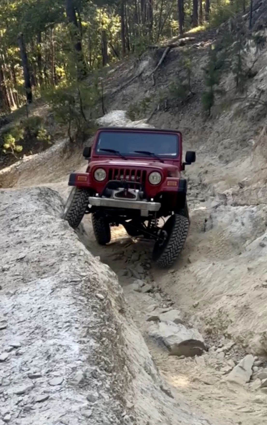

Toyo 255/85r16 33.5” tall 60lbs on Moabs with 1.25” spacers. Setup for full lock turns at full articulation. I am a big fan of toyos in this size. Quiet and smooth compared to most mud tires. Been on this size since 2013 and driven 40k miles on them. Very daily driven and highway friendly. Ran 28 psi on the street, 10-15 psi offroad.

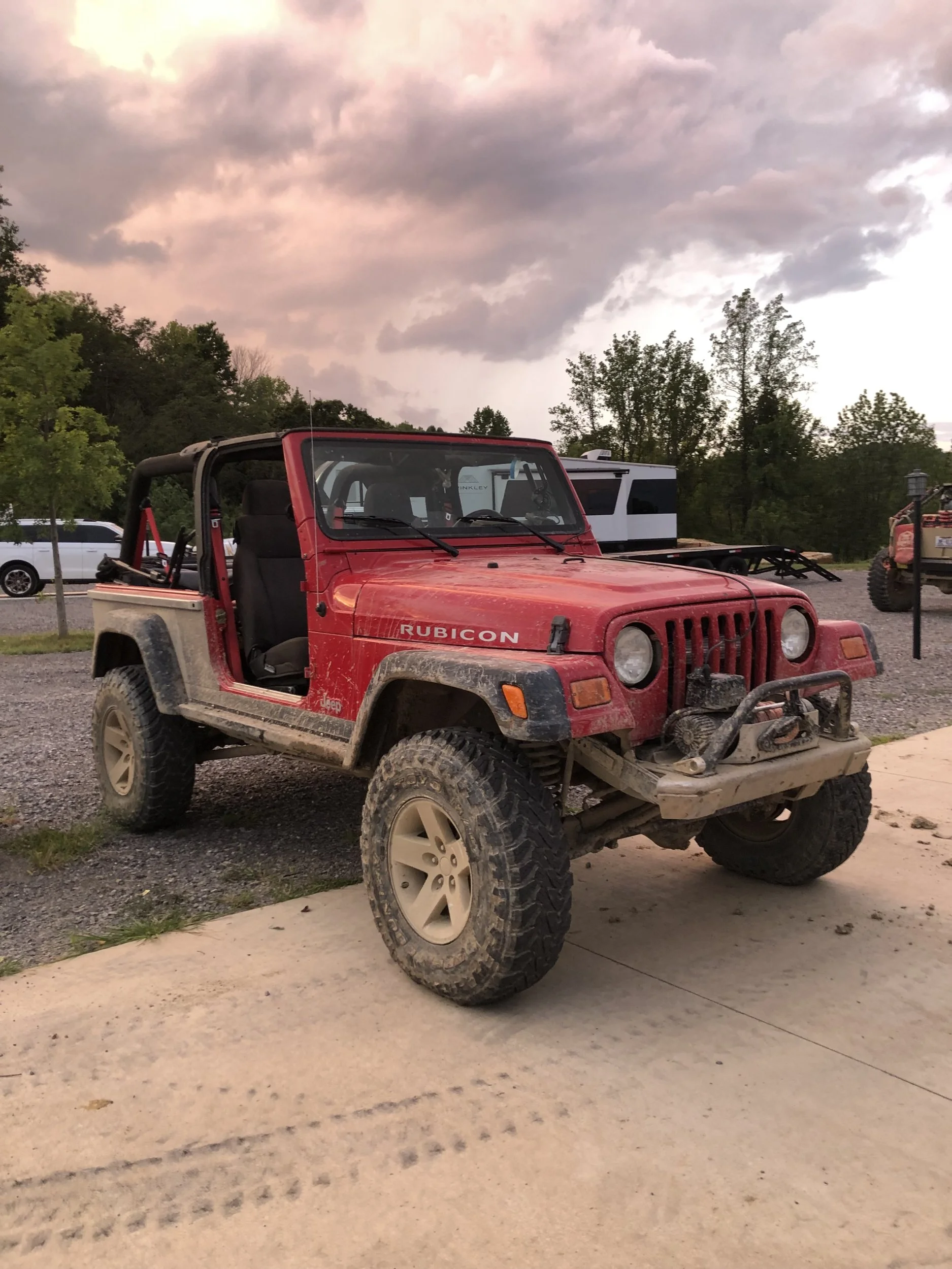

Trying out some Q78-16 load range c bias ply 35.5” tall, 65 lbs. grabbed a set of 06 rims too (slightly lighter)
Gained 1.5” of ground clearance. I need an inch or so added to the front and rear bump stop or some high lines in the front. Might need to go to 1.5” wheel spacers from the current 1.25” spacers.
First impressions: Much noisier compared to the Toyos. These don’t feel heavy, acceleration is still good even with the factory 4.10s.

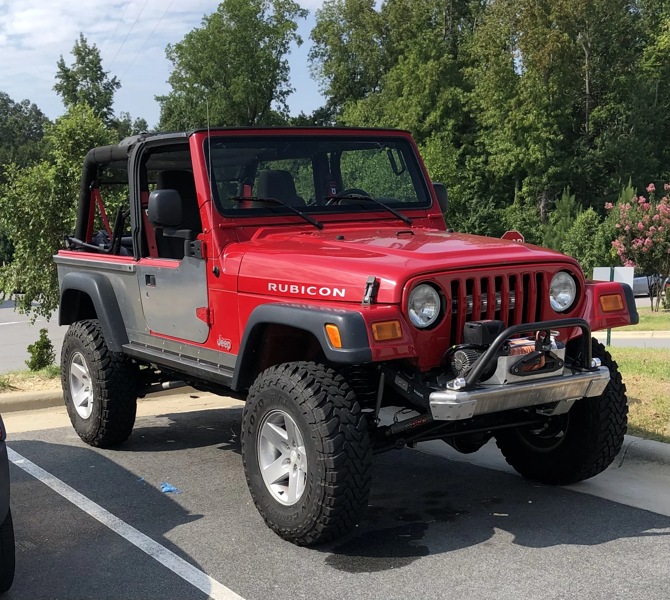

@Steeprocker I'm impressed those swampers stuff pretty good. I was looking at getting some 35x11.50 17 RT pros or 285x75 17 geolanders with basically the same lift 3.5" and 1" body.
