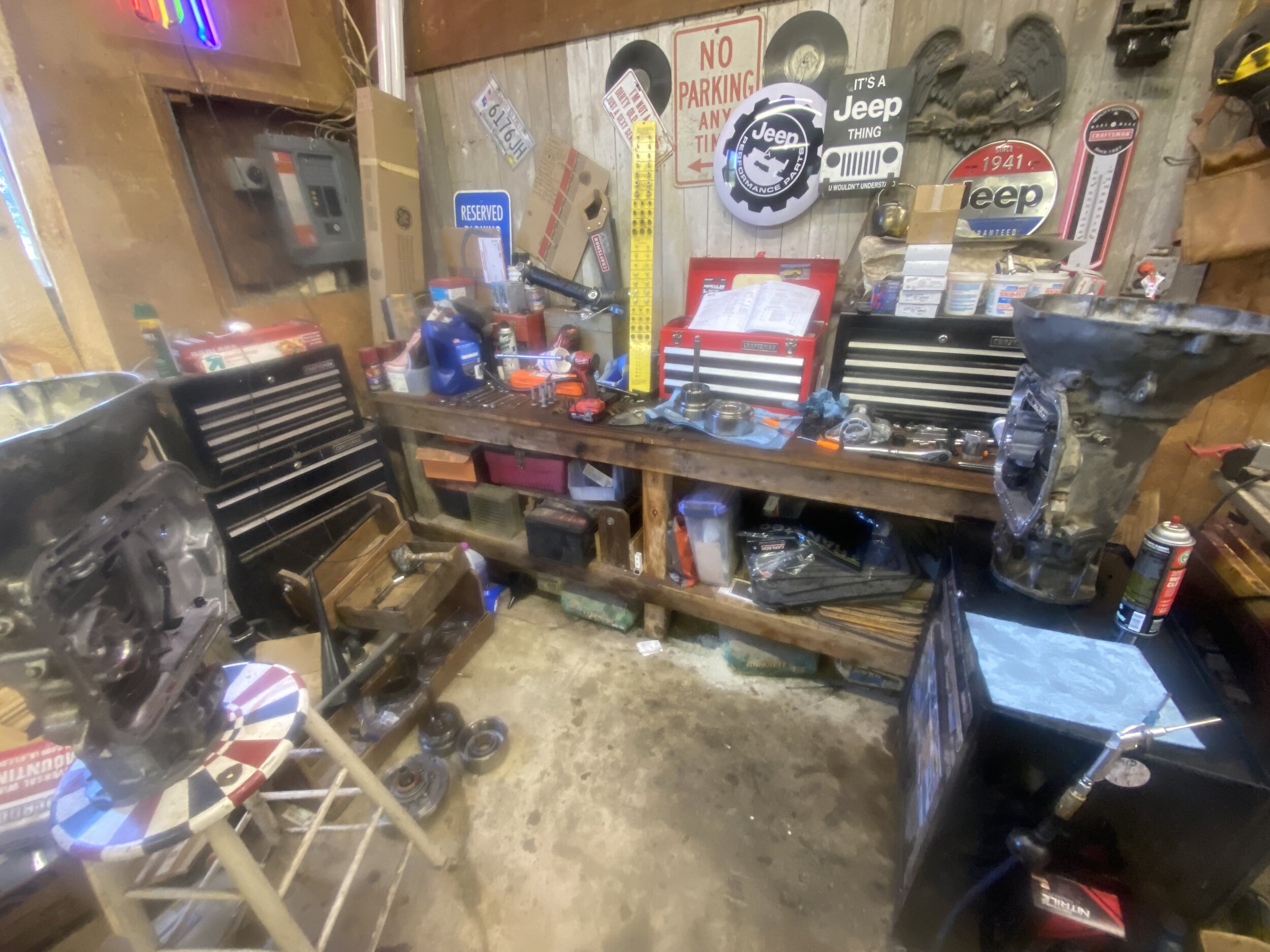

I decided to put some stuff from the unit I tried to rebuild into the old one, and I’ve got the clutches in (fixed the backwards thrust washers under the rear drum and triple checked the clutch plate clearances). Gonna pop the pump back in and adjust the bands, then I can put the valve body back and button it up to put back in.
If it doesn’t work, you can always swap the old/untouched valve body back in and see if anything changes. Less effort than pulling a transmission!
Reactions: lBasket

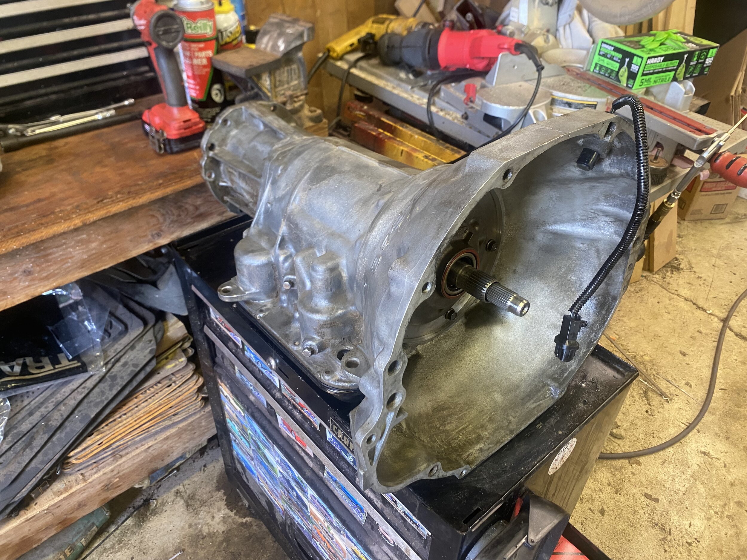

I ended up hybridizing the two transmissions. Old transmission, untouched from the annularies down, with the untouched old valve body and pump. I swapped out the burn clutches for the fresh ones from the rebuild, made sure the thrust washers were good, moved over a bunch of case and electrical connections, and buttoned it up with the pan swapped over from the rebuild and another new pan gasket. Input shaft spins fine, I made sure that the park rod actually engaged when I put it back in, and made sure it passed all the air tests. I think I had jumbled the snap rings and forgotten to check clearances in the clutch plates and that was part of the issue with the rebuild. I will see how it drives with the "old" one in there with what is essentially a partial rebuild and a new TC, and figure out a plan moving forward from there. If all the old problems are fixed, a full rebuild swap might prove unnecessary, but that remains to be seen. Fingers crossed, again.
Buttoned her up, topped her off… and park worked, every other gear was just drive. I figured it was the manual valve, so I dropped the skid plate, and the pan, and lo and behold, it was. Got the linkages fixed in the pan, buttoned her up, and road tested her. She works! Smoother shifts than before, no weird double up shift into three from two, I’ve got all gears, and no weird noises as far as I can tell. Time will tell if I need to pull the dipstick to RTV the grommet, and I’ll probably need to slightly adjust the throttle valve cable, and the shifter currently displays the wrong gear on the lever indicator, but I’m not looking this transmission horse in the mouth. Success! I think.
That’s fantastic! You basically did the full rebuild if you got as deep as both clutch packs. Still wondering what was the deal with the first one though.
