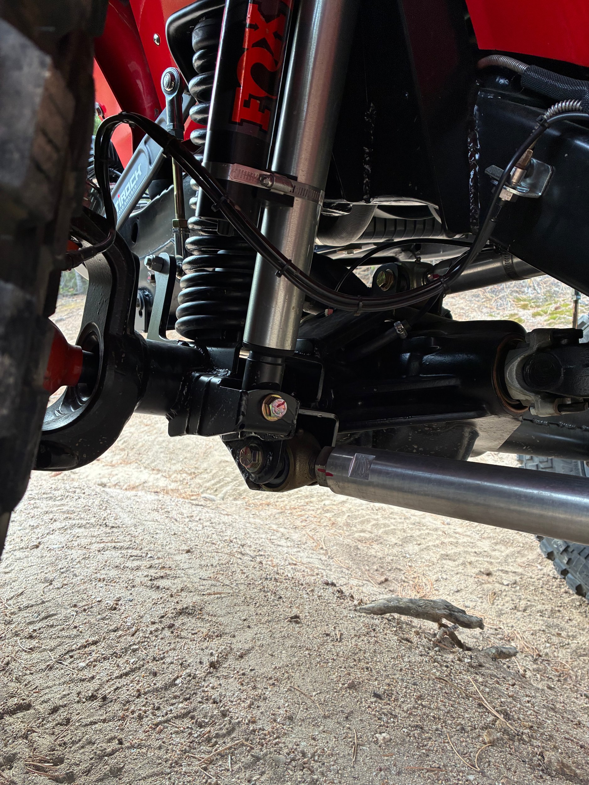

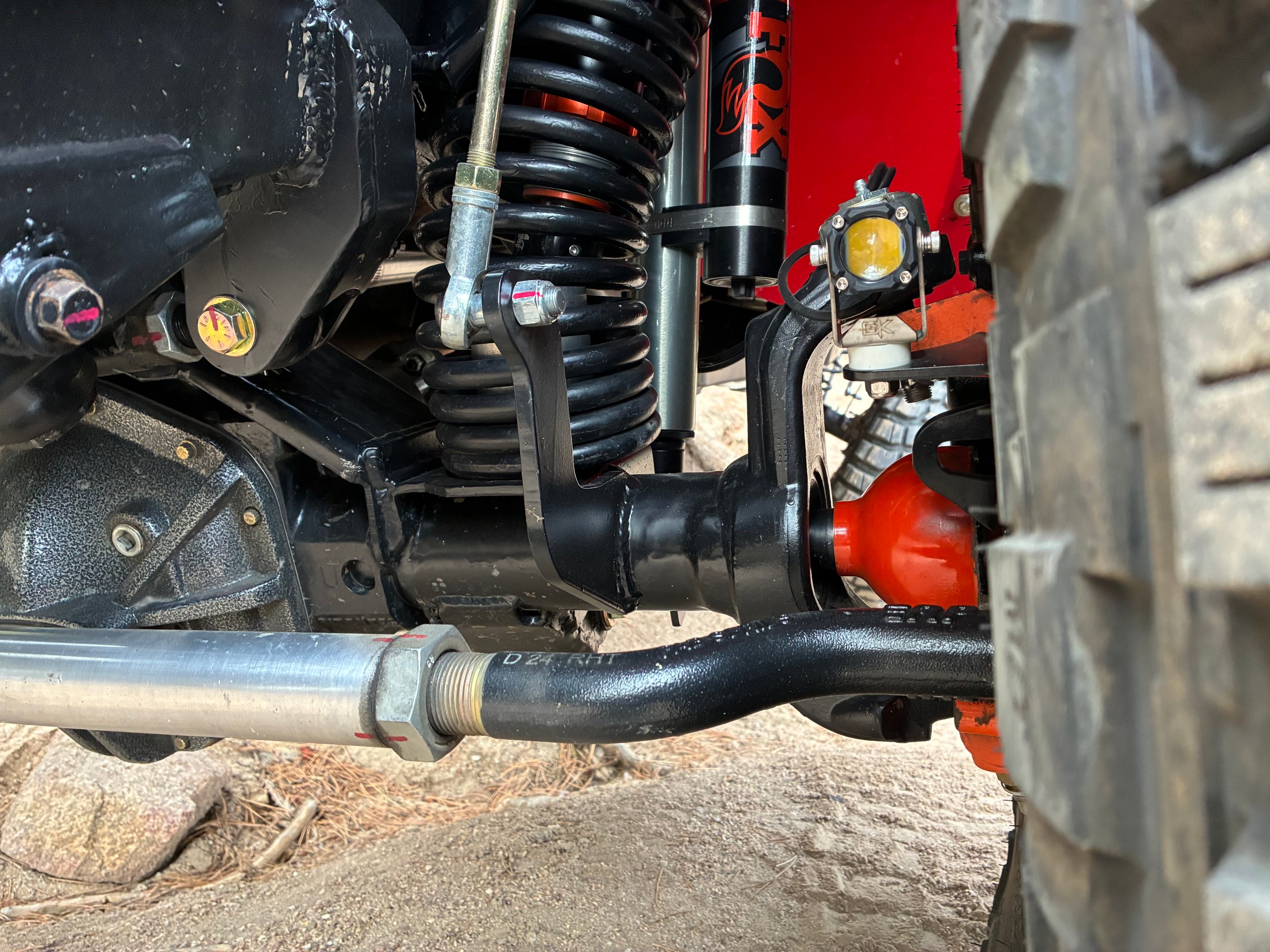

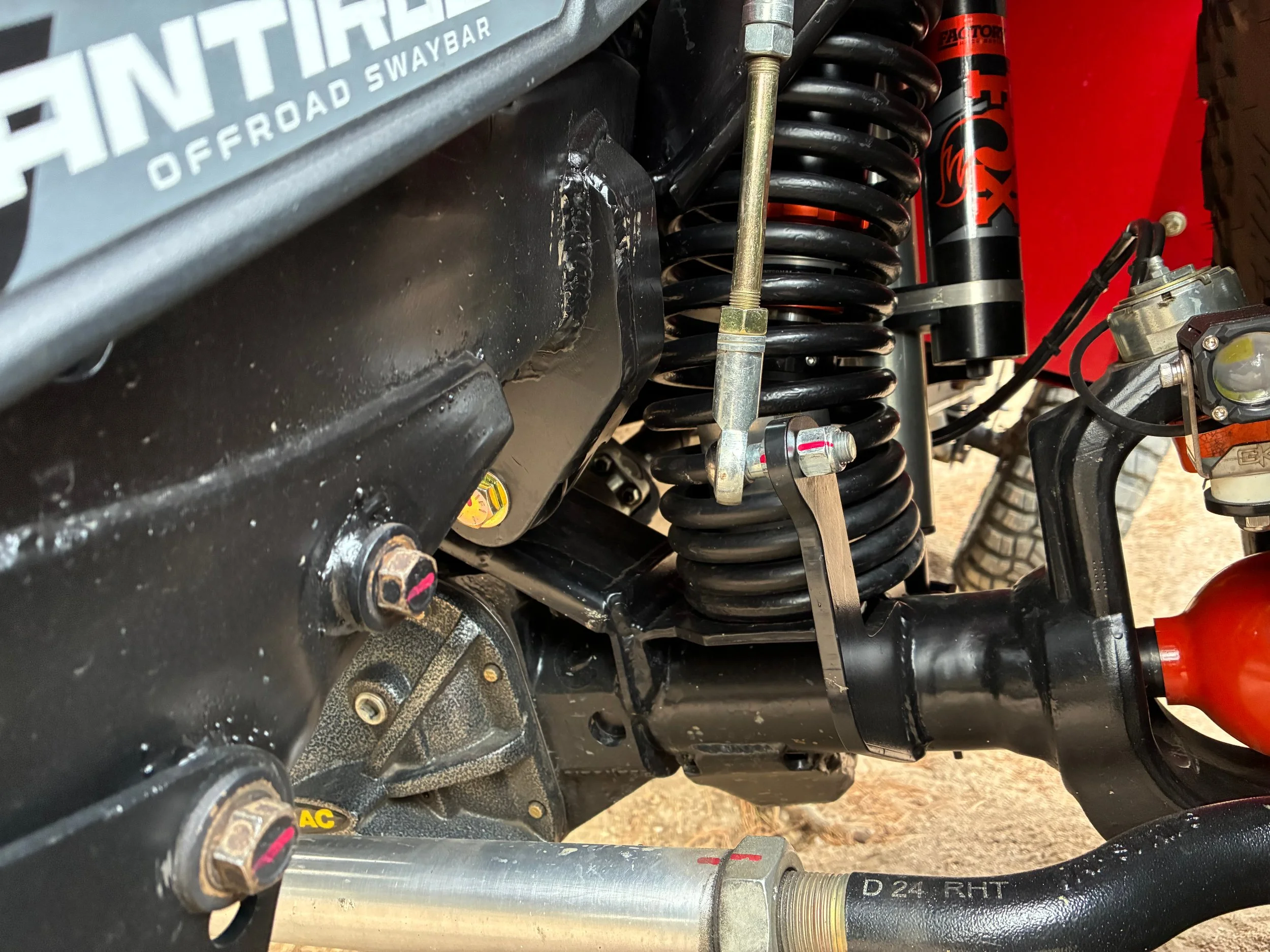

After 5 or 6 trips under the TJ's belt, I think it is time to pull it back in and give everything a once over. I noticed the Rare Parts cartridge at the pitman arm had started to work loose.

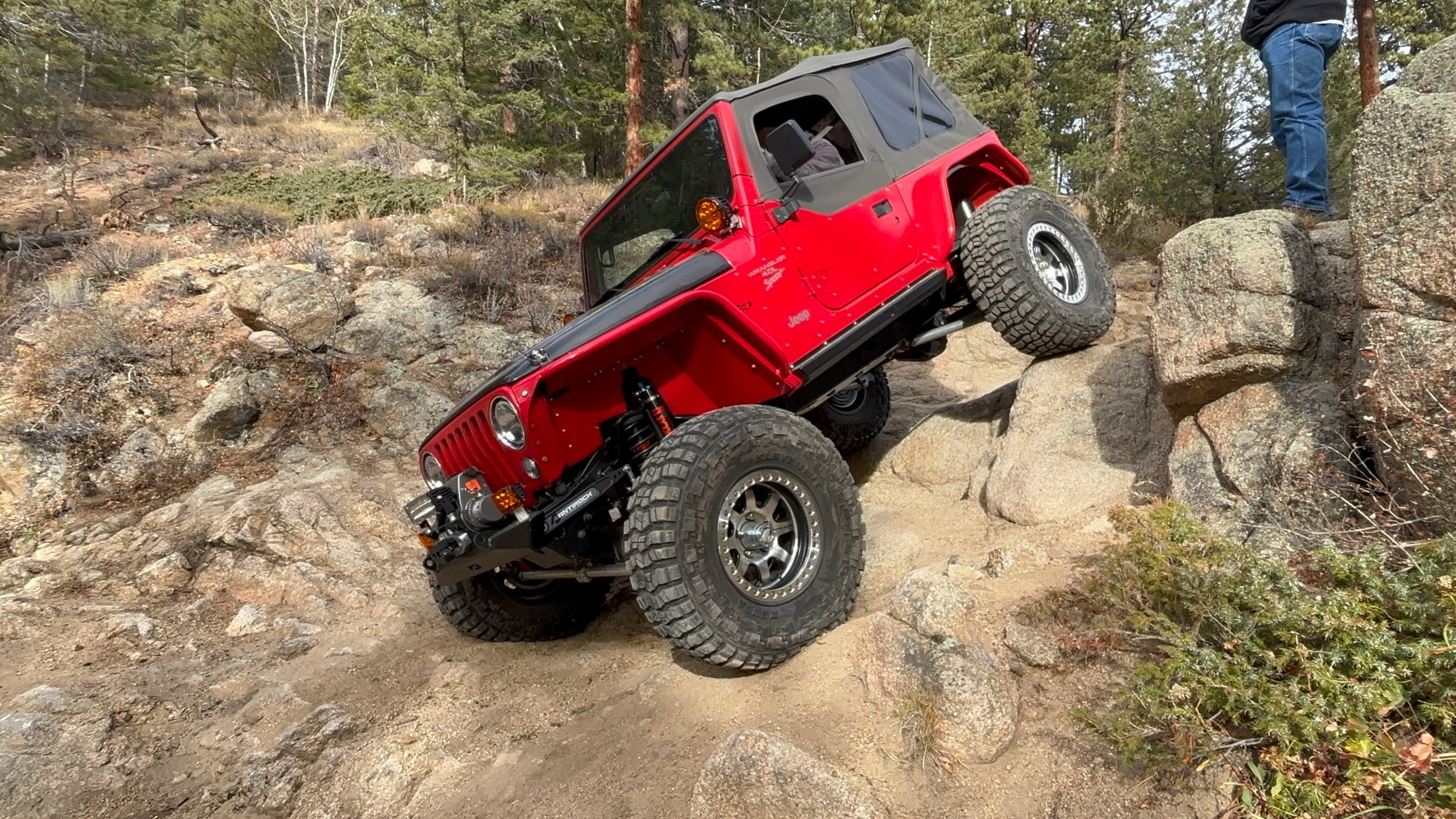

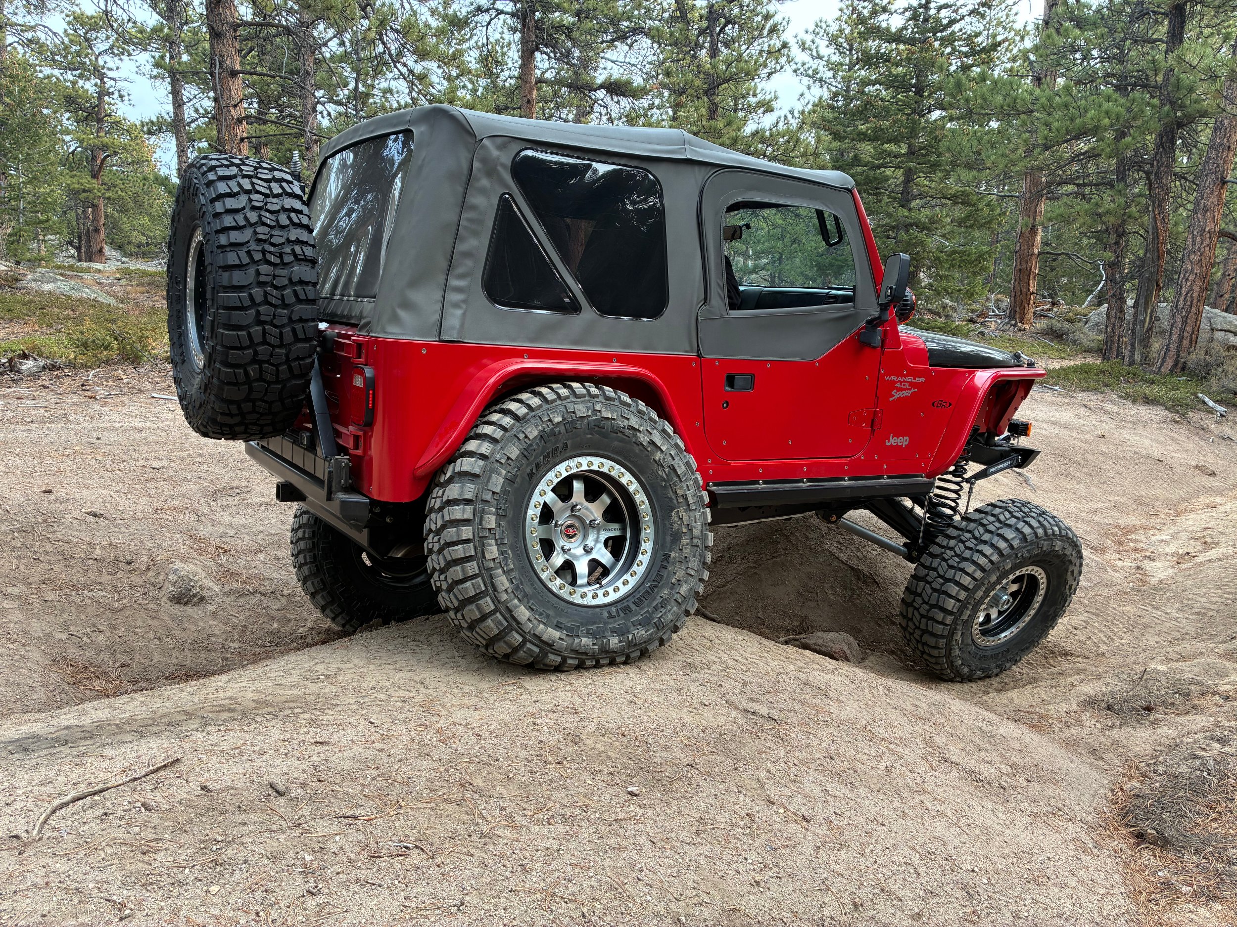

Ironclads playground.
Testing out flex and bump on natural terrain (Miller Rock).
