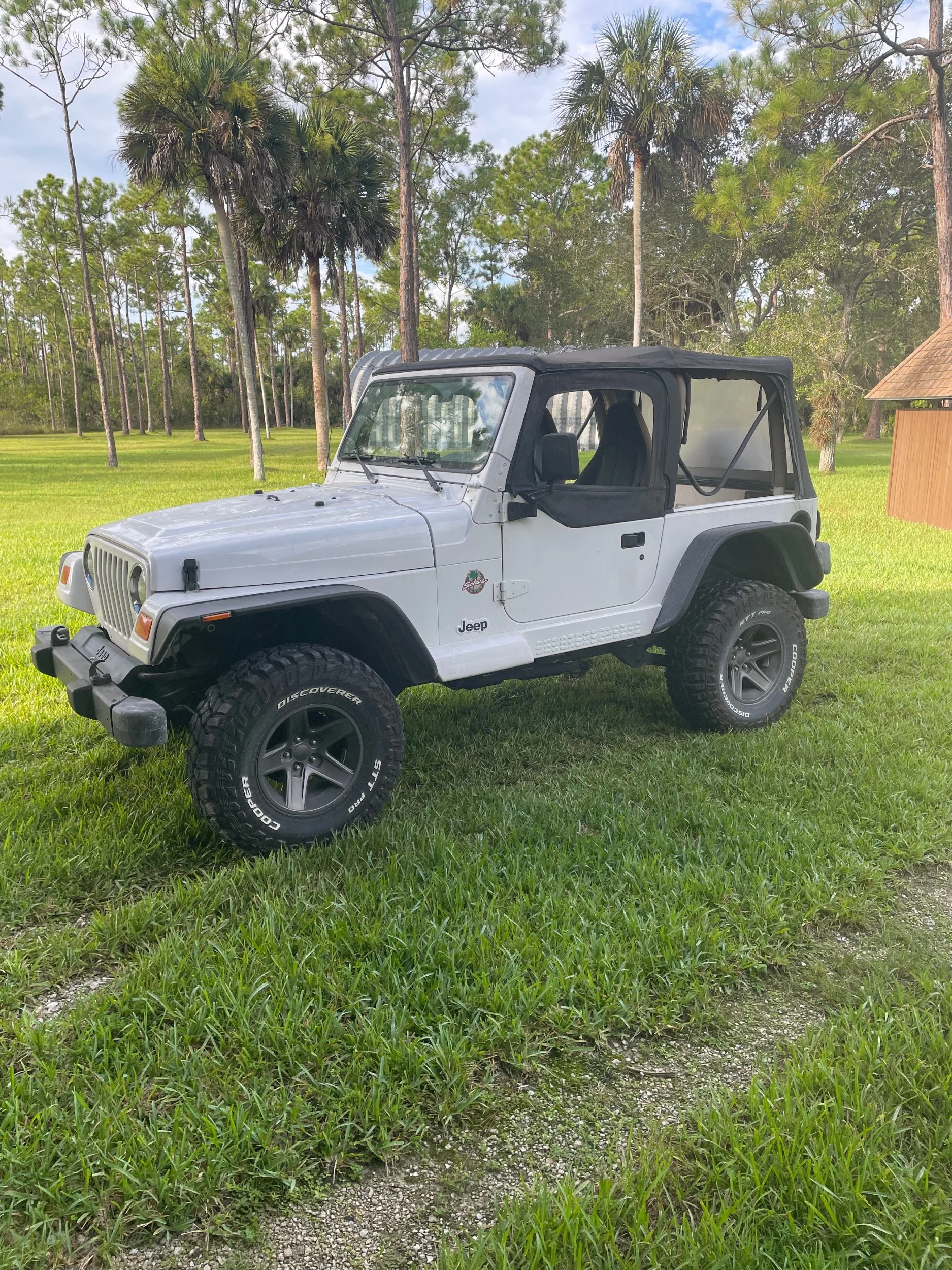

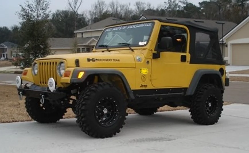

Split the difference, my 2001 Sahara,dana 44 with 3.73 gears. 32 x 11.50 x15. Two inch spring lift, one inch body and motor mount lift. Even with 32's fifth gear is too high. 60 mph in fourth is 2500 rpm, in fifth 2100 rpm.
Split the difference, my 2001 Sahara,dana 44 with 3.73 gears. 32 x 11.50 x15. Two inch spring lift, one inch body and motor mount lift. Even with 32's fifth gear is too high. 60 mph in fourth is 2500 rpm, in fifth 2100 rpm.View attachment 674383

Common size, jeep performs great with them. Just don't use fifth gear even in flat SW FL were I live.

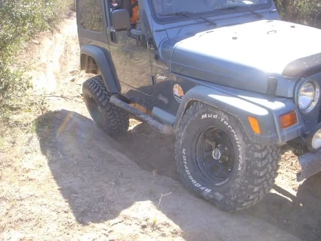

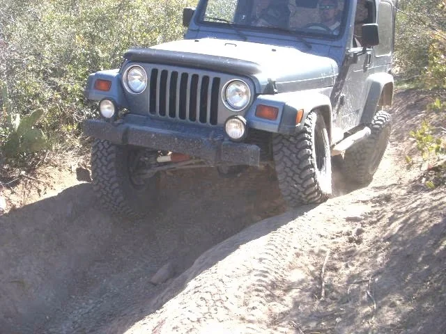

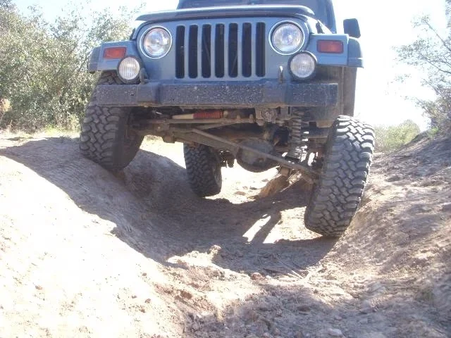

I have no issues with 32s, 3.73s and AX15 here in Arizona. Sure, downshifting on uphill grades is required, but on flat Interstate no problem using 5th at 60-70 MPH. I do it all the time back and forth to work on I-10.

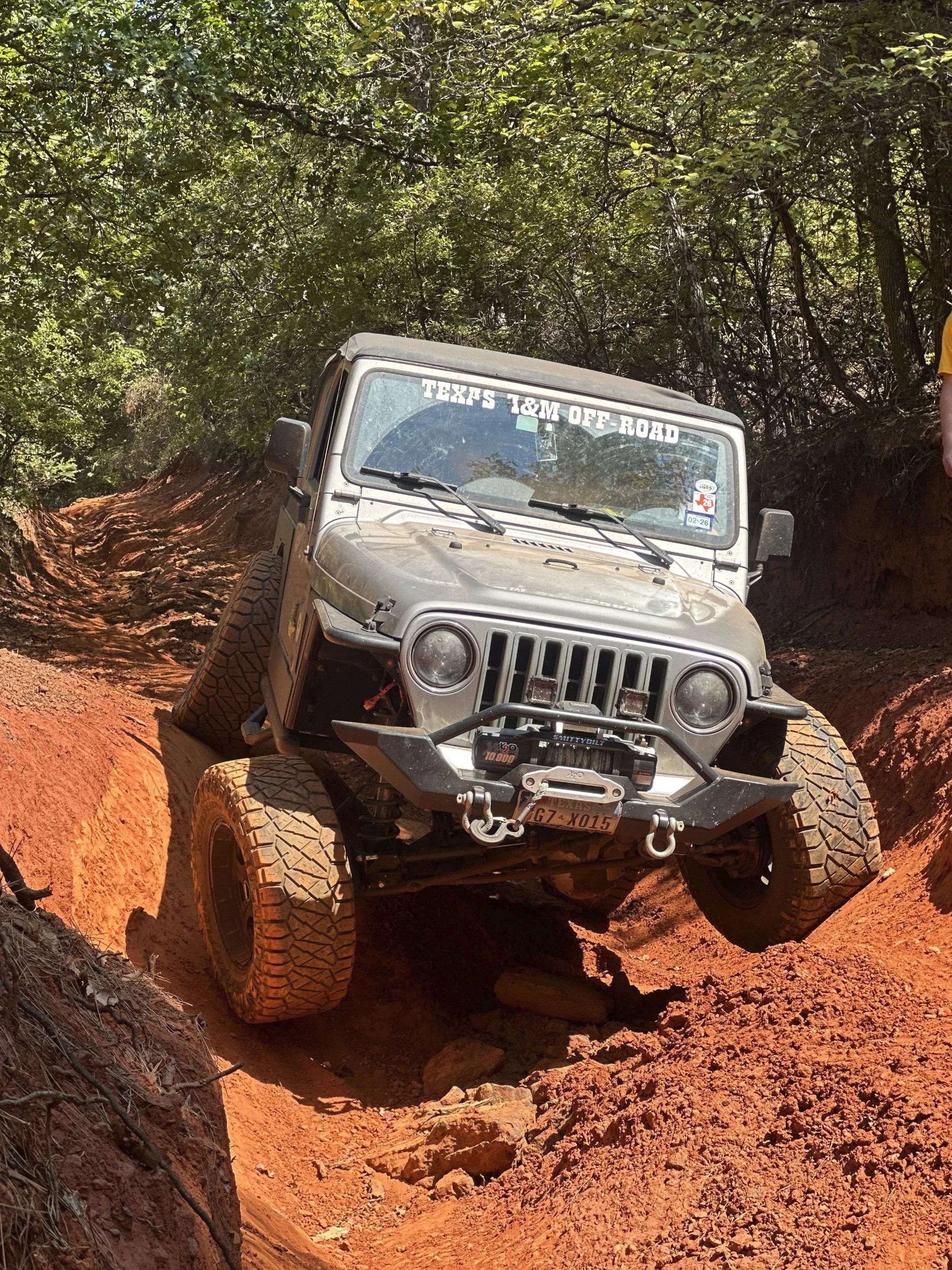

I ran 33's on 3.07's with a 3" lift for years before I finally figured out what regearing was (took me long enough). I used this set up for a very long time and it kinda worked, just involved a lot more skinny peddle than I liked. Daily driving was also not great as I never left 4th gear and hills were an absolute pain. Flex wise I was normally completely fine until I reached the obstacle in this picture. The tire was pressed so far into my fenders that it looked like it was flat (E rated side walls at around 12 psi) and I couldn't turn at all. Most flexed out I've ever been and have since gone up another inch in suspension.

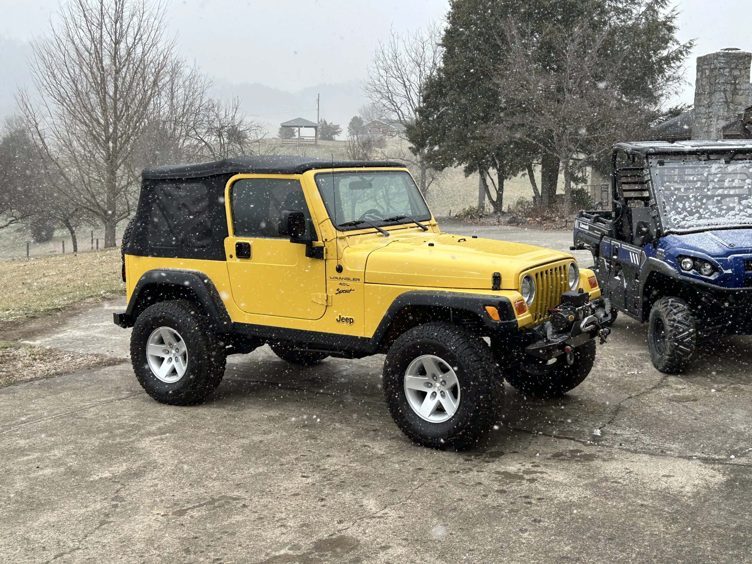

Your jeep should have 373 gears, look at the tag on your diff covers for confirmation. I run 33 11.50s on my jeep with 2.5 inch lift springs, flexes out just fine. Might need to extend my bump stops slightly but it’s nothing major, just when turned.
