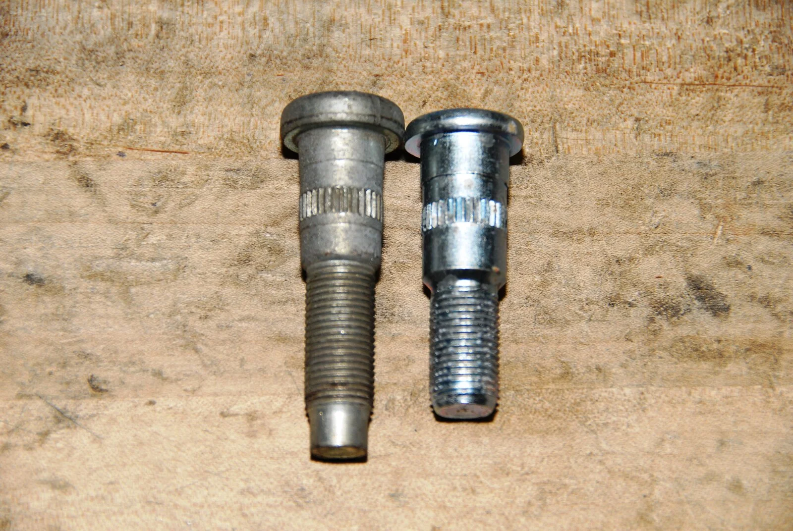

The problem is as I stated, that style lug stud does not have any options that give you more thread.
Here is the ones Yukon sends out next to the old one that Warn used to send out. Note the distance from under the head to the end of the threads.

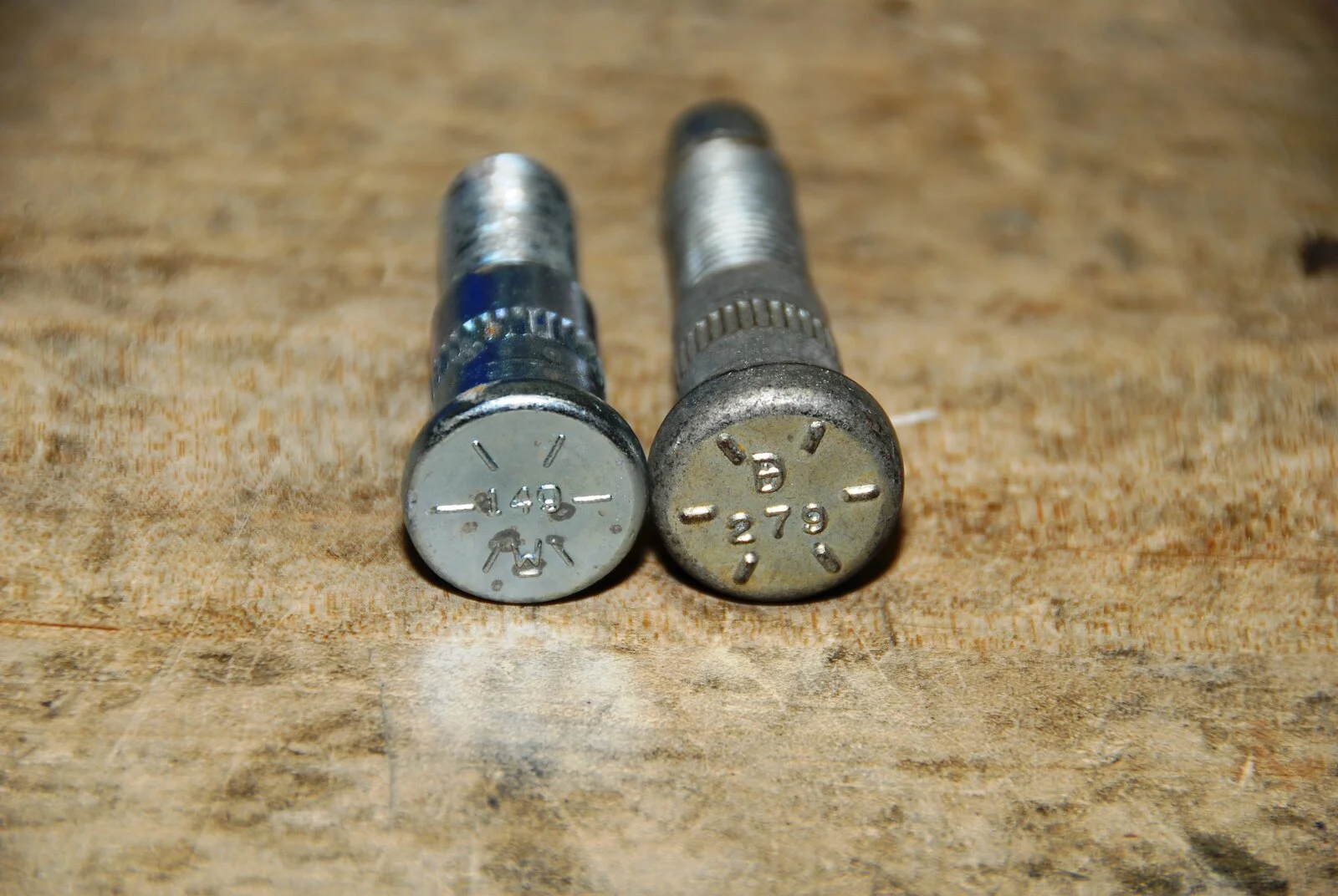

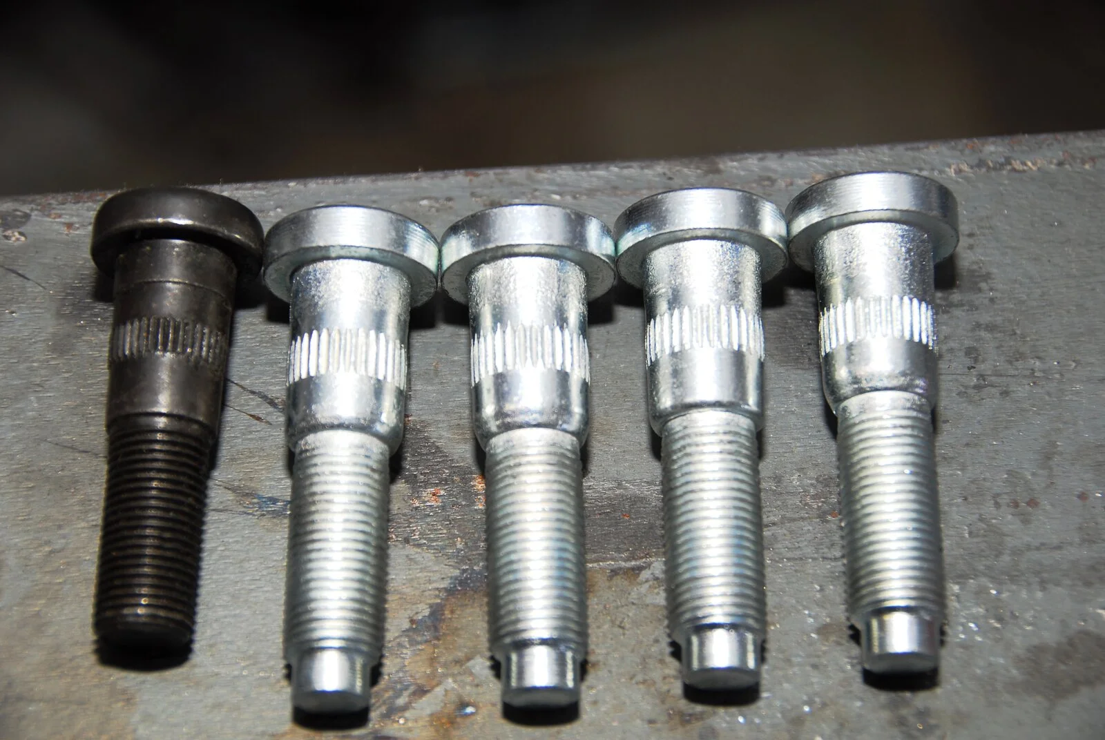

Another comparison shot of the two more common studs used in the conversions and that style behind the flange rotor mount.
I believe there is one that is slightly longer, a 180 IIRC. I think I checked and one of the holes was already too large for it. I'll check again and if anyone knows of a stud like that which has more thread, I'll really be liking to know the number.
The best option is to say screw it, pun intended, and dispense with those crap press in studs. Go to a new pattern of 1/2-20 threaded holes halfway between each and then drill the rotor with a 1/2" clearance hole. After that, use the screw in wheel studs like aftermarket rear axles have. We've done several that way when the owners have rims with really thick mounting surfaces in the lug nut holes. Those studs are available up to 3" long.

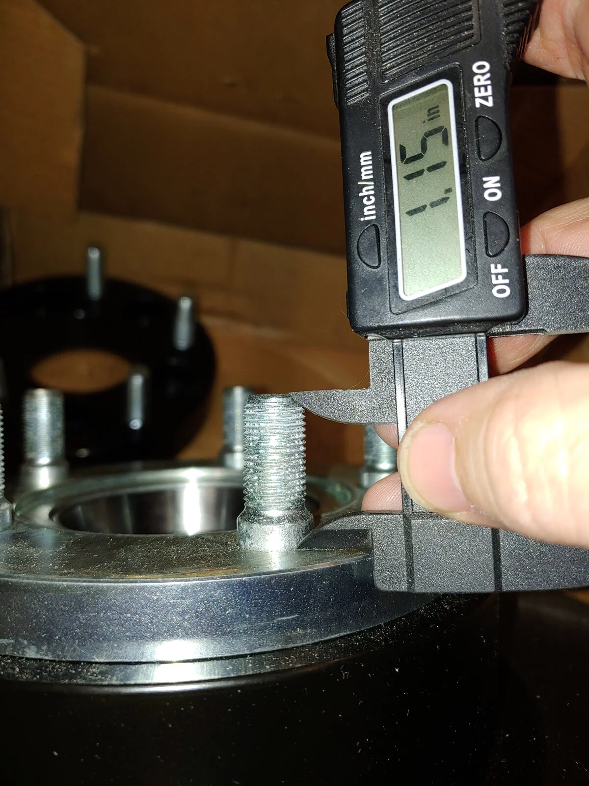

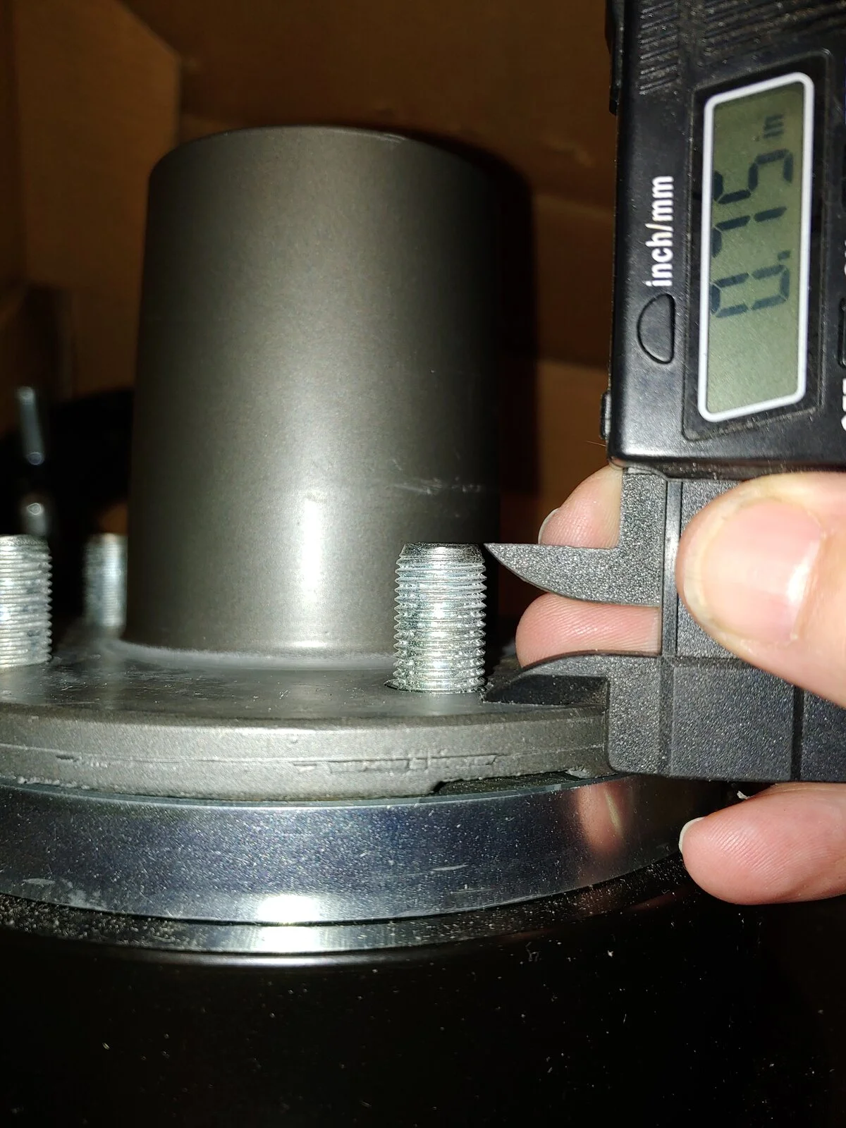

Got it. Distance looks relatively the same length. I get 6 full turns when finger tightening the lug nuts, then another turn when tightening with a torque wrench. That puts me at 7 full turns. Is that sufficient?
Not for me. I would want at a minimum one diameter of thread engagement. Since it is a 20 thread per inch stud, that means at least 10 turns. Time for some ET lug nuts.
