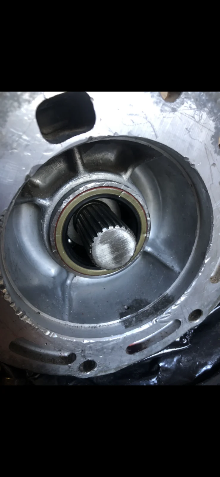

I still have a leak in the output shaft seal though which is frustrating. The PO already had a Teraflex seal extension in there that’s banged up and I’m sure it’s causing the leak but I just can’t figure out how to get it out. I have a new extension to replace it. I tried replacing the seal with rtv around the edge of it and still leaks

I still have a leak in the output shaft seal though which is frustrating. The PO already had a Teraflex seal extension in there that’s banged up and I’m sure it’s causing the leak but I just can’t figure out how to get it out. I have a new extension to replace it. I tried replacing the seal with rtv around the edge of it and still leaksView attachment 230361
Yes, that dent in the seal is the leak. I have never worked with one of those extensions, but I see what your talking about.
If it's loctite'd in there, you may need to warm around it with a small torch and pry it out with a with a tool like a rolling head pry bar, to replace the extension also.
