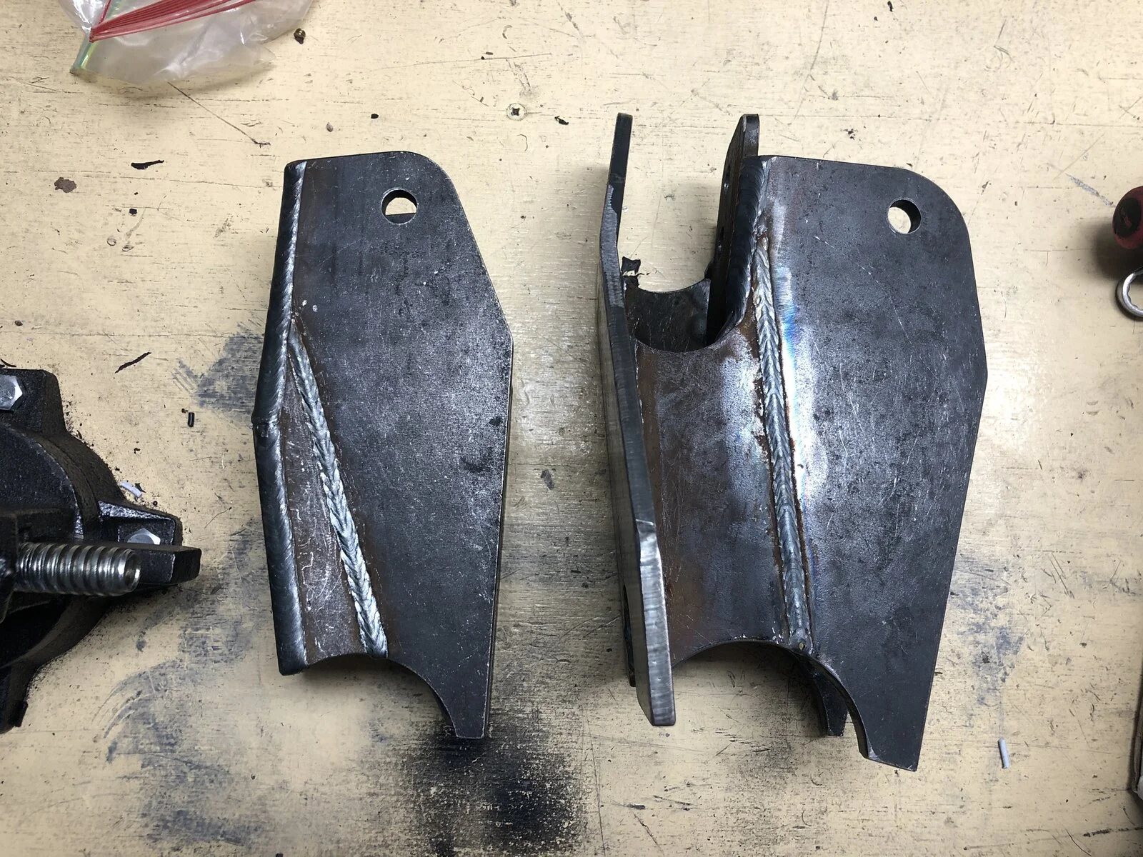

a table is a dam luxury.............i have several welds i'd be reluctant to show off due to being crammed up in some ungodly position to reach into an area i can't see in. and a missed line is not anywhere in the ballpark of some of the gobs we see.Had I known pics of my out of position-hood shoved up against the bottom of the tub- I can't fucking see- this is fully fucked and I hate myself right now-welds were going to be shown with such detail, I would have practiced up a bit more, those look like shit.

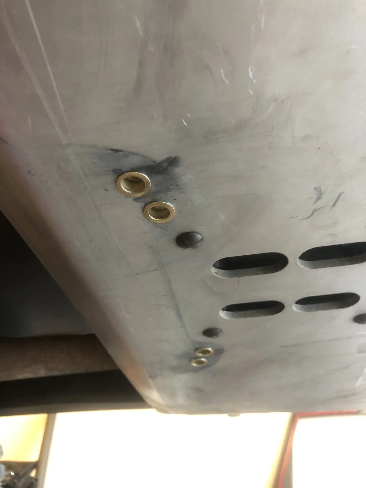

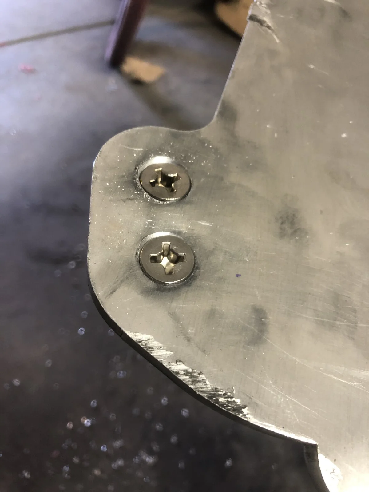

Why did I never think of that??? Genius.Savvifying my UCF skids. I have picked rocks out of the Allen head buttons and reached up between the skid and trans pan to thread nuts on for the last time.

It was fresh in my mind after installing all the armor. Today I had to take the engine skid off and it dawned on me! I’m glad I ordered 25 extra Phillips bolts!Why did I never think of that??? Genius.
Than practice grinding.Had I known pics of my out of position-hood shoved up against the bottom of the tub- I can't fucking see- this is fully fucked and I hate myself right now-welds were going to be shown with such detail, I would have practiced up a bit more, those look like shit.
If I can't get up in there to weld it, what the fuck makes you think I can get a grinder in there?Than practice grinding.
That isn't how Savvy does it. Anything other than the frame screws that holds a skid or similar on that can get the heads smeared on rocks gets through bolted. The reason for that is even if the head is smeared, you can still get a wrench on the nut and get stuff loose that way. I spent way too many hours welding nuts to the heads of bolts that were threaded into something for it to be any other way.Savvifying my UCF skids. I have picked rocks out of the Allen head buttons and reached up between the skid and trans pan to thread nuts on for the last time.
View attachment 244629View attachment 244630
That makes sense... I didn’t think about that. @Alex01 read this before you do anything.That isn't how Savvy does it. Anything other than the frame screws that holds a skid or similar on that can get the heads smeared on rocks gets through bolted. The reason for that is even if the head is smeared, you can still get a wrench on the nut and get stuff loose that way. I spent way too many hours welding nuts to the heads of bolts that were threaded into something for it to be any other way.
That makes sense. you're right that the nut is a redundant measure to insure you can get it off.That isn't how Savvy does it. Anything other than the frame screws that holds a skid or similar on that can get the heads smeared on rocks gets through bolted. The reason for that is even if the head is smeared, you can still get a wrench on the nut and get stuff loose that way. I spent way too many hours welding nuts to the heads of bolts that were threaded into something for it to be any other way.
I suppose I will be getting some welder use if I smoosh the phillips too badlyThat makes sense. you're right that the nut is a redundant measure to insure you can get it off.
I will say though I do feel like I get added value from the welder everytime I weld a nut to a bolt/screw

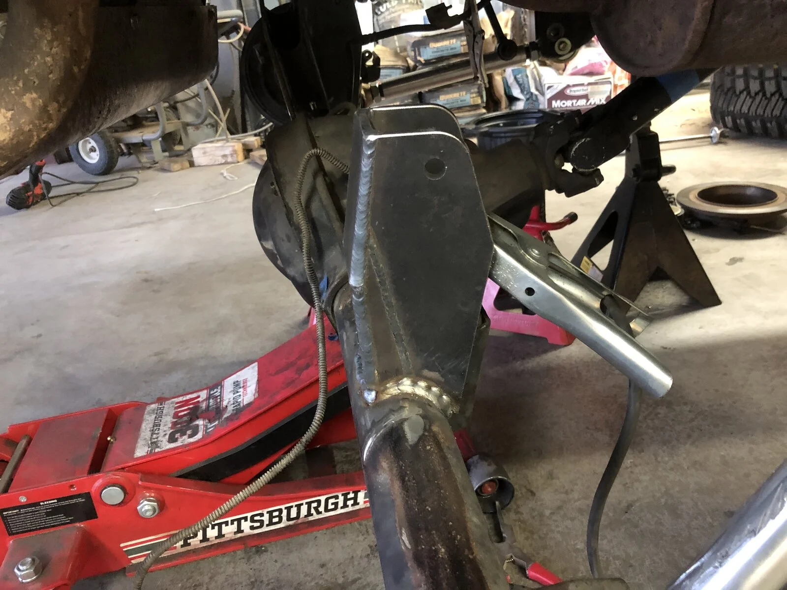

Did you get a measurement of the height vs OEM? I’m curious since pictures are too hard to gaugeThis project has been taking a lot longer than I planned. I’ll go into more depth later but first bracket is burned in!View attachment 245210
I did not and I butchered my stocker. The hole on the new bracket sits 6 3/8” from the axle tube thoughDid you get a measurement of the height vs OEM? I’m curious since pictures are too hard to gauge
Nice welding there, Stark.This project has been taking a lot longer than I planned. I’ll go into more depth later but first bracket is burned in!View attachment 245210
Yeah man, those are looking solid!Nice welding there, Stark.
