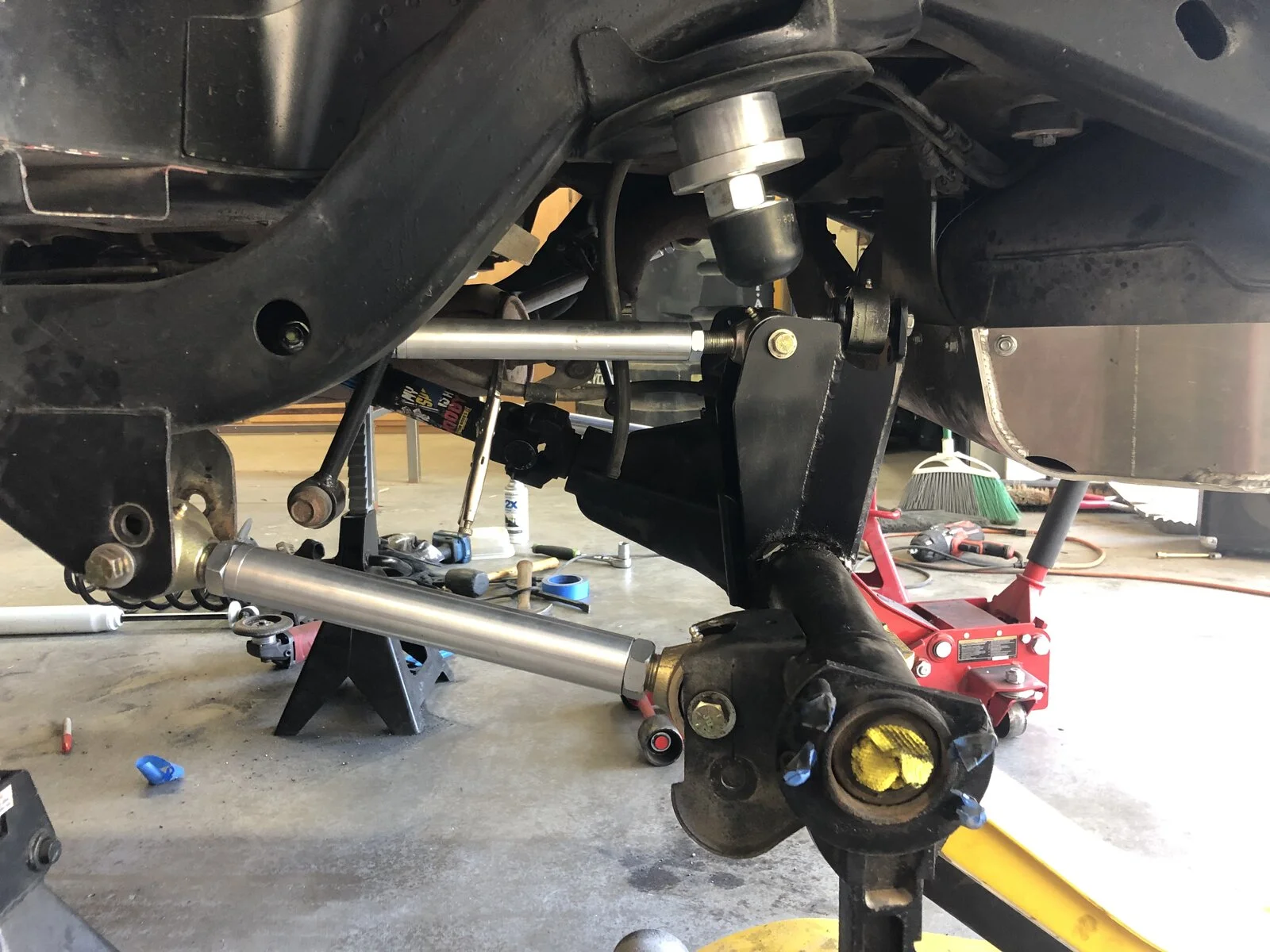

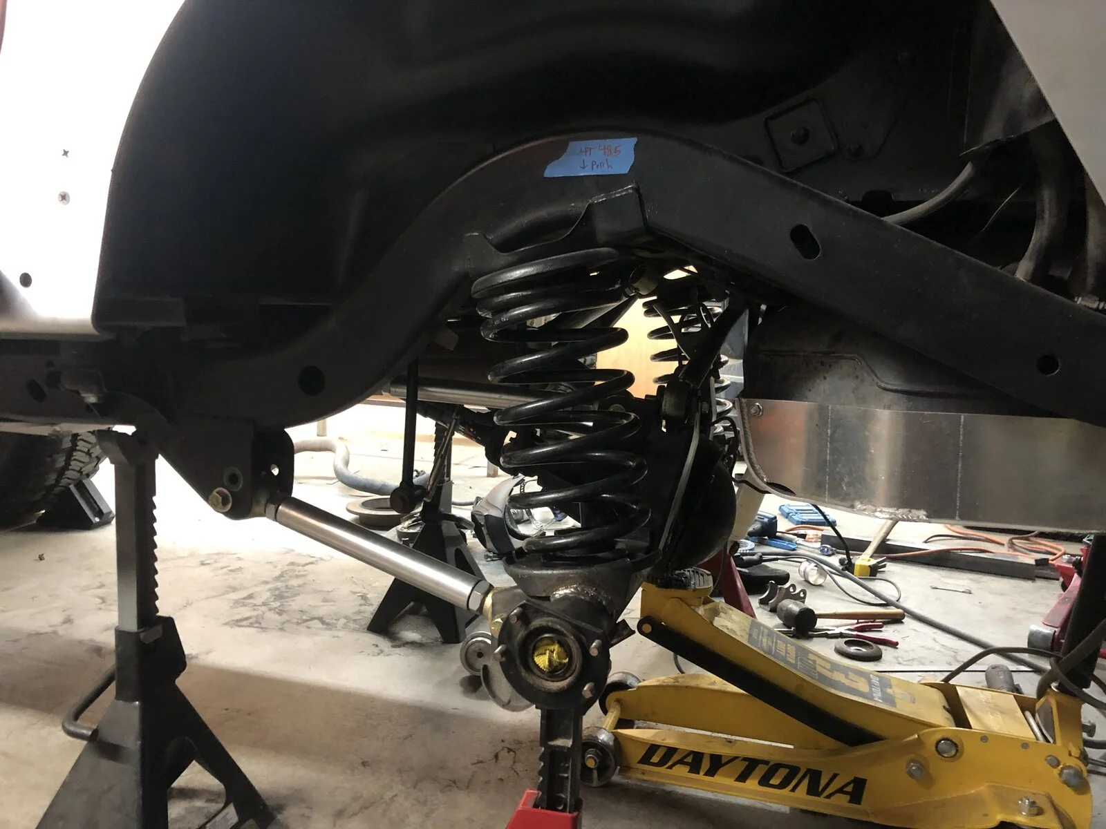

Both towers burned in, lowers relocated, cutting is all done. Next up is to cycle, burn the perches in, and put the shock mounts where I want.
I’m taking forever on this. My exhaust didn’t work with the new towers so I had to cut it and run a turn down after the muffler for now until I have more time. Here is what the springs look like with full weight on them and the lower perches relocated

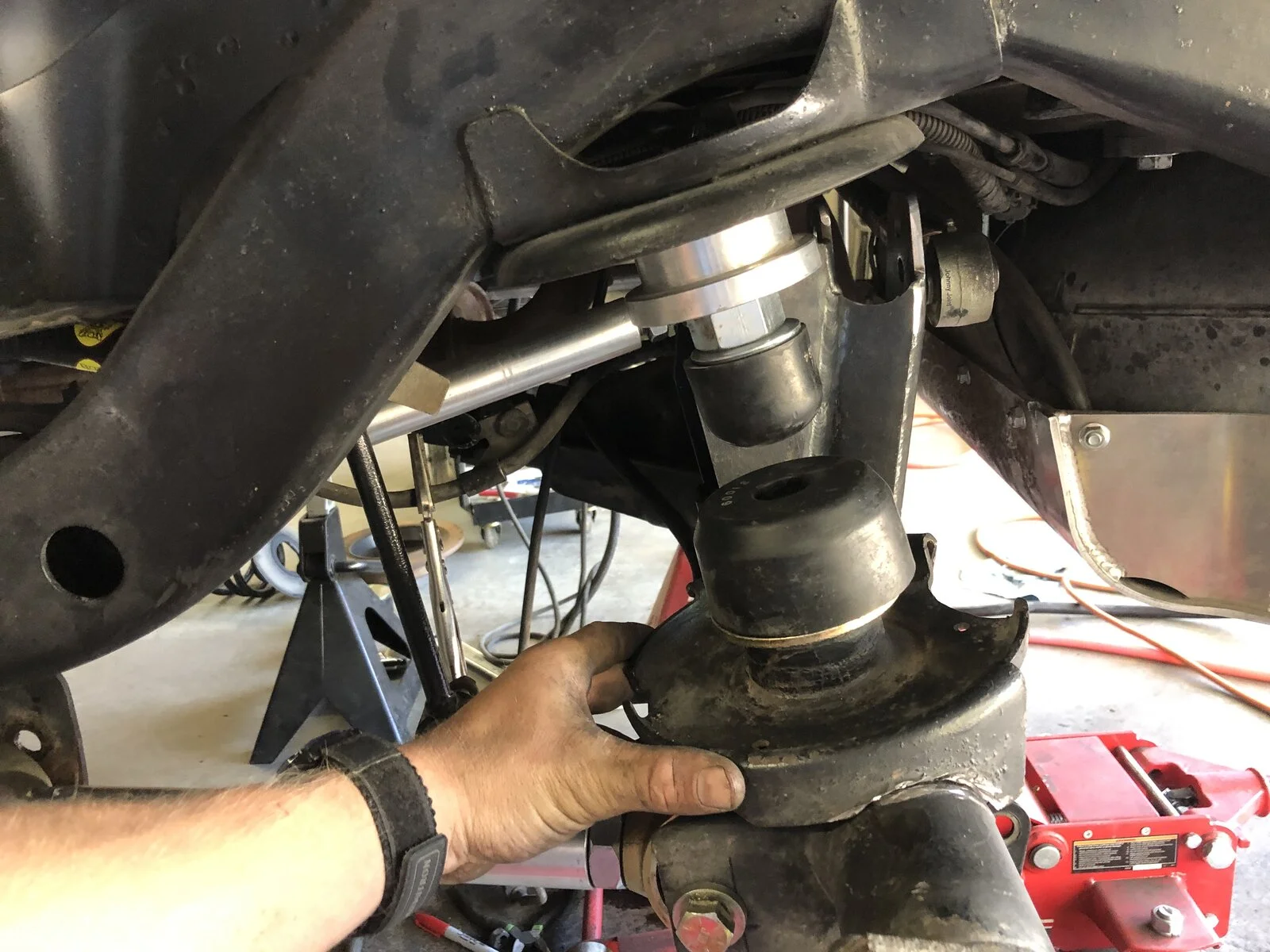

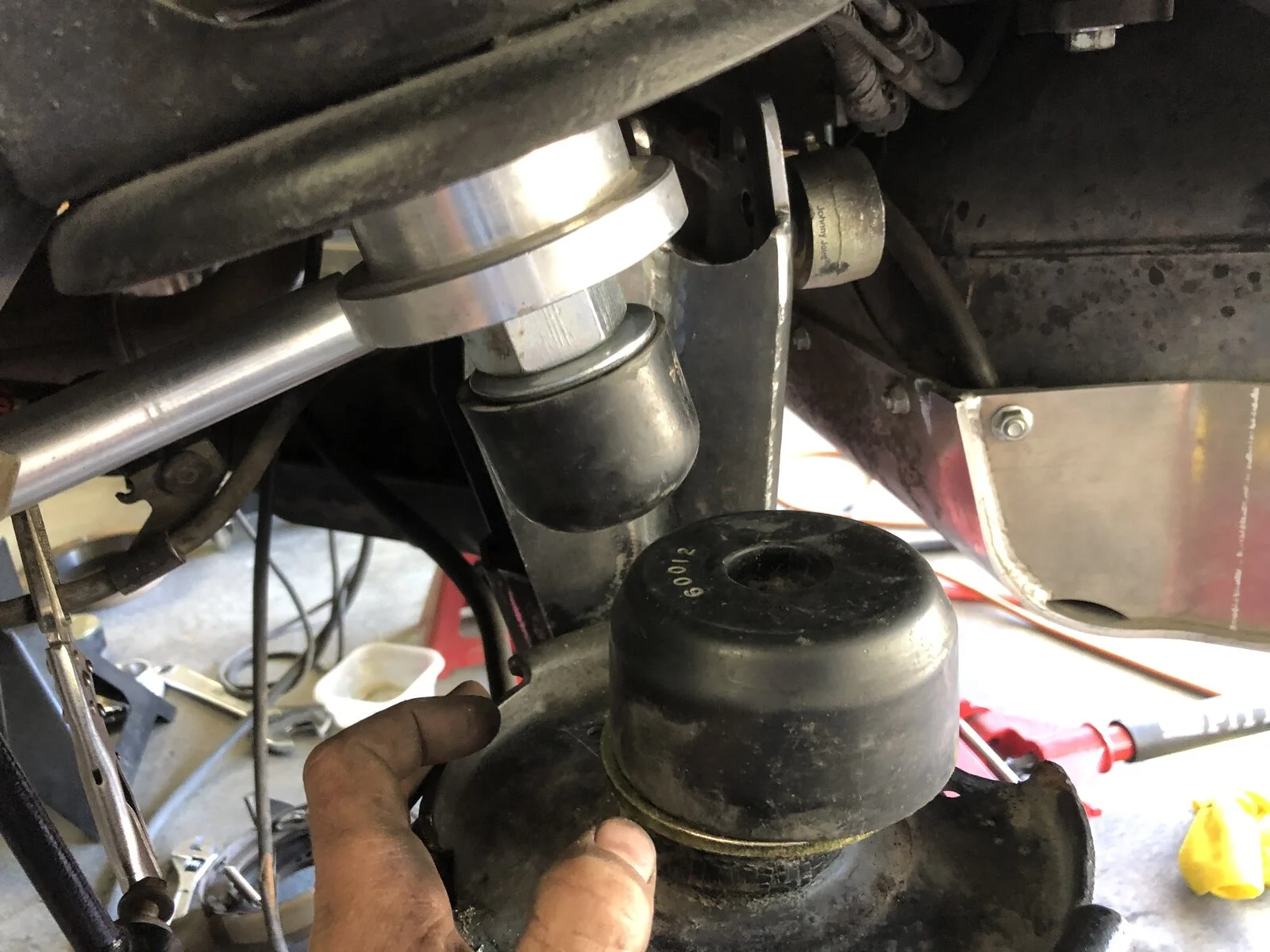

Here’s old bumpstop alignment
Here’s new
Are you going to relocate the upper perches or keep them in the stock location?

Question regarding the relocation brackets, more specifically the lower control arm brackets on the axle. Are those a simple re-drill or is there an actual new bracket for those?

I have the same brackets, sitting on my shelf, to be installed after my tub swap. How did you decide how far to rotate to brackets around the tube? That's the one piece of the puzzle I haven't been able to work though in my mind.
How is the gas tank clearance with the new track bar location?

The brackets weld parallel to and against the sway bar mounts. Super easy to align. Let me know when you’re ready and I’ll send detailed pics.
More gas tank clearance than you’ll ever need. The track bar sits like stock now and my pinion is sky high
