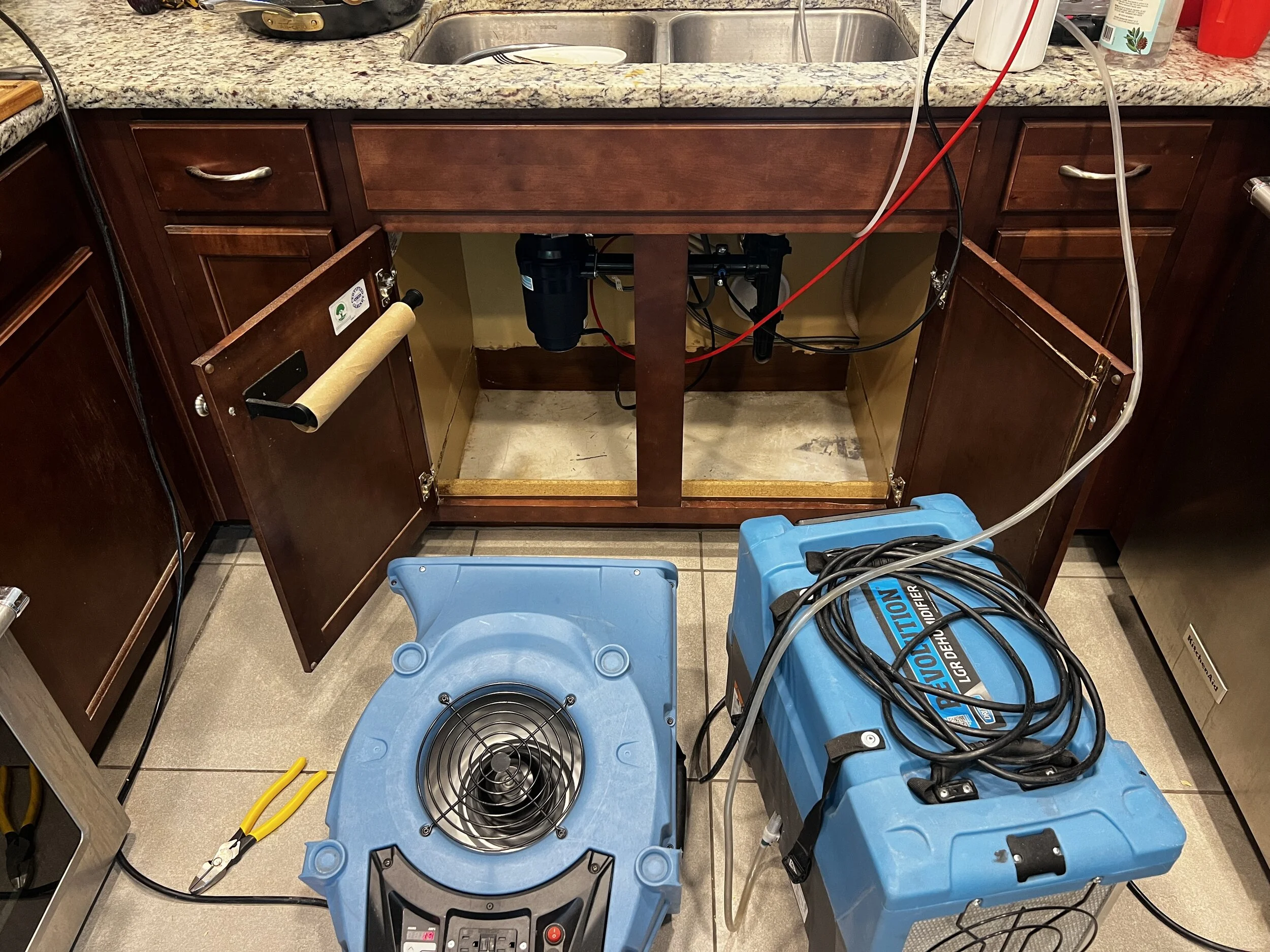

Took a break from the tow piggy today. A leak under our sink led to a very soggy cabinet floor that was caving in. So today I went out and got a m12 oscillating multi tool and cut out the floor under the sink. Drying everything out with a fan and dehumidifier our buddy lent us. I will be building a removable floor just in case my wife decides to change the water filters again 😉

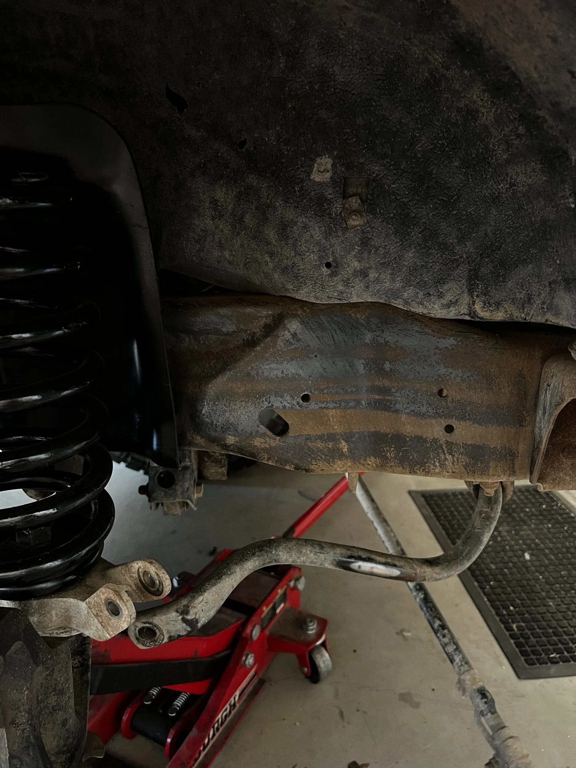

Here’s just a 5 second run on the frame with a brush. It’s just a light coat of surface rust. Almost seems like the frame had no paint on it lol

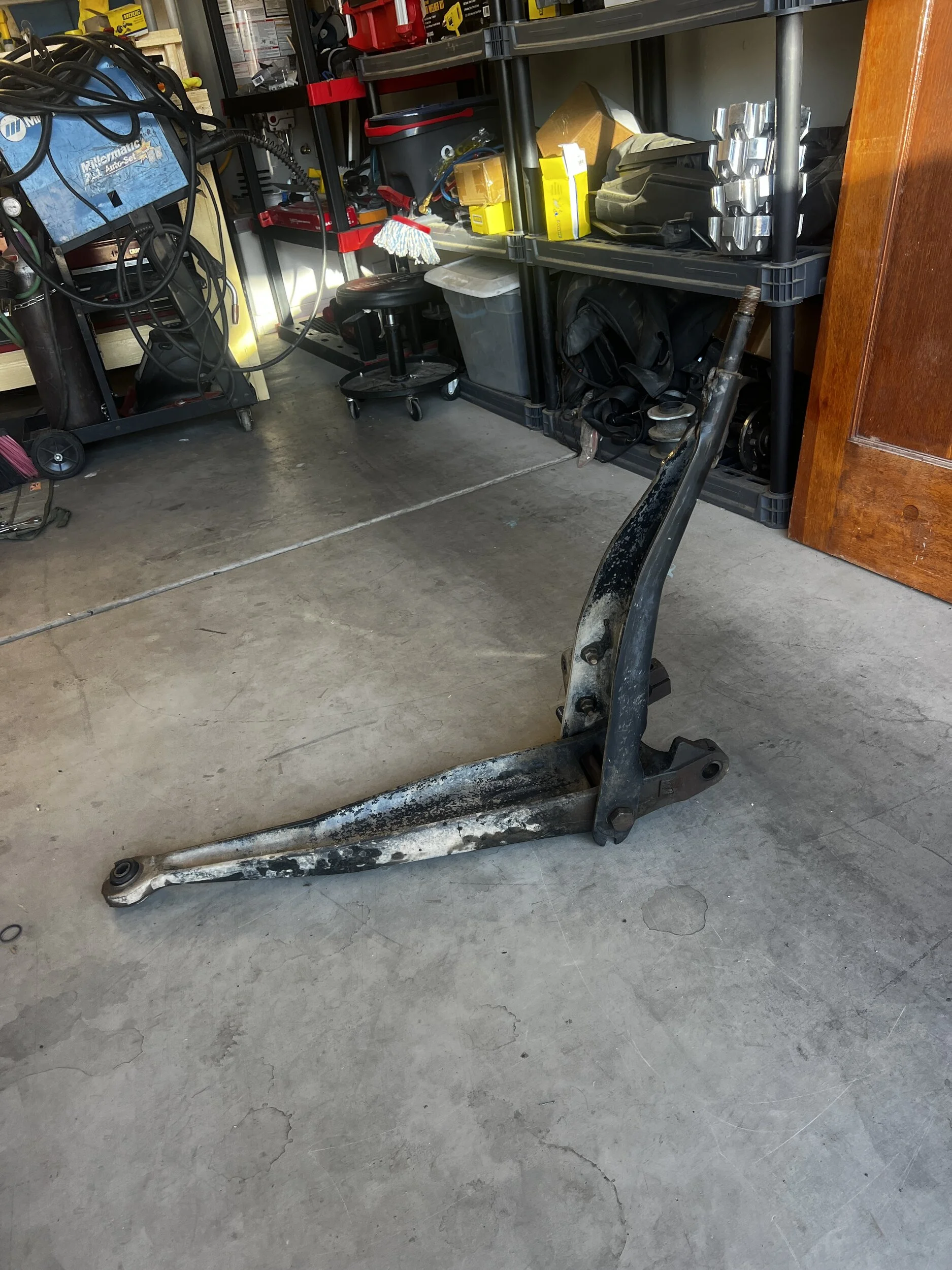

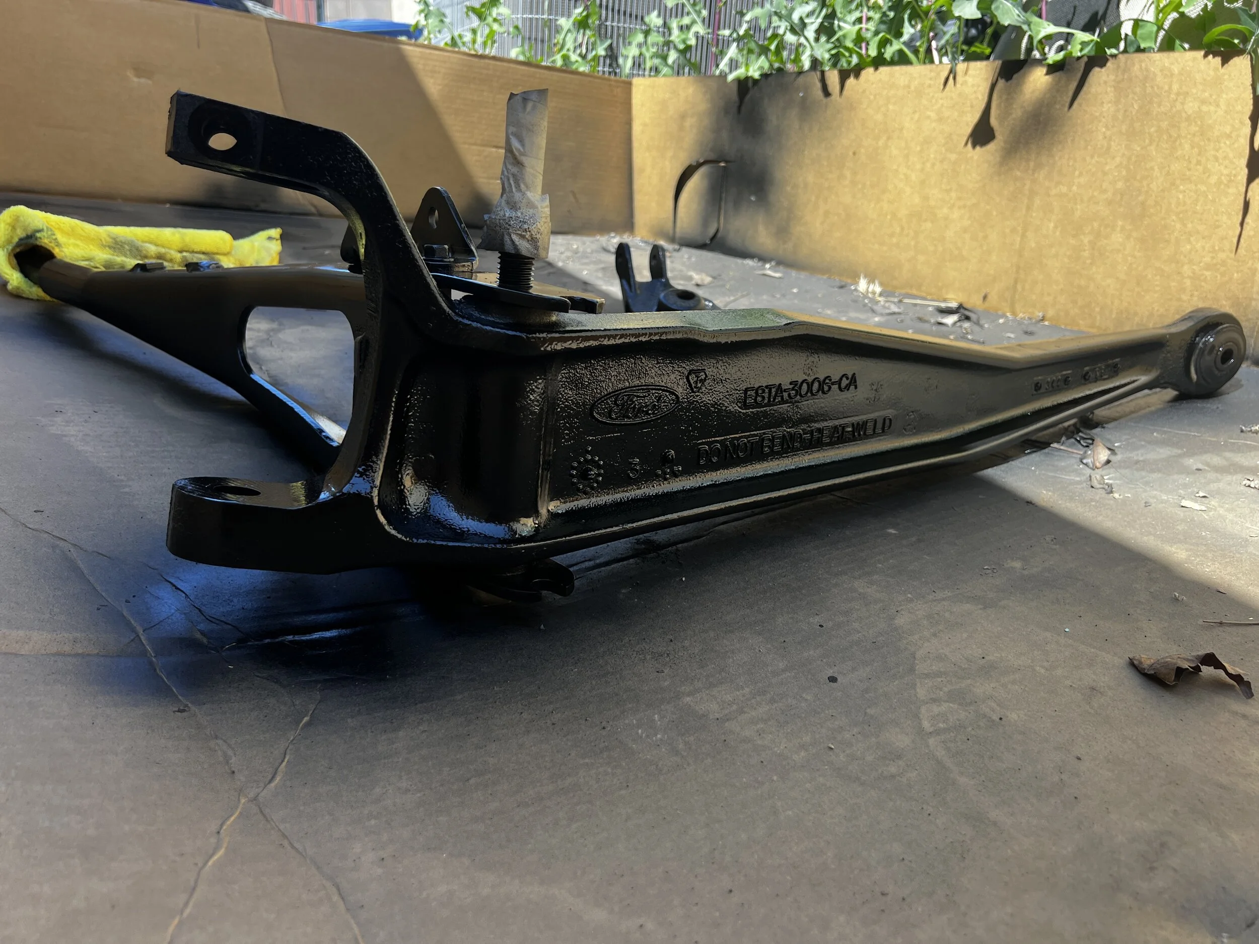

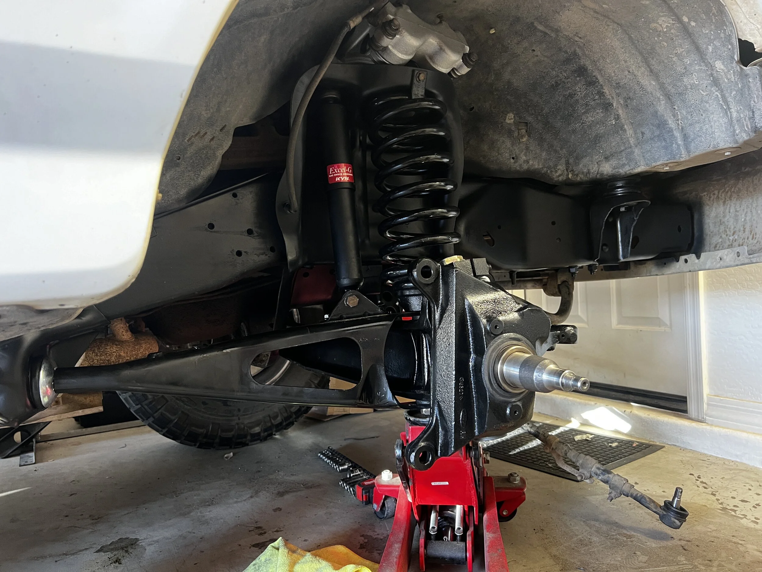

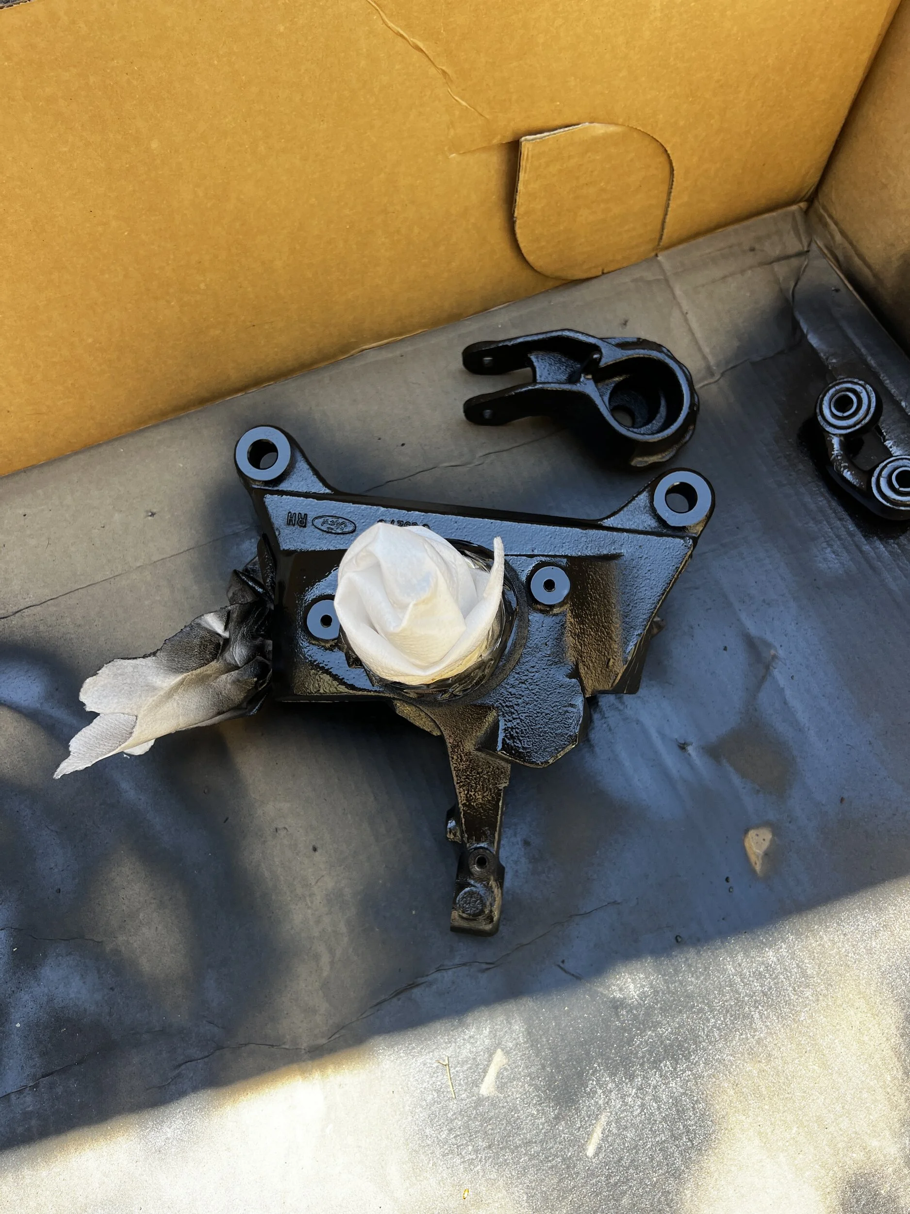

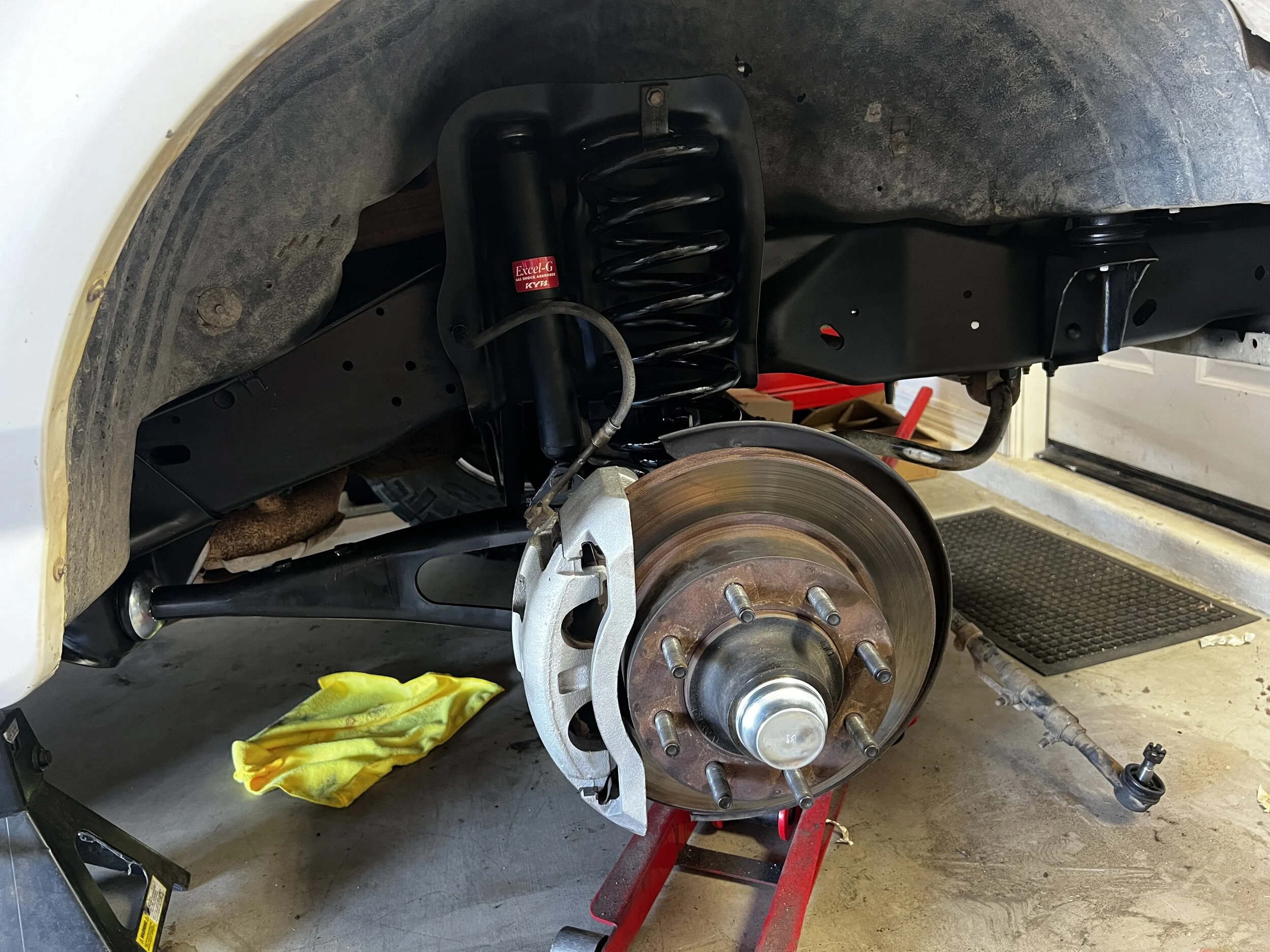

Pulled the I beam and radius arm

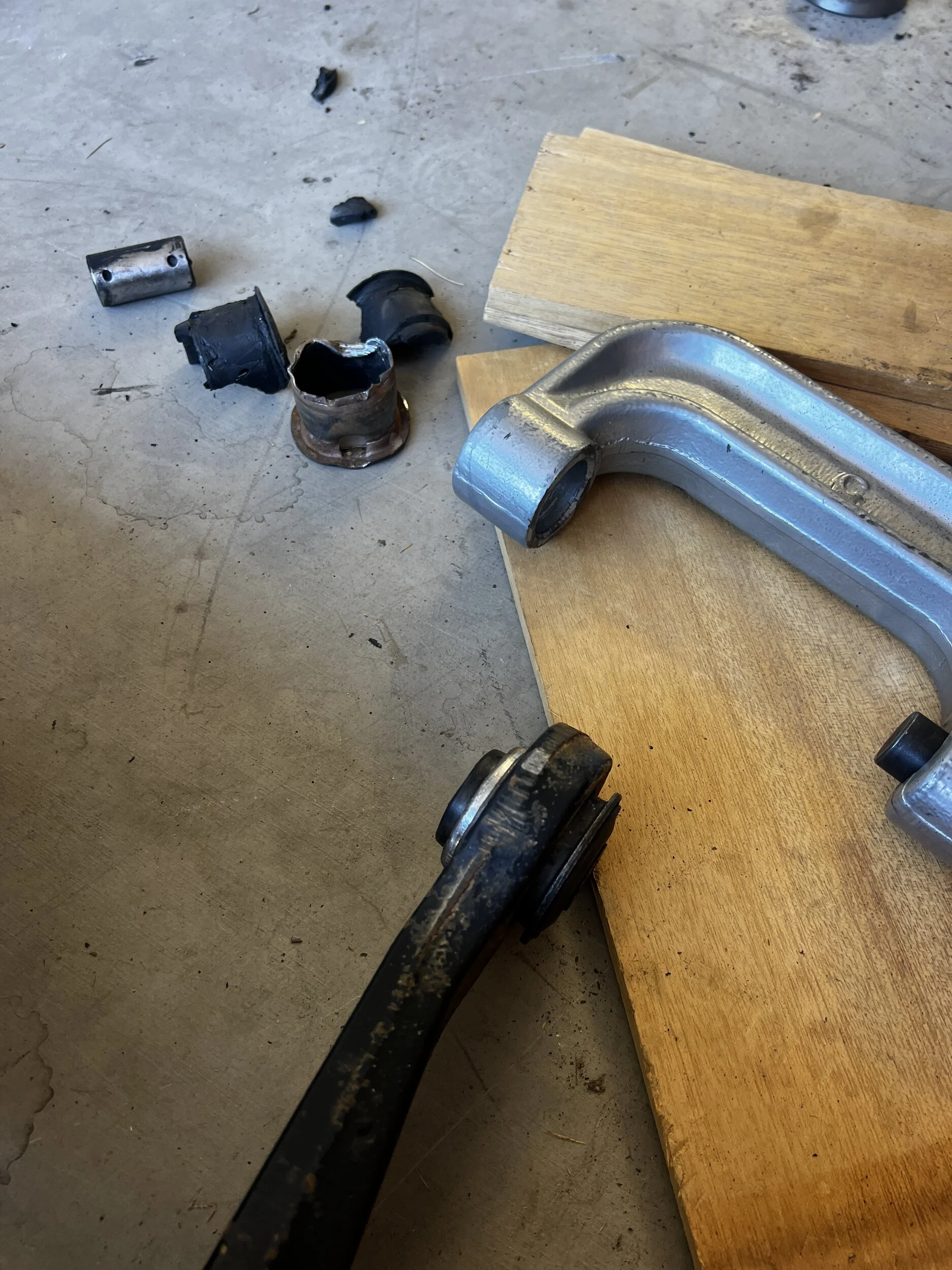

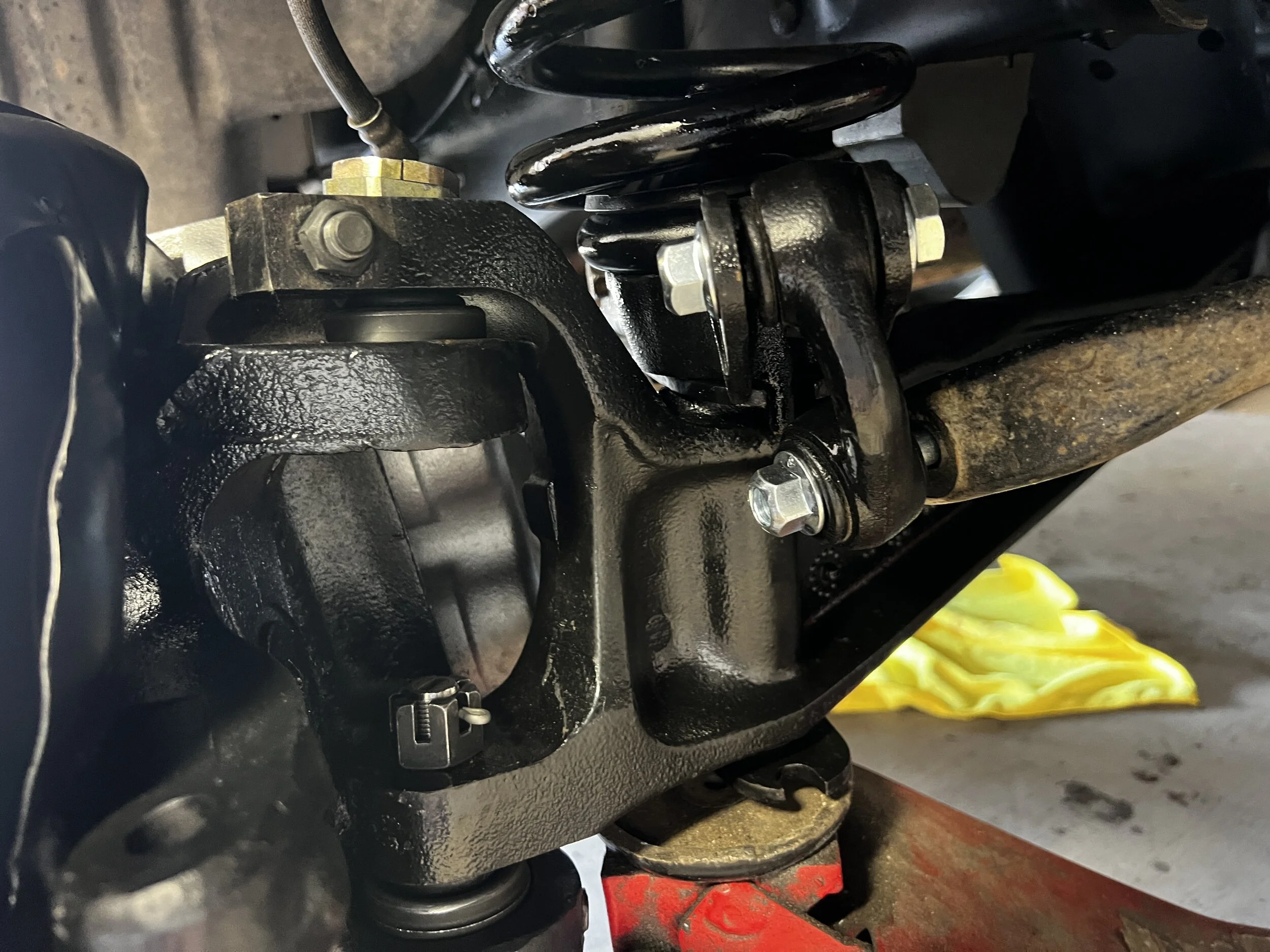

Popped the old bushing out and drove a new bushing in. Factory left about 1/4” between the edge of the bushing and the I beam so I left it that way as well.

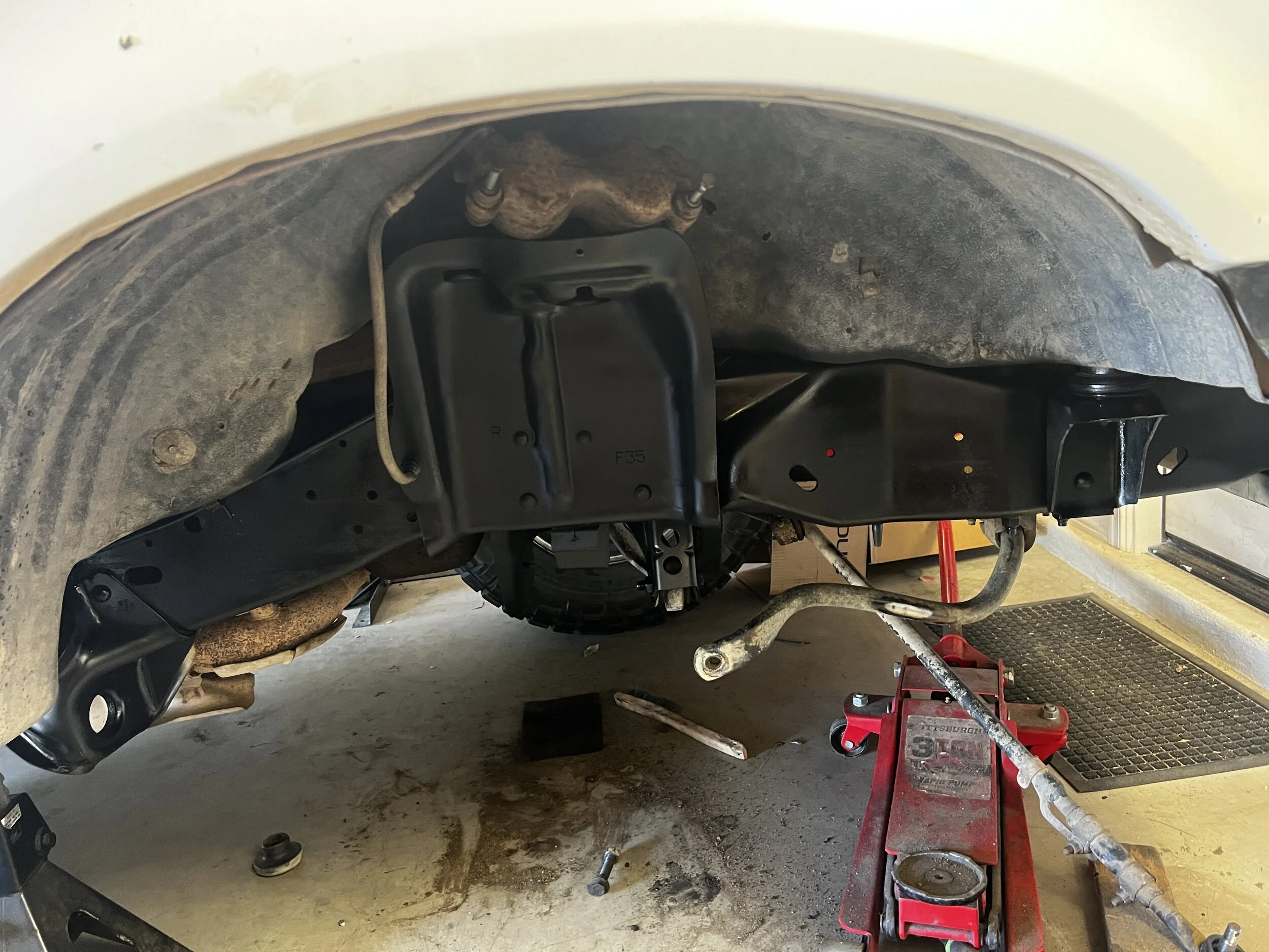

Painted the I beams with Krylon Rust tough high gloss
And painted the frame with krylon semi flat wherever I had easy access with all the parts taken out. As crusty as she looked it was mostly dirt and a little surface rust caked on there. Not going for a super detail oriented on this truck as it’s just a budget build. I took a carbon steel brush and brushed it up and then scotchbrite pad and washed it all off with some simple green and gave her some paint. Converting all the surface rust and perfectly sealing it isn’t really my intention as it doesn’t matter here in AZ. Mainly just doing a bang for buck aesthetic cleanup. Plus the frame is all open, so it isn’t like a TJ where rot can lurk within.
I’ll keep painting sections of the frame here and there as I get to them when it’s convenient and have easy access.
Pulled the I beam and radius armView attachment 525838
