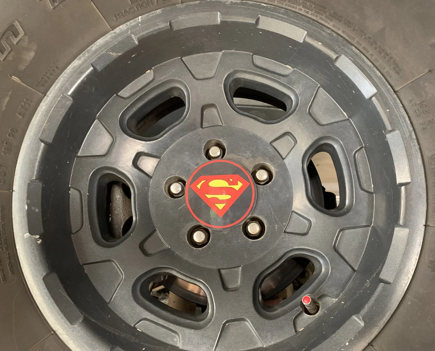

Unlucky for me, my wheels would not center using the tire monkey method of fully tightening the first lug with an impact wrench. Once I learned to properly center my wheels as they were installed, I quit having wobble problems. I resisted the using hub centric adapters for a couple of years because the hub covers of my wheels would not work with them. This year, I installed hub centric adapters and made some custom wheel centers. I like how they turned out. :)

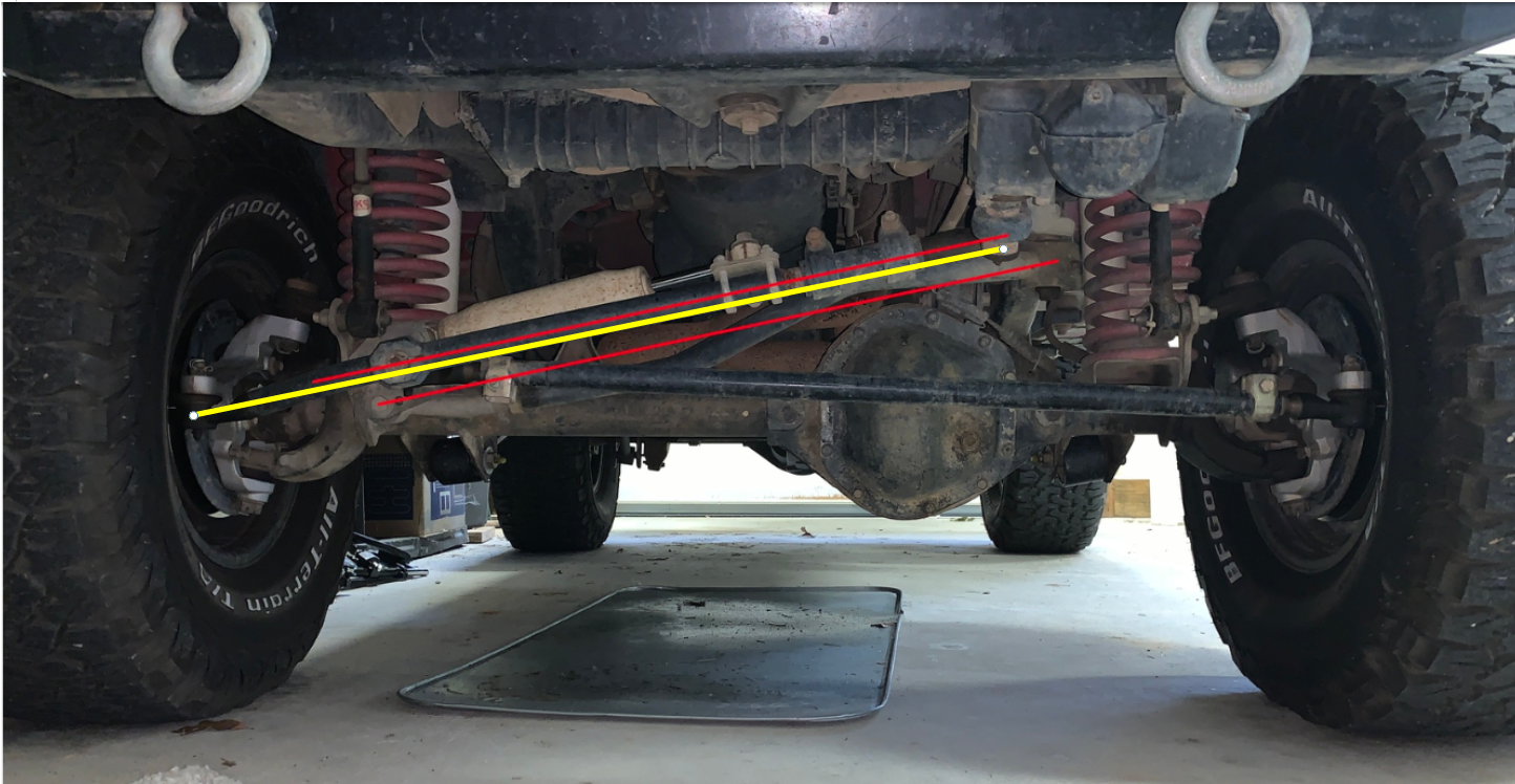

Your two lines while fairly accurate, should take into account the pivot points at each end of the draglink. More like this. Doesn't change much except the location of the pivots.
Another good point. Only thing is you should have drawn the line on his front end photo. Mine is working OK.

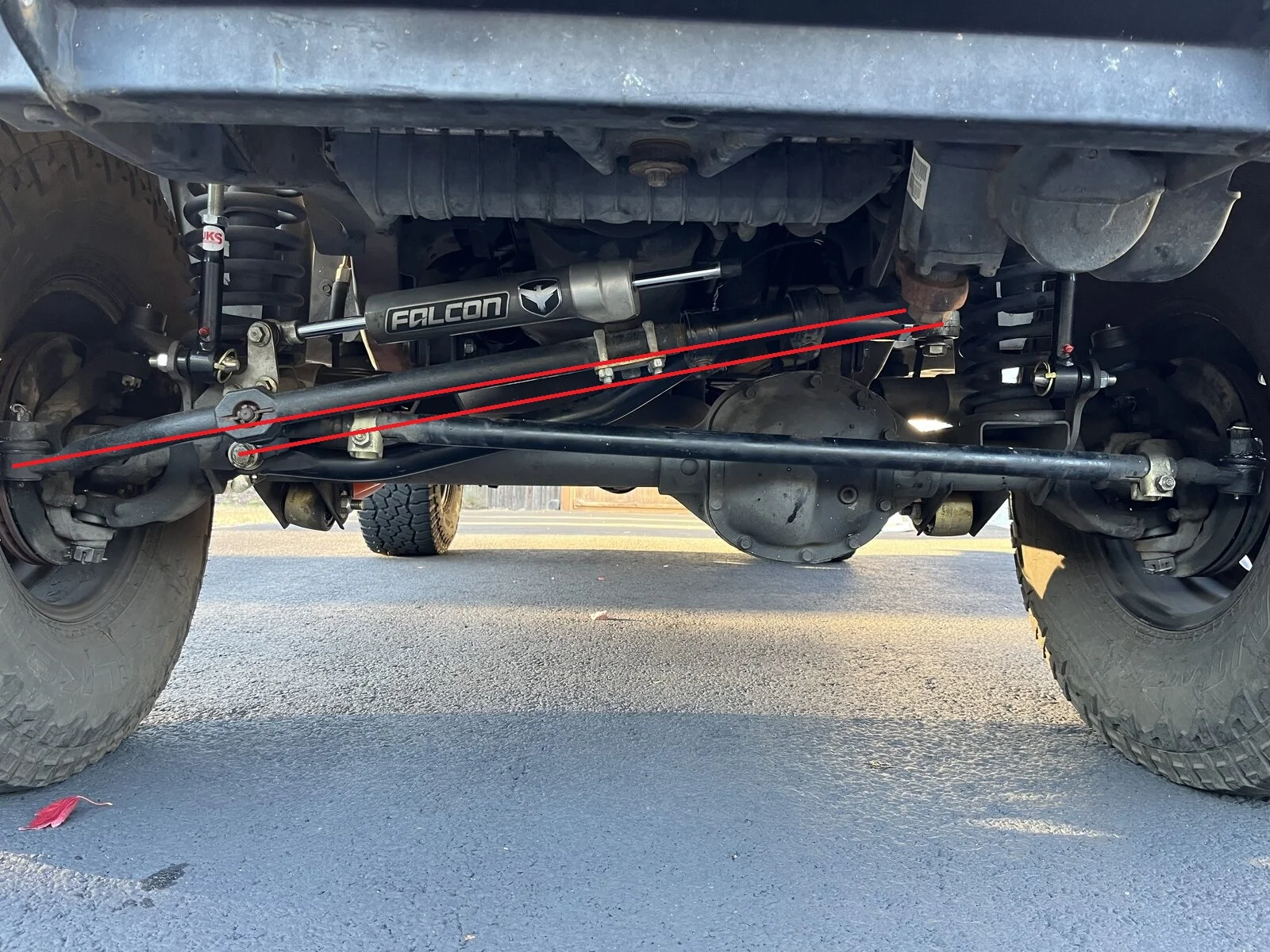

@mrblaine mentioned the pivot points for the draglink. Is there something specific I should be looking for at those pivot points that can be adjusted or or is this an area that needs parts or fabrication to correct?
You want the factory mounting points on both the track bar and the drag link. Meaning, no drop brackets and no dropped pitman arm. That is all you care about, unless you are dealing with some custom non-stock steering and suspension configuration.

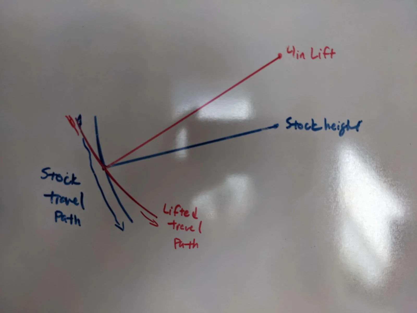

When you lift the Jeep and run an adjustable trackbar you're creating a longer lever and a different "swing angle" that the axle is traveling along. This creates a side-to-side movement in the axle. When you correct the geometry via a drop bracket it makes the axle travel on a more vertical path. It looks like you're on a 4in lift which means that front axle is really swiinging... Let me illustrate:
If the draglink and trackbar a parallel and in the same plane, how do it know?
Not entirely sure on that, the side-to-side movement I illustrated would probably affect the steering as well assuming a static steering wheel/pitman position.
