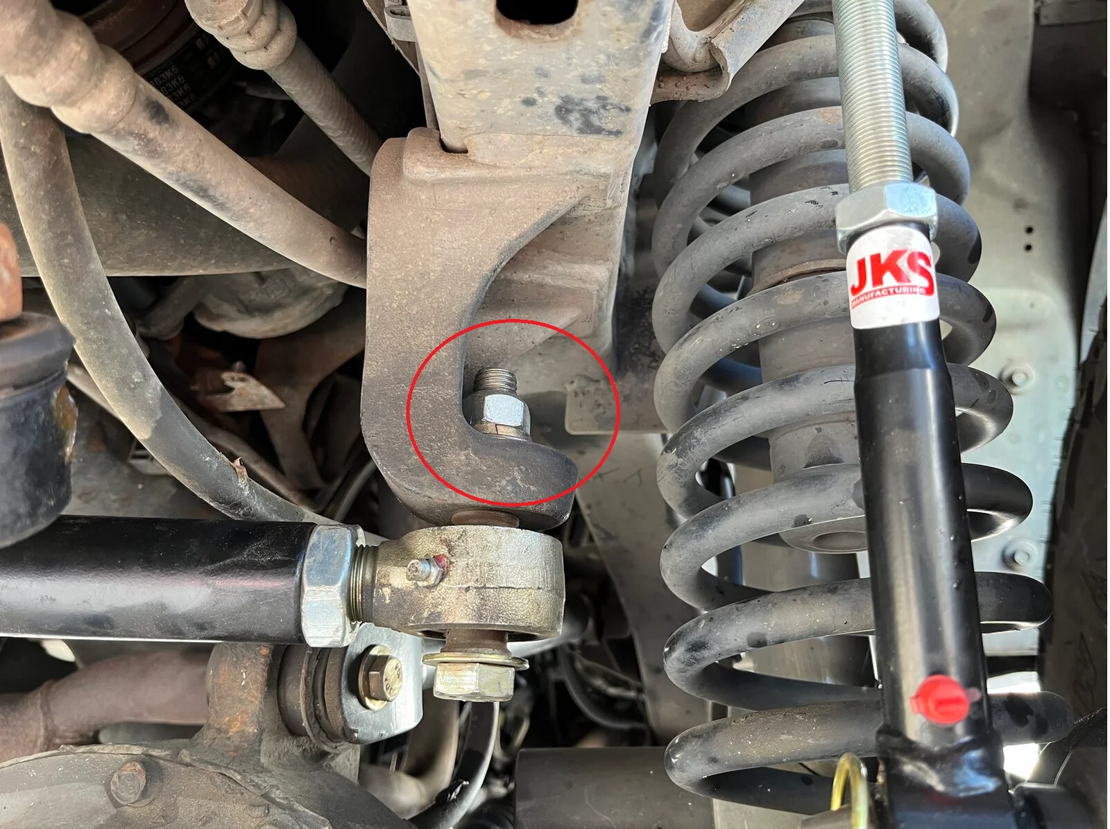

@freedom_in_4low you mentioned the axle side track bar end not being in the original location. I wonder if there could be a chance that the hole is wallowed out? I guess I should disconnect it and take a look. Although dry steering test doesnt show any movement.
If it's properly torqued, it has to be REALLY wallowed out, like approaching the diameter of the bolt head for it to be a problem. And if that was a problem, it would more likely be death wobble than bump steer. Like I said, kinda grasping at straws with that. Usually the kind of drag link vs track bar mismatch that causes bump steer is off by multiple inches.

Hard to tell from the picture, but is there a lock and flat washer here?

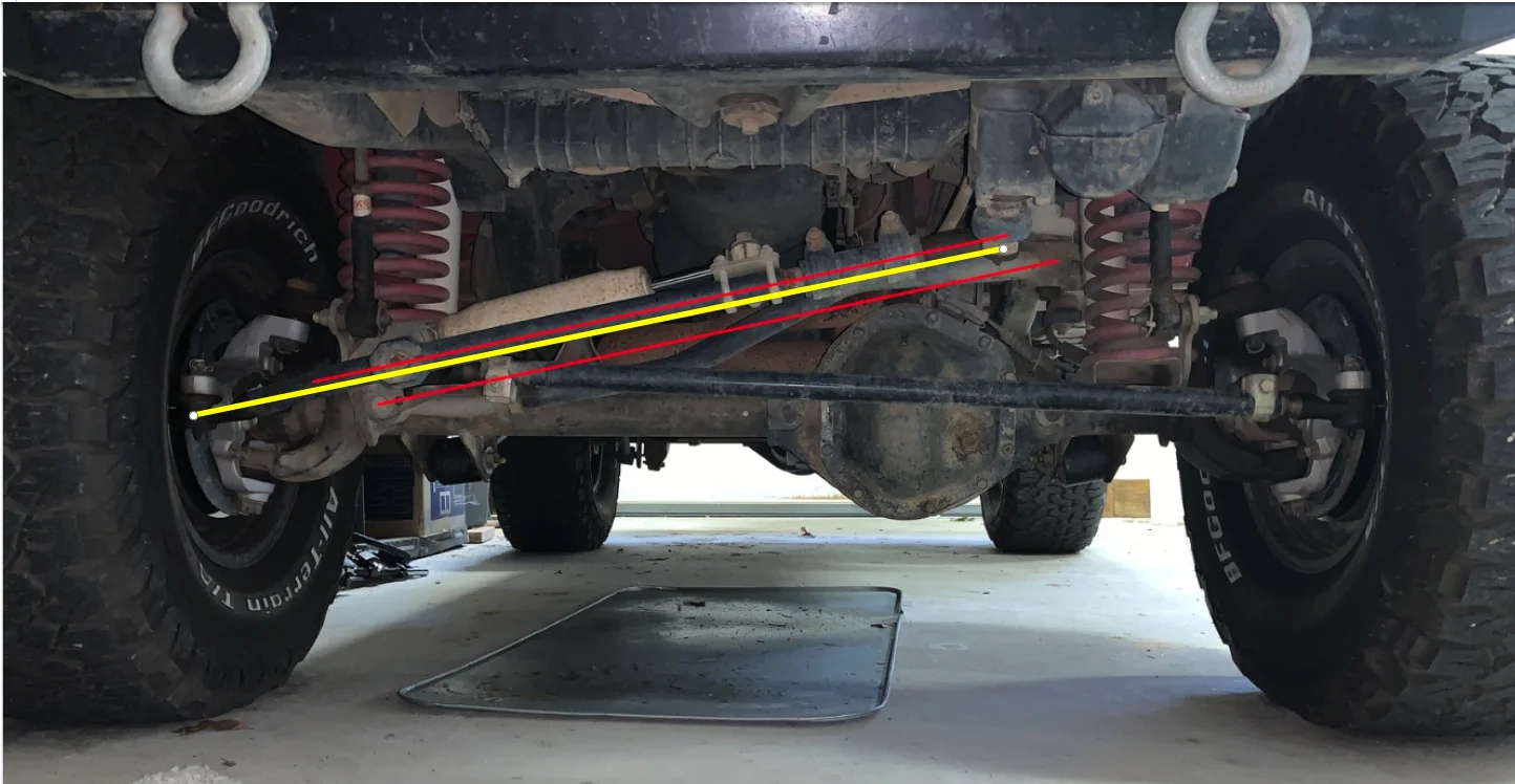

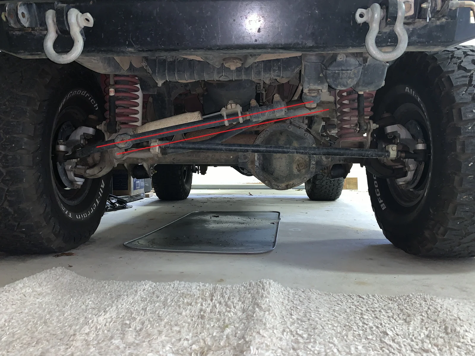

Bump steer, as I understand it, comes from different angles and/or lenghts when comparing the track bar and the drag link. You do not have a good head on photo, but I'd guess your setup is OK.

Your two lines while fairly accurate, should take into account the pivot points at each end of the draglink. More like this. Doesn't change much except the location of the pivots.
