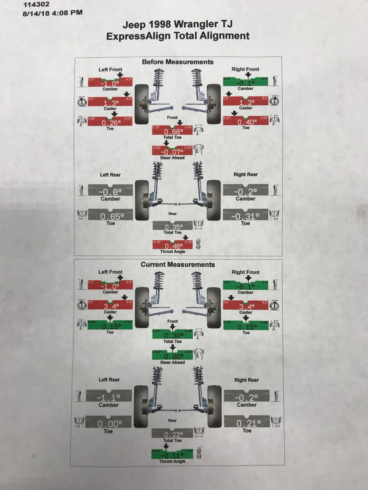

posted alignment results. hope you or someone can clue me into the issue. thnks
Your total .30 toe-in is dead-nuts on, perfect. Your 3.4 degree caster angle is just over half of what it should be. Insufficient caster angle will result in poor steering return-to-center after completing a turn and unstable twitchy steering on a level highway. I'd want nothing less than 5.5 to 6 degrees. What size tires? I am concerned that both sides have the same 3.4 degree caster angle. The factory welded the knuckles into place to give .4 or so less of a caster angle on the driver's side than is on the passenger side. The L-R side caster angles should not normally be identical as your printout says they are. Makes me wonder how the shop measured them or if they actually measured both sides.

yes installed metal claok trac bar with no drop bracket. they just called and sent over the printout. should i ask them to adjust it? also i am running 33 tires

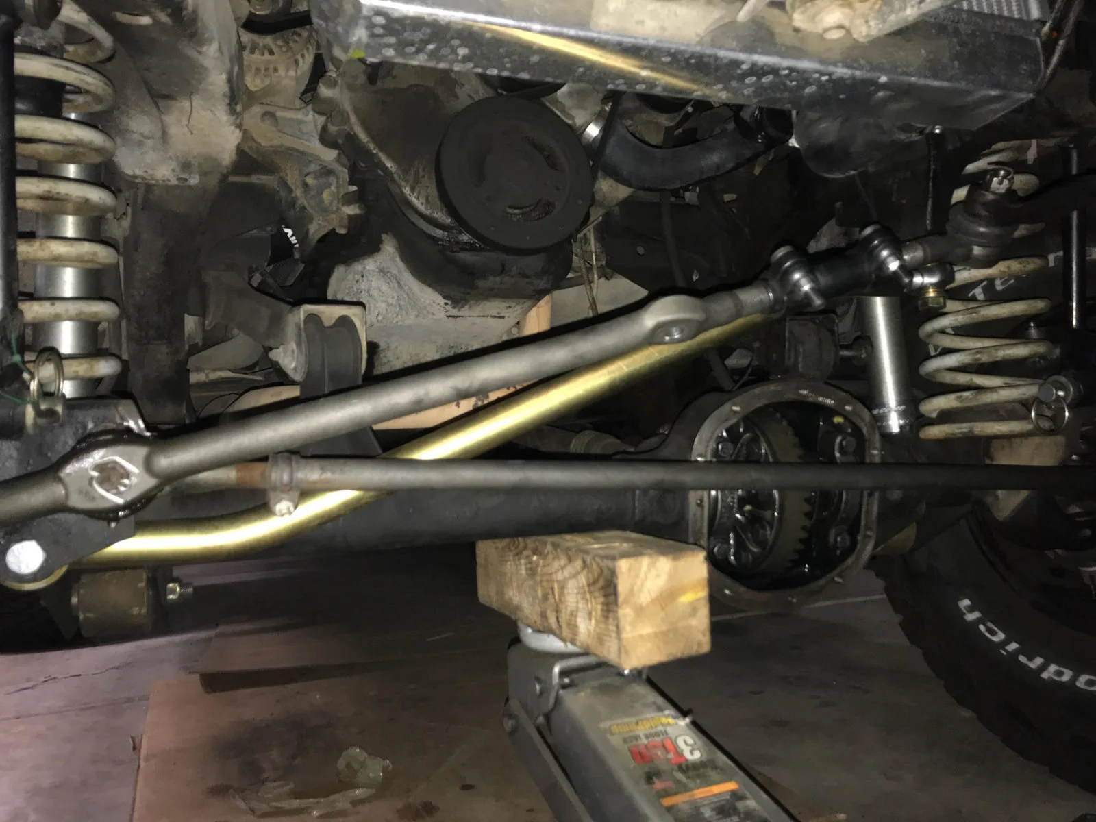

The area of interest is way off to the side, mostly out of view, and in a dark shadow. DId you intend for us to be able to see the driver's side track bar mounting bracket we needed to see that is not in the photo at all?
no it was the only picture i had at the moment. i realize it doesnt not show the trac bar and drag in relation to each other on the driver side. will get another picture up soon as i get it back. should i call 4wheel parts and have them adjust the caster to the specs your suggesting? thanks!!!!

Just FYI. The alignment equipment makes you go through a "caster sweep" which is turning the wheels about 25 degrees right then 25 left then steer straight ahead, the sensors/computer then calculate the caster of both wheels at once. You can skip that step and have no reading on the print out if you chose, but if you have a reading it's legit.
Oddly enough it's the only measurement a lazy tech can't cheat on the machine. Camber and toe can be manipulated without adjustments :eek:. (Not that that happens o_O)

How do you explain the L-R side caster angles being the same when they should be .4 to .5 degrees apart? The TJ's knuckles are welded onto the axle tubes rotated .4 to .5 degrees apart from each other to create that L-R caster angle differential.

Are you serious? The knuckles set the caster angle differential between the sides and they are welded to the axle tubes which don't twist to remove the required caster angle differential unless from a serious impact or similar. The caster angle relationship between the left & right sides stays a constant unless there was a major impact with the axle that twisted one side.
Not to mention it would take a very precise amount of axle tube twist to make the two caster angles exactly the same as the printout indicates.

Yes '97 to mid-99 TJ have cam bolts for the caster angle (+/- 1.5 degrees) but the L-R caster angles are not separately adjustable. The two side caster angles are locked together since the knuckles are, again, welded to give the different L-R caster angles that are required and part of the normal axle setup.
Look Jerry, I just stated how the equipment works. Your the undisputed Jeep God so you tell me how the caster is the same. The measurement can't be manipulated, so it is what it is.
That's why I questioned the same-same measurement shown on the printout. Something isn't right somewhere.
