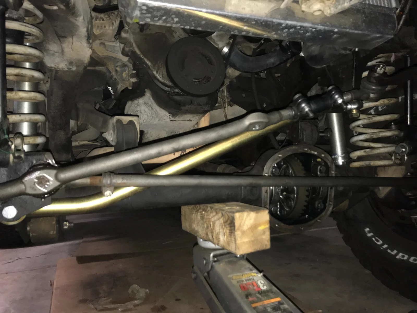

Jerry is bang on here, the only other thing I noticed is that picture you posted first off (second picture you talked about is missing) looks like it's got a WJ or JK steering setup. Is that I need what you have or is yours the standard TJ y link setup?

i have the standard y link setup. i just a beefed up moog kit. i posted a pic on begining of thread that had the dual steering stabilizers and a rough country adj trac bar with a drop down bracket. today i posted the photo with the metal cloak trac bar and removed the second steering stabilizer

update. metal cloak bar on and toe is set properly but still having bump steer. sad to admit i may have to drop it off at 4wheel parts to get a diagnosis. hate to do it but im out of ideas and options

slow speed is no issue until i reach 20mph. then once i hit a groove in the road the jeep wanders and will over correct. i cant find center, its constantly back and forth at higher speeds.
my drag link and trac bar are completely even at driver side. however the trac bar sits higher than drag link at pass side. 3'' difference to be approximate. stock pitman arm and all mounted in factory locations w no modifications to mounts.

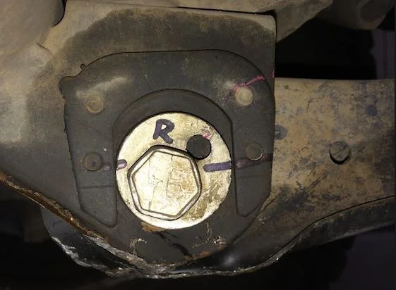

If it's not off by much, you can save big $$$ by installing cam bolts where the lower-front control arm bolts to the axle. That allows about 1.5 degrees of caster angle adjustment. All TJs came with a pair of those cam bolts until around mid-1999.
perfect. i actually just removed these from the factory arms and put them on the curries arms that i installed.

View attachment 50516 View attachment 50517
so i removed these from the factory control arms and installed my currie short arm kit all around. even swapped over the adjustment bolts from the stock lower control arms. took the jeep up to 4wheel parts yesterday so we will see what they are able to accomplish with all the adjust ability. im hopeful they can get the tj road worthy again. will post print out of alignment once i speak to them
