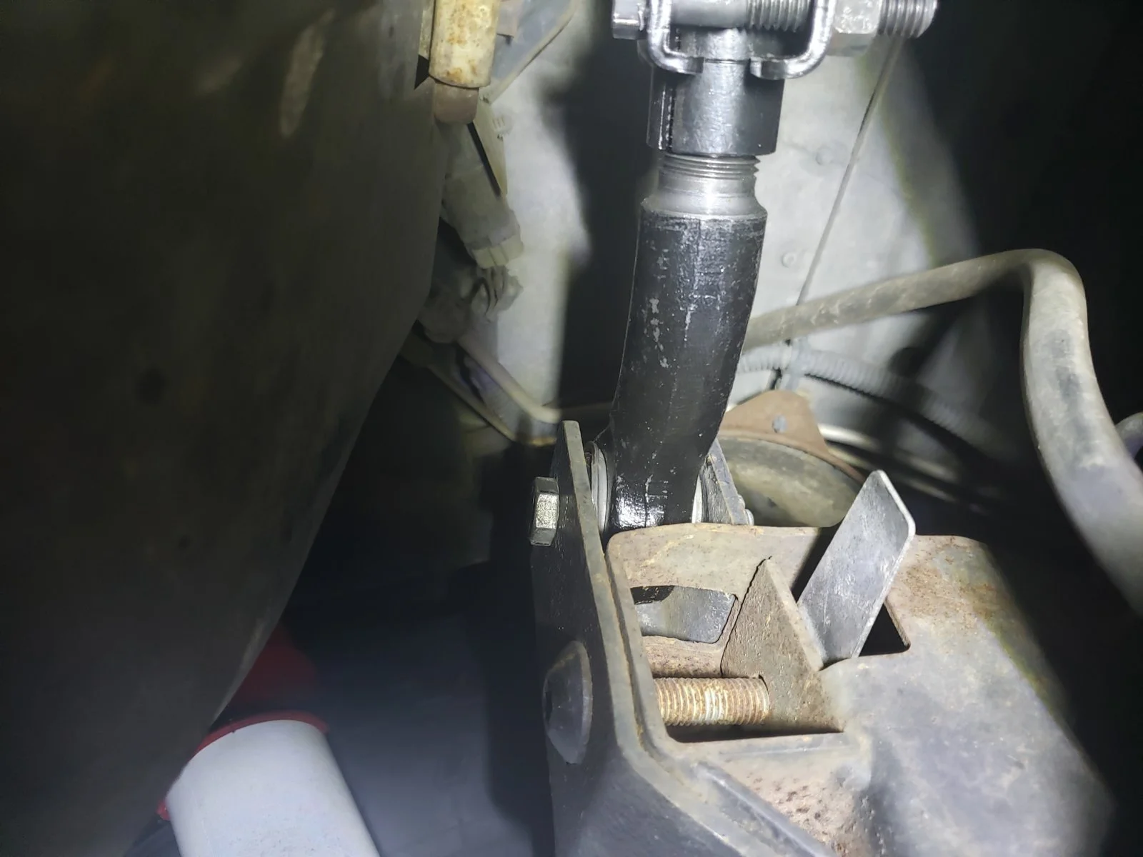

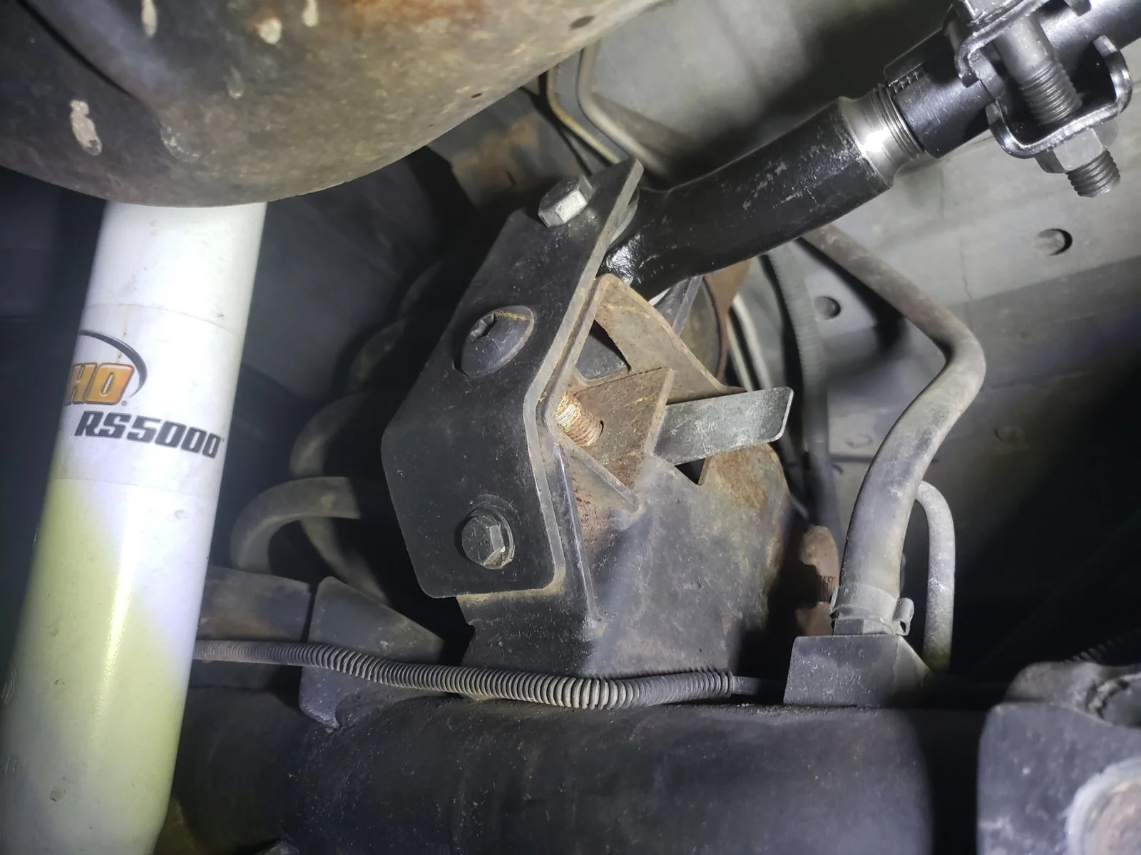

Sweet mother of God I just noticed that the rear has an adjustable track bar with a drop mount too...should I remove the mount or just leave the rear alone?
That is not the rotated one. I would just center the axle and run it for now. You need to figure out what is worn and fix that first to stop the side shifting you have...
