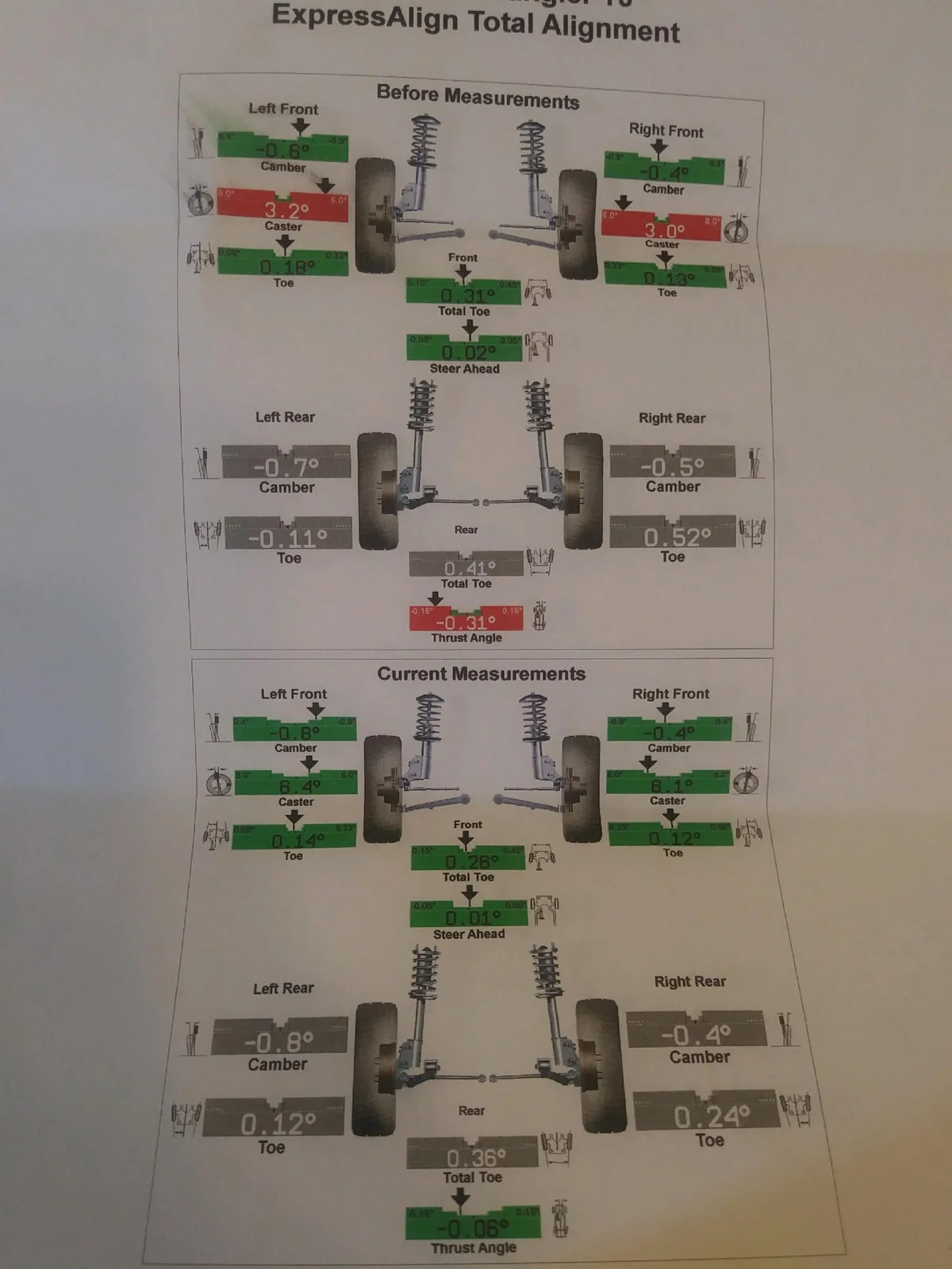

so i spoke to 4wheel parts this morning and they are hesitant to adjust the caster to 5.5-6 because he is claiming that it will throw the pinion angle off and cause lots of drive line vibrations. "i will speak to the shop foreman and see what he can do" was the response i got. i even told them that if the caster does not improve the handling then i would be looking for a quote on new ball joints. idk what to do with this shop :shot:
That is a legitimate concern since increasing the caster angle too much can indeed cause an excessive pinion angle which will cause drivetrain vibrations. Pinion angle definitely and always takes precedence over caster angle.
That is easily handled by simply increasing the caster angle up to the point you get those vibrations and then back the caster angle off just enough to stop the vibrations. This normally gives you sufficient caster angle to restore good steering stability and return-to-center. 4WP should have known to do that which is the time-honored way of successfully handling that issue.
4WP may balk at that suggestion or complain about the extra time it takes but that's only because they are production shops and aren't up for spending more than the absolute minimum amount of time required to get the Jeep off the rack to start on the next job.

got the jeep back from 4wheel parts. they went back and reset the caster for me but in doing so there is major drive line chatter. return to center and bump steer has improved slightly but is still very apparent and difficult to drive confidently on the road. any suggestions?
