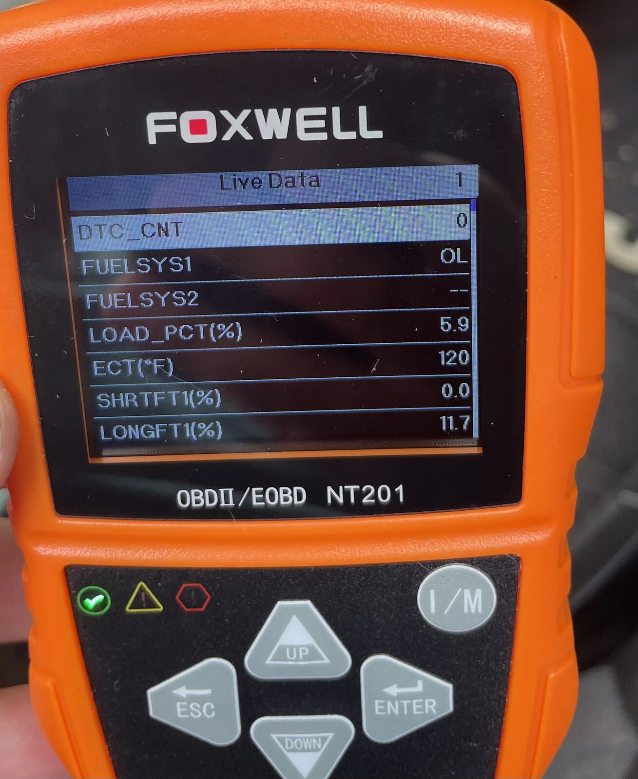

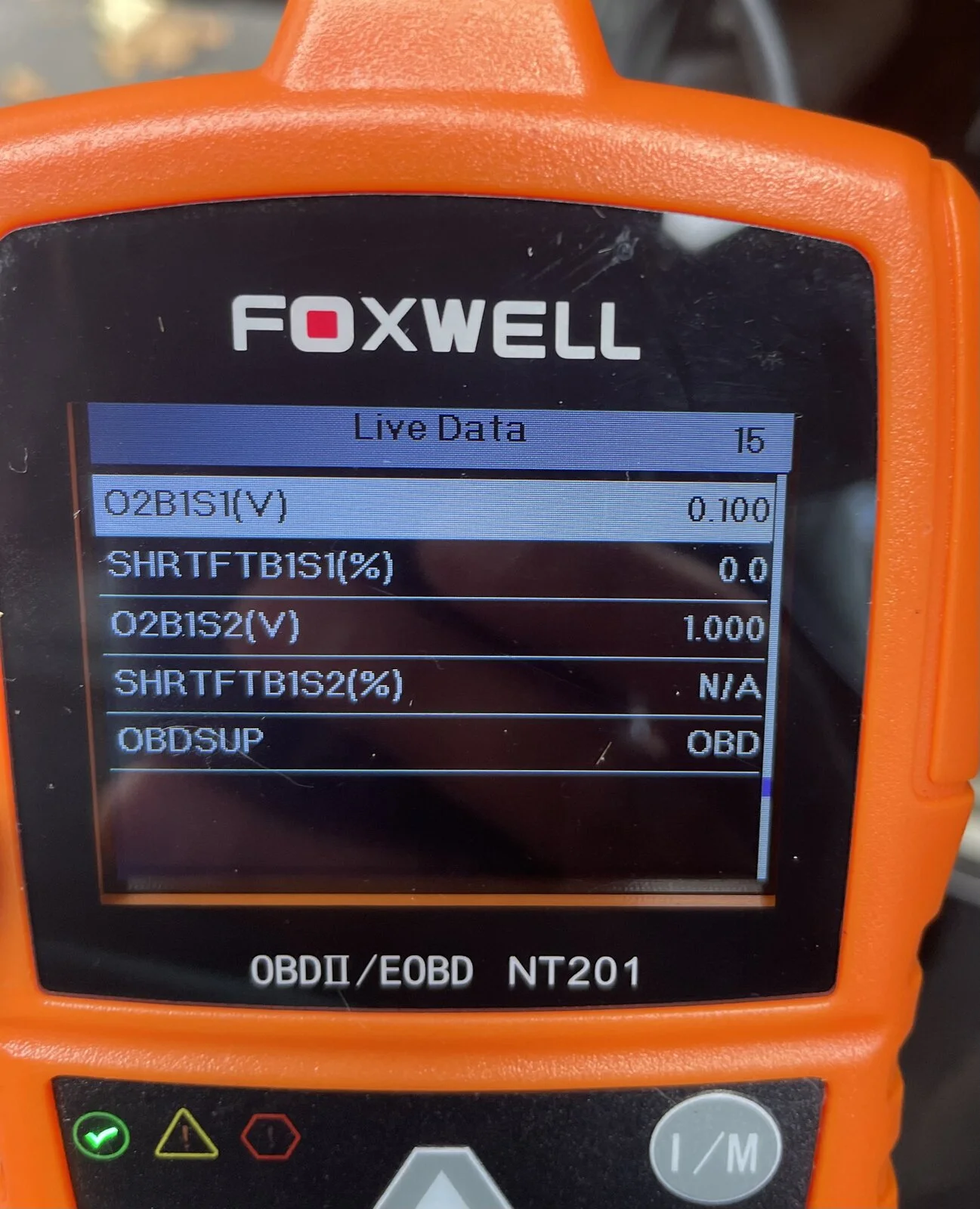

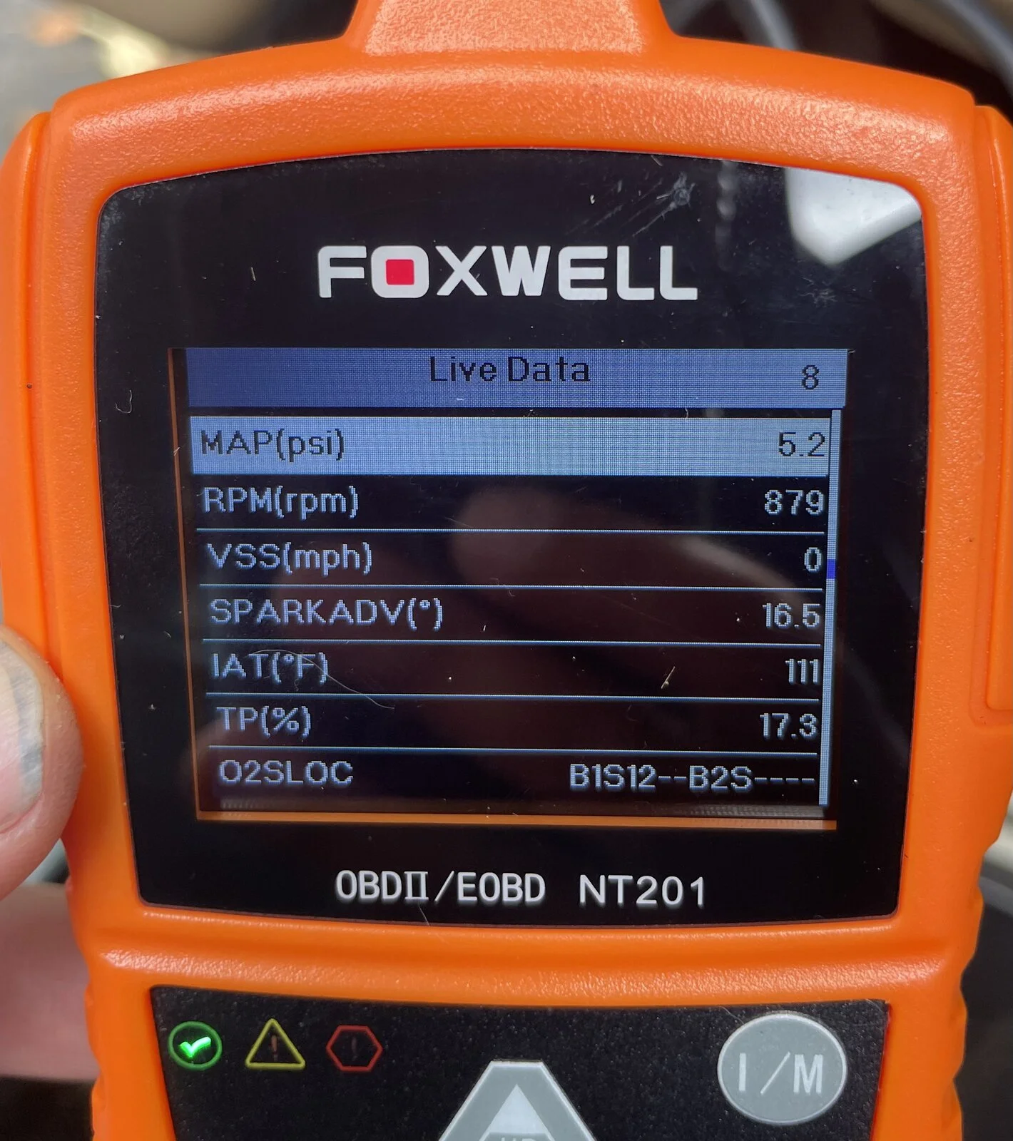

Here's live data I captured on idle:
Your coolant temp is low. Is it fully warmed up during this capture? If not, what does it show after fully warmed up?
a little digging around, found out that 0.9v or higher indicated a bad sensor. S2 is a downstream sensor. its bad again!? i replaced it with NGK a couple of months ago.
A tad over the middle mark
Sounds like it's running hot enough, but what is the actual ECT value after a full warmup?

The o2 reading will not matter you are in open loop the engine is running off set fuel tables not the o2 sensors. Check coolant temp sensor or cooling system to get it up to operating temperature. Once you verify it is going into closed loop then check the map sensor and associated hoses and look for any engine vacuum leaks. Then check o2 sensors. A good check for vacuum leaks is spray some brake or carb cleaner while watching your LFT when it change you are getting close.
