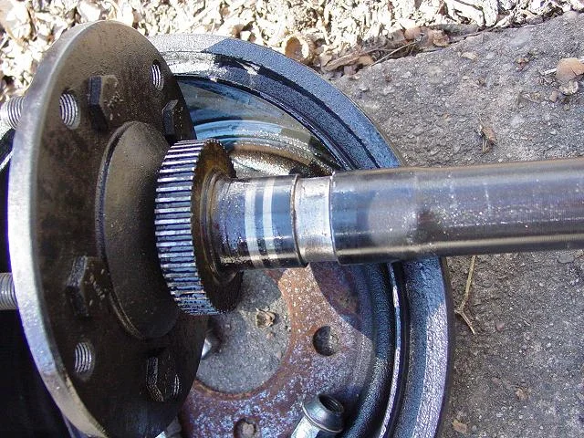

Why are the 1541 shafts better than the chromoly shafts?
Because they have the additional surface hardening that the type of outer bearings in a Dana 35 require. The Dana 35's outer bearings ride directly on the shaft, there is no outer bearing race.
This shows what happened to a 4340 shaft in Dana 35, you can see where the outer bearings wore down through the surface of the 4340 shaft. This doesn't happen with a 1541H shaft which has the proper type of surface hardening.
In other types of axles like a Dana 44, the outer bearings have outer races so the bearings themselves don't ride directly on the axle shaft's surface.

Thank you. I finally saw your post on another thread with this. Awesome info, I've asked a ton of questions on here and appreciate all y'alls knowledge and experience. I've about settled on S35 and now looking at the 1541 shafts. I'll just hammer it till it breaks and go from there lol.

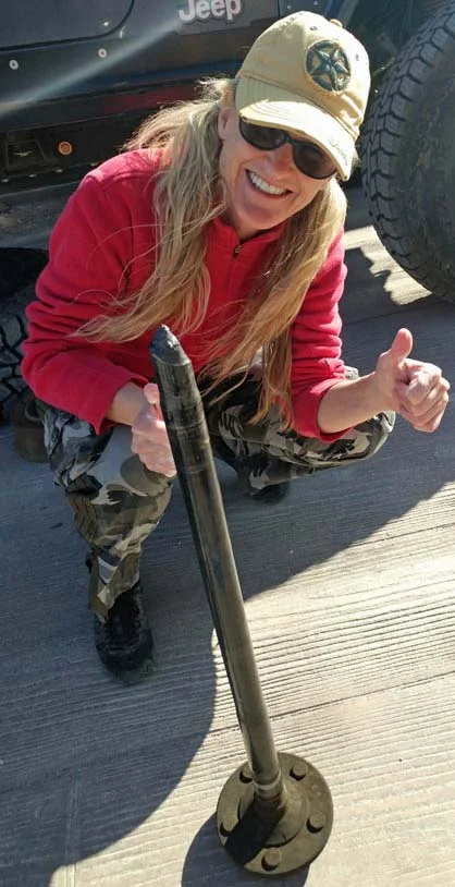

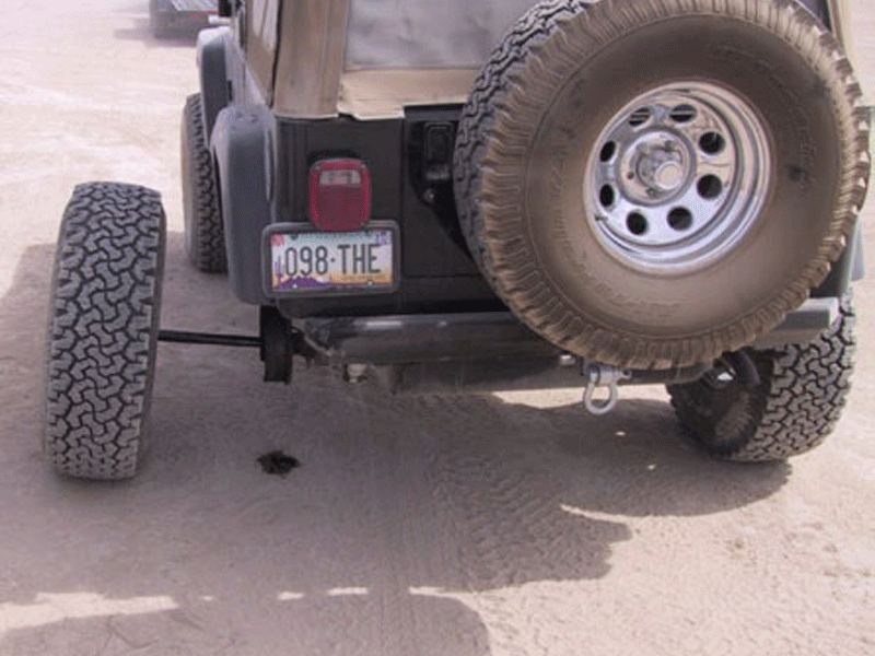

The problem with that is that type of breakage is catastrophic on the trail and you're not driving it until you get a replacement shaft. There are ways to get a Jeep off the trail, like back to camp for repairs, but you can't drive home with a broken axle shaft. Either buy a left and right rear Dana 35 axle shaft and carry them as spares (they are different lengths) or upgrade the Dana 35 with a Super 35 kit before it breaks.
This is what happened to a friend of mine while we were wheeling a couple years ago. I always thought she had a Dana 44 in the rear or I would have had her drive my Jeep instead of hers on the trail we were on. We weren't able to fix it until the next day, after a 150 mile round trip to get her a replacement shaft.
The first photo shows how you have to hold the wheel in once the shaft breaks, otherwise the wheel will slide out of the axle housing as shown in the last photo. The second shows her the next day after we finished getting her Jeep drivable again. She wasn't smiling much before then.
