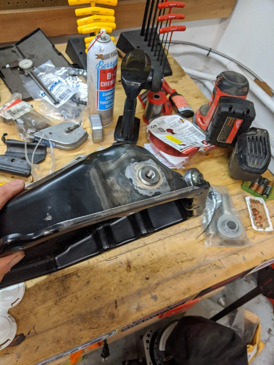

It is easily solved. Just not without some effort and care. I'd whip out the grinder with a wire wheel, clean the heads, weld nuts to all the heads, heat kills the locktite, nut gives me a handle for the other end. Take me about 6 minutes to get it off or about the same amount of time as it took me to do it.Now I want to see if he can solve this Rubik’s Cube![]()
