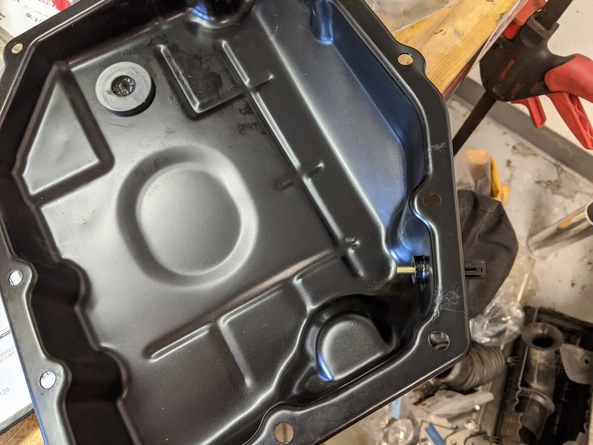

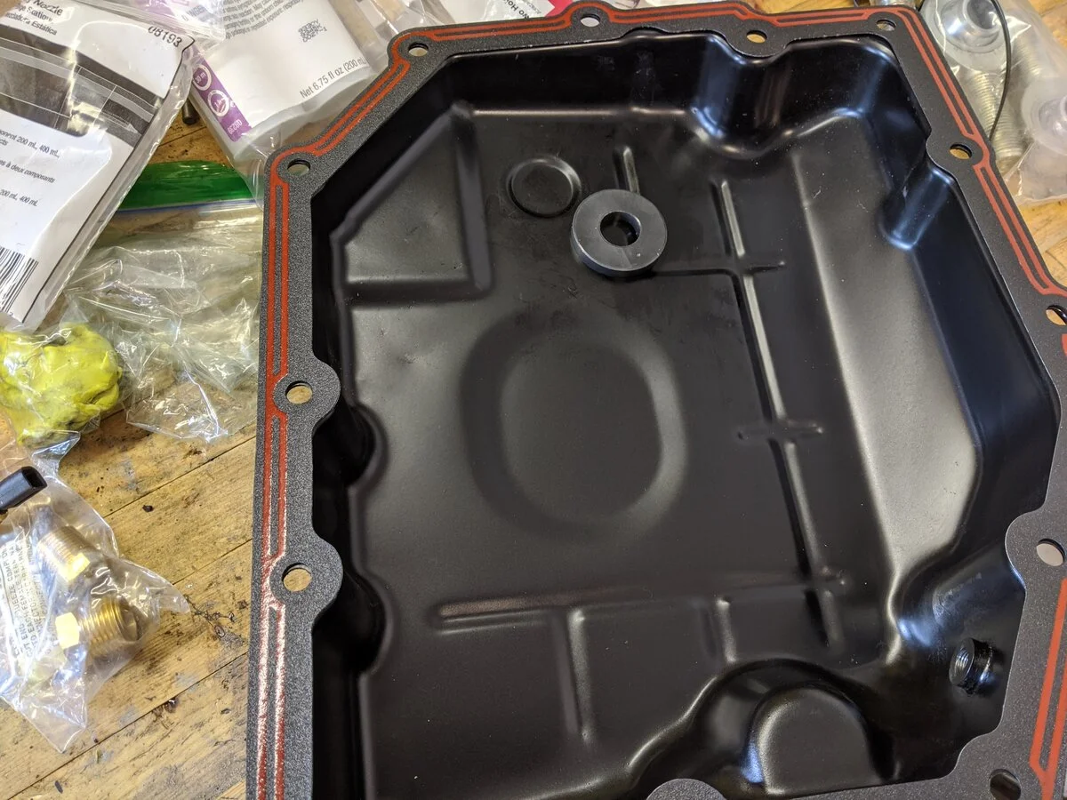

Duplicate the location and put a dab of RTV in the middle so it can't slide around.I appreciate that reminder! Interesting this new pan doesn't have the inside dimple dlthat traps the magnet like the old pan did. And the magnet in the other pan is too large to sit in the recessed portion of this pan. Is there a different magnet I should order? Here's picture of new pan and old magnet.
SONOFABISCUIT ya they must have sent me the 06 version. I put my 04 data in rock auto. The annoying thing is now I have to wait for the rtv to cure. But got the gauge wired and installed and the wires ran for the pan. Will button up tomorrow. This is why I love 3 day weekends.Is that an 06 pan? There is a different magnet for those pans. 68207789AA Not worth ordering and waiting for though.
You don't have to wait. The RTV is just to keep it located if the pan gets bumped on the trail. It won't move otherwise. Get that shit done and quit fucking off.SONOFABISCUIT ya they must have sent me the 06 version. I put my 04 data in rock auto. The annoying thing is now I have to wait for the rtv to cure. But got the gauge wired and installed and the wires ran for the pan. Will button up tomorrow. This is why I love 3 day weekends.

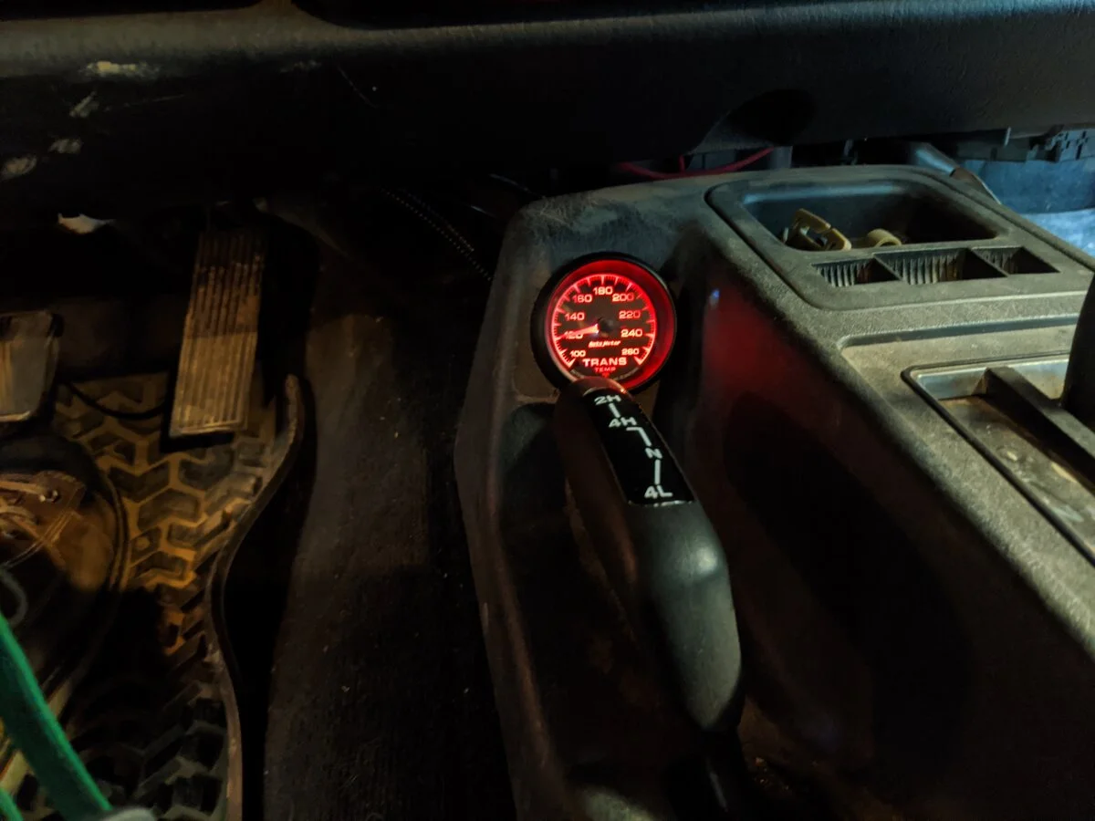

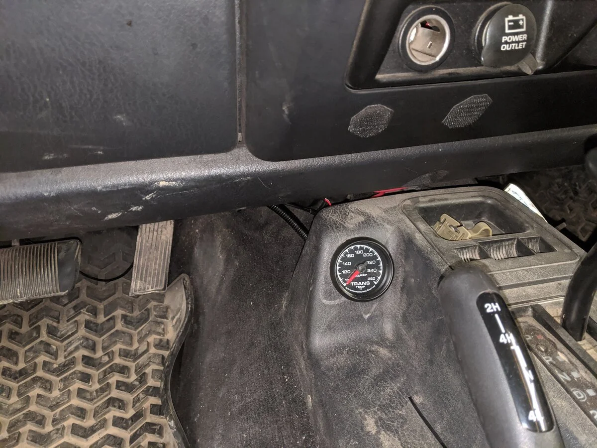

I took it out for a drive down the highway last night, hit some hills with TC unlocked and man i couldn't get it go much above 120°F. Is the gauge incorrect? What are people seeing in the sump for normal operating temps? 100-120Deg? seems way too low.
Factory radiator cooler?
With my factory radiator cooler, big aftermarket cooler, mid-60F weather, 5.38 gears, 37s, and driving like an idiot doing repeated hard pulls with the supercharger I haven't seen above 127F on my after cooler line over 1300 miles. (yes, I should move it to the pan)
