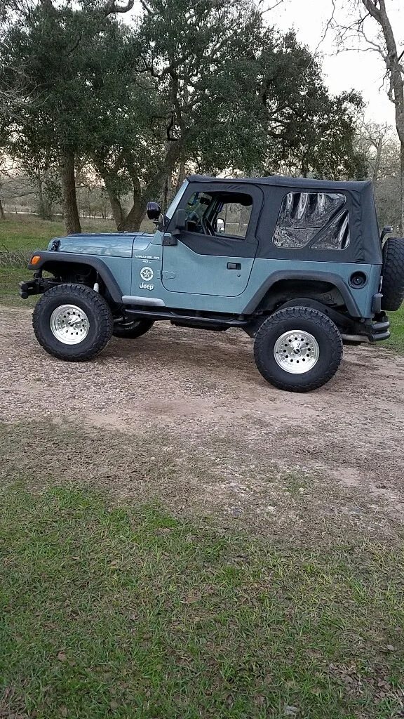

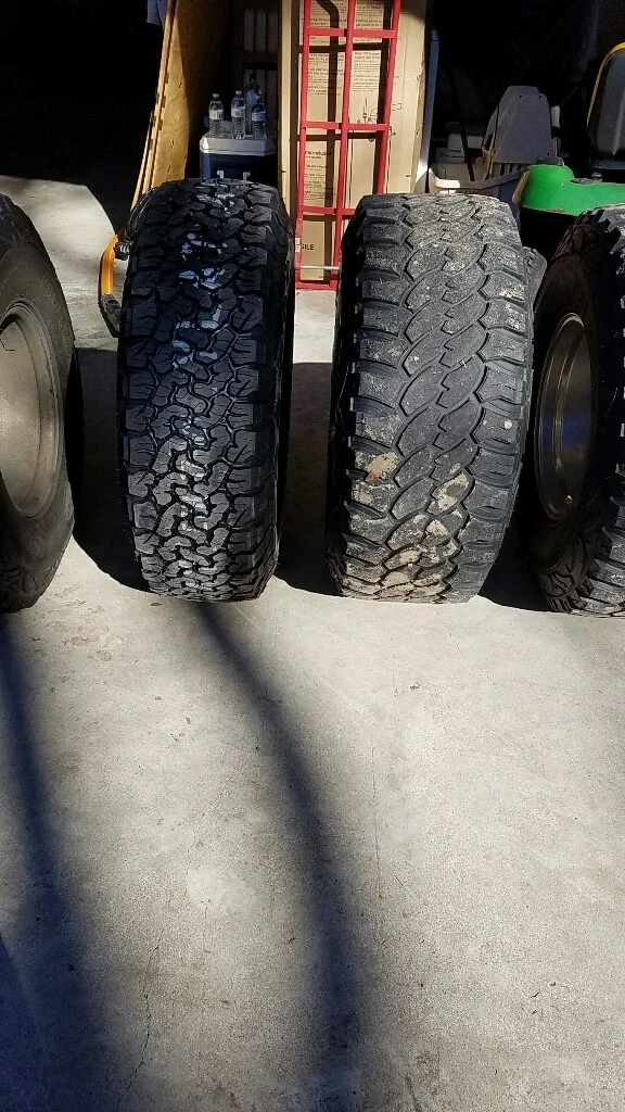

Put my new tires and wheels on today. Had to put my stock flares back on. 33x10.5 KO2s. 15x8 wheels. I can't believe how much better the ride is and quiet as hell.
HA! Yep, this is why I will never own MT tires again on a street driven vehicle. Made that mistake on my old XJ. Once I switched to AT tires it was amazing how much better (and quieter) the ride was.
Reactions: Kevin E
Oh yeah, those are much narrower too, which will also make for better handling.

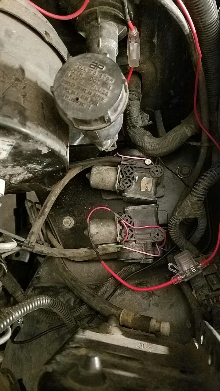

Oh yeah almost forgot I also got my spotlights going g again with a new switch and mounted my air compressors for lockers. Small town and no one carries the right size of hose for air so need that. I need to figure out where my switches will go. Not a big fan of the stock ones.
Once you get it all setup and working, I'm sure you'll love the lockers.
I rarely ever need mine as I find I can get out of most situations before having to engage them. However, the piece of mind just knowing they are there if I do need them, well that's priceless.
There in! Front works great. The rear locker would but I bought longer hose and it doesn't seal. It's thinner walled so not as tight at axle. I am looking for OEM hose now or something thicker. Inside diameter is 5/32 not sure on Wall thickness. All the hard stuff is done anyway.
Awesome man, I'll bet it's nice to finally have the lockers working.
Thanks Chris. It only took a year and a half to get to it but yes I'm real glad they're in. Might not need them to much but like you said earlier "gives you piece of mind knowing they're there".
