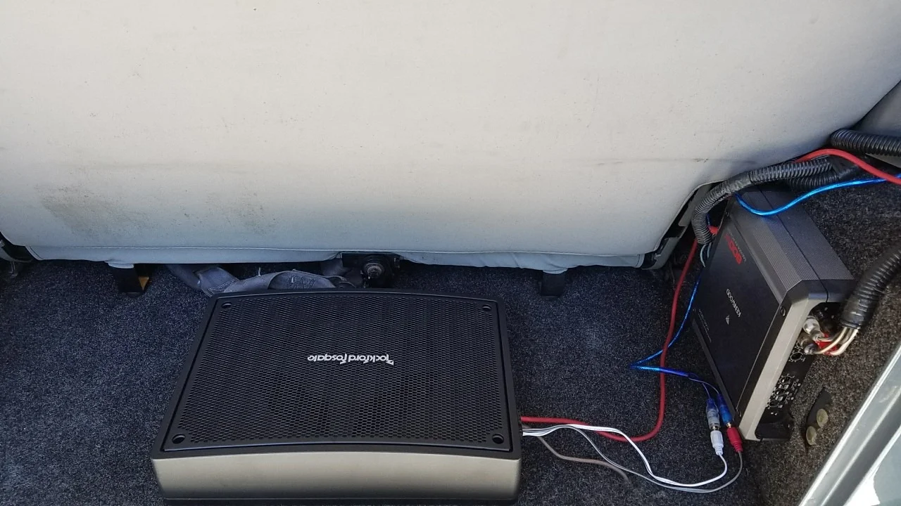

Got my sub/amp in. WOW! Major improvement. Stereo complete.

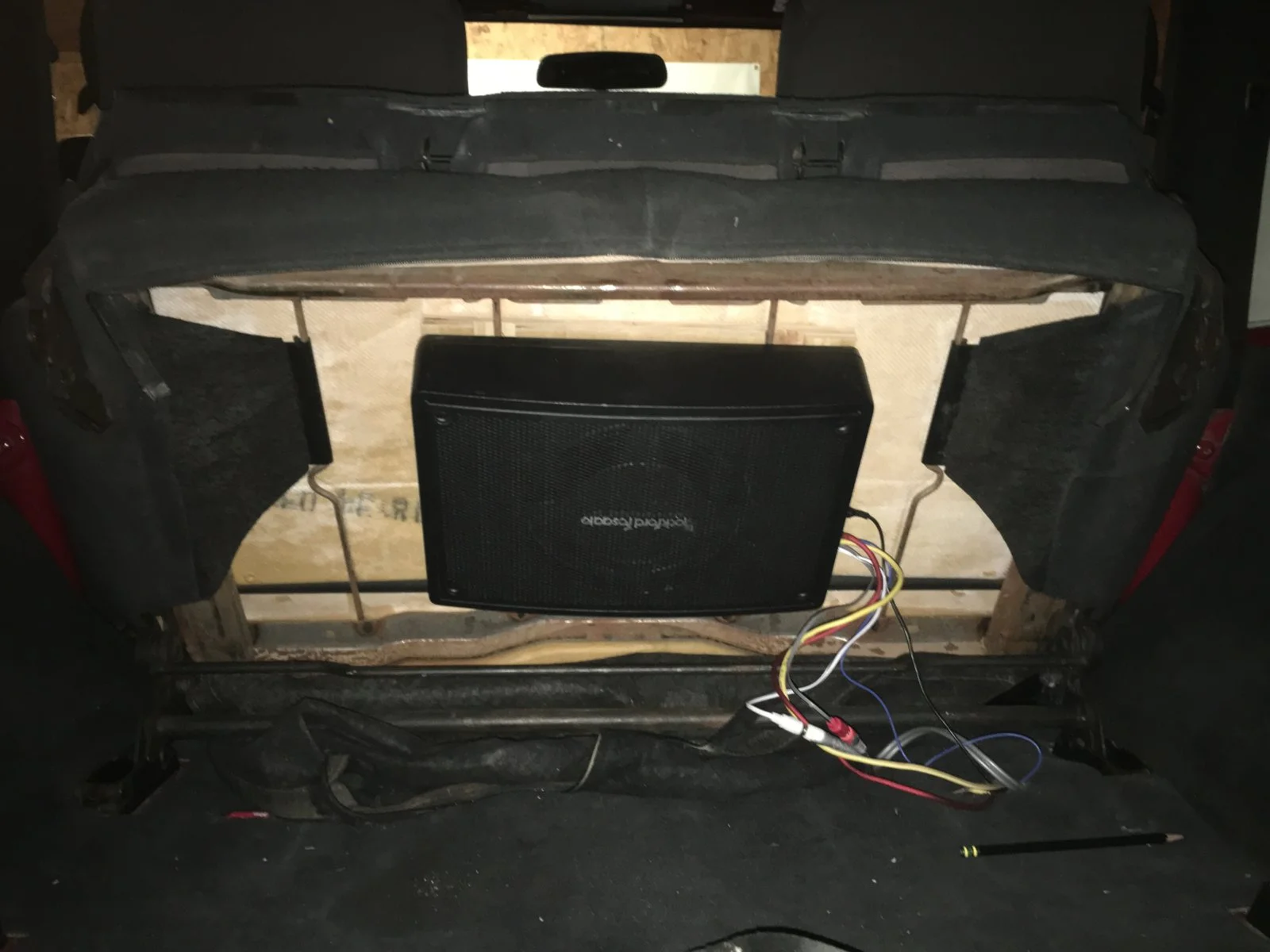

Awesome, no, I mounted on underside of rear seat. With seat risers you can possibly mount under front seat. I didn't have them then, do now, but HAPPY! It does sound awesome, doesn't it! Major improvement. It's totally in the league of the Kicker without the $300!price tag.
Absolutely love it. Thanks for the help.
