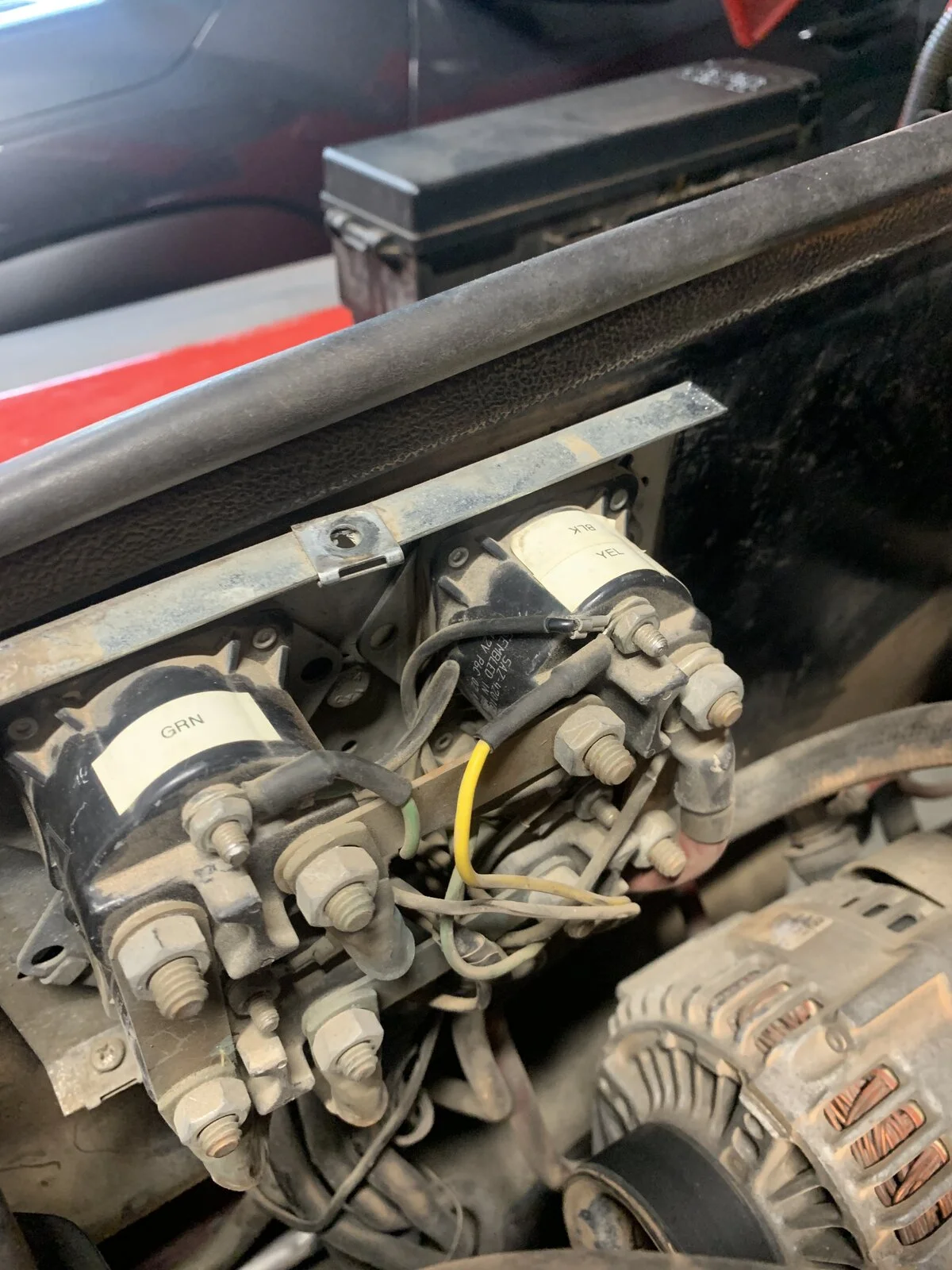

What I think you're calling fuses in your photo are actually the relays aka solenoids that control the winch motor. :)

I wouldn’t mind going back to stock but would need to rewire the warm winch setup (including new wires) and find a place for what I think are the fuses for the warn system. Currently mounted to the sheet metal CAI divider

Like Jerry said those items in your picture are the solenoids that control the in & out functions of your winch. It wouldn't be that hard to either move them or remount the control box onto the winch. They are already mounted onto the housing backing plate. the cover is all that is missing.

Depending on which winch you have the cover could look like this.
https://www.warn.com/winch-solenoid-housing-28461
Or like this one.
https://www.warn.com/service-part-control-pack-cover-vr-evo-104222
So if you want to move the solenoid pack you can and then install a stock air cleaner.
