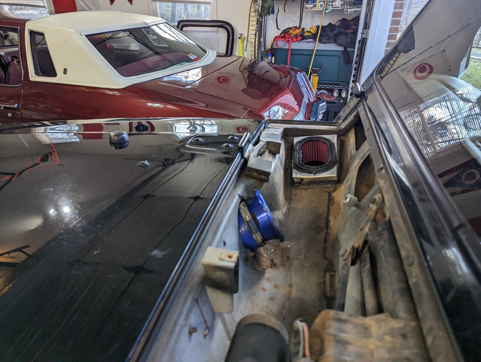

When I traded my ram air for a stock air filter system, it came with a K&n filter in it (replaced with WIX)… I coincidentally kept the filter for whatever reason but when I opened up the cowl to wash out the drain I realized the stock tj air filter perfectly sticks to the air intake (on older models without the additional snorkel thing) so I just stuck the K&n there and boom, no more dust, I can just wash it off once a year, and it doesn’t matter if it gets a bit of water on it during hard rain.

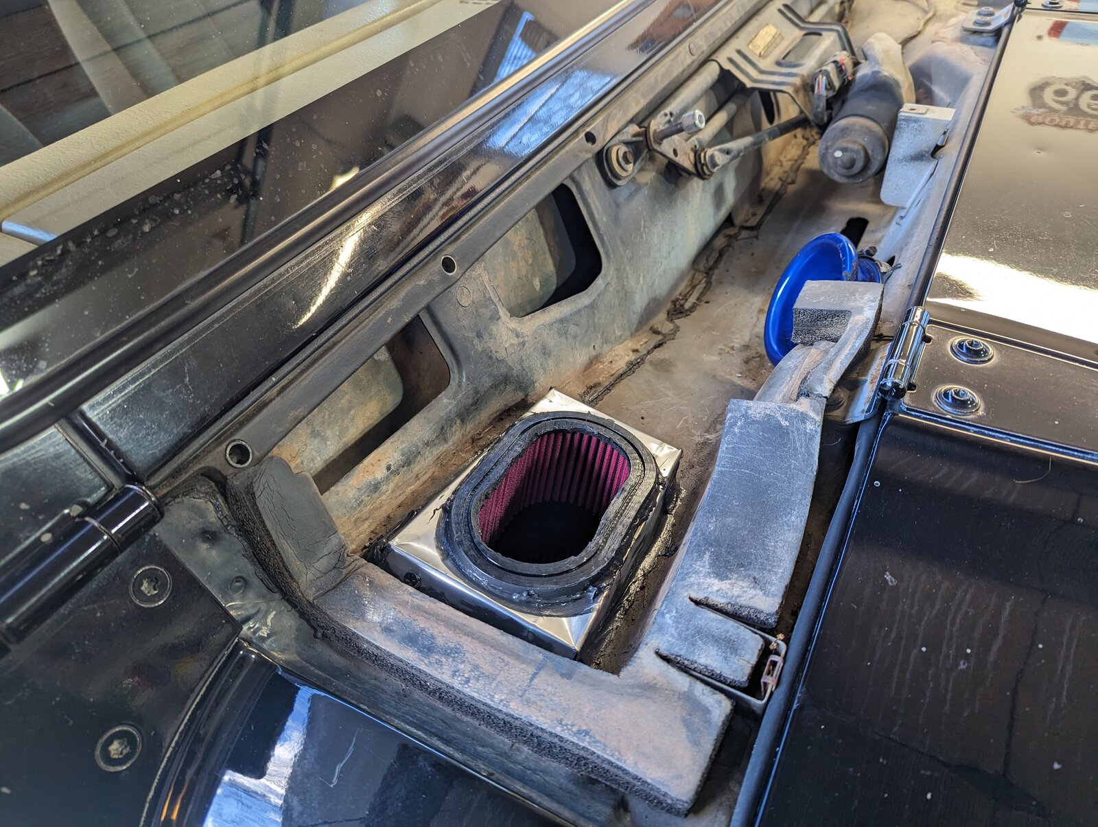

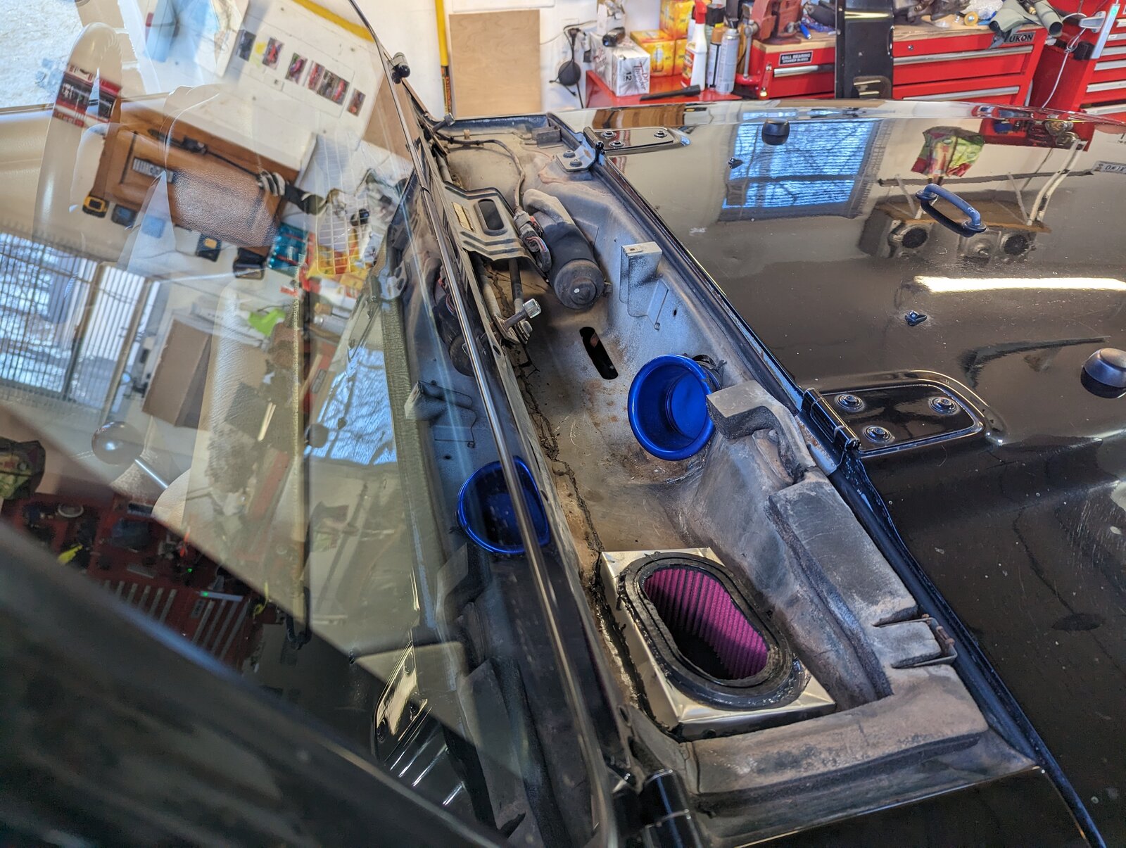

Still drying, but got mine in. Hopefully it doesn't restrict flow too much. I got a little happy with the silicone and forgot to test the air on full blast stock style and then putting the filter in place to see how much it restricted it. Guess I'll just have to guesstimate. I'm also going to figure out some kind of sound baffle to reduce cabin noise from the intake opening being right there.

77 Cutlass.??
'75. Good eye. I don't think there were any differences you'd be able to see in that pic between a '75 and a '77 besides maybe the paint color. It was my grandpa's.
How about the cheap spun glass HVAC filters, those flow pretty freely. They wouldn't catch as much dust but probably a noticeable amount. Can't restrict airflow too much in the Summer without the evaporator freezing.

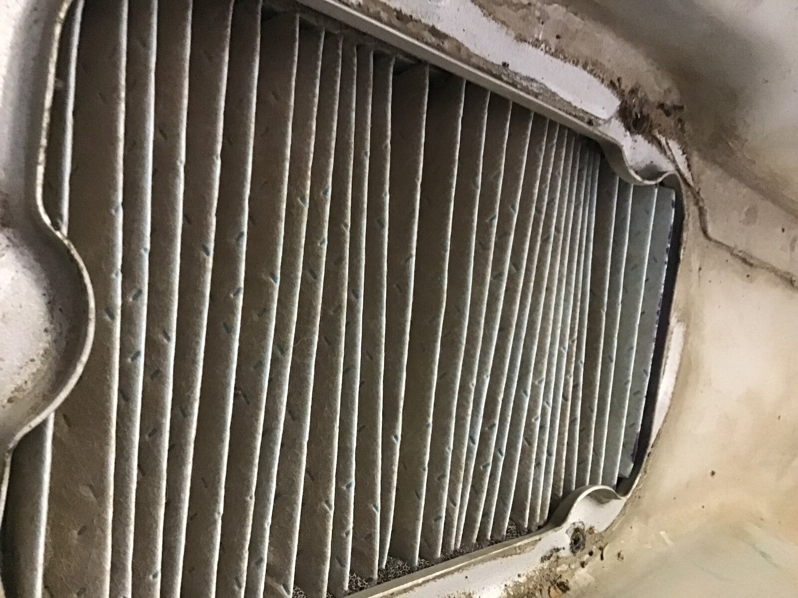

Quick followup for science 🤓🤓.
This is after about 1,600 miles and 10 months (although it isn’t driven much at all from Nov-April). I could tell the filter was saturated on the last few trips.

Dust. The filter is pretty well protected from water if the drain is clear.

That's awesome! And it's nice knowing that the filter causes a negligible (in my book) difference
