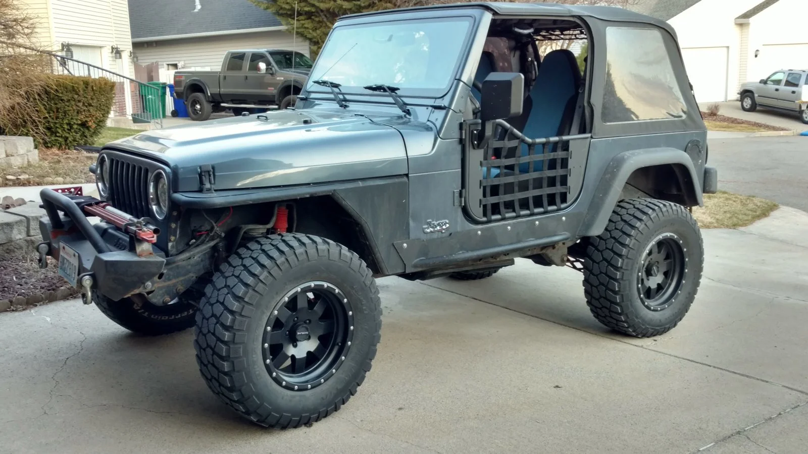

I just bought an 02 earlier this winter & have been enjoying going thru the mechanicals, adding a few mods, driving it to work occasionally & taking it out wheelin on the weekends.
I couldn't cover up those plaid seats soon enough. I guess it's just taste. They are in good shape, just dated IMO. A new set of tweed seat covers from Caltrends.com will protect them for a long time to come.
Overall it seems to be in descent shape, although the previous owner has replaced the rear diff, gears & transfer case in it's 115k mile life. And it lived it's entire life between Washington & Colorado so not a lick of rust underneath.

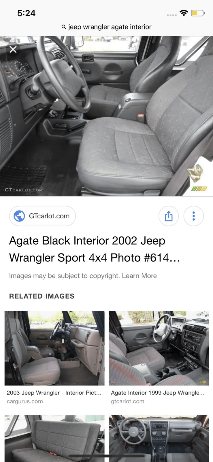

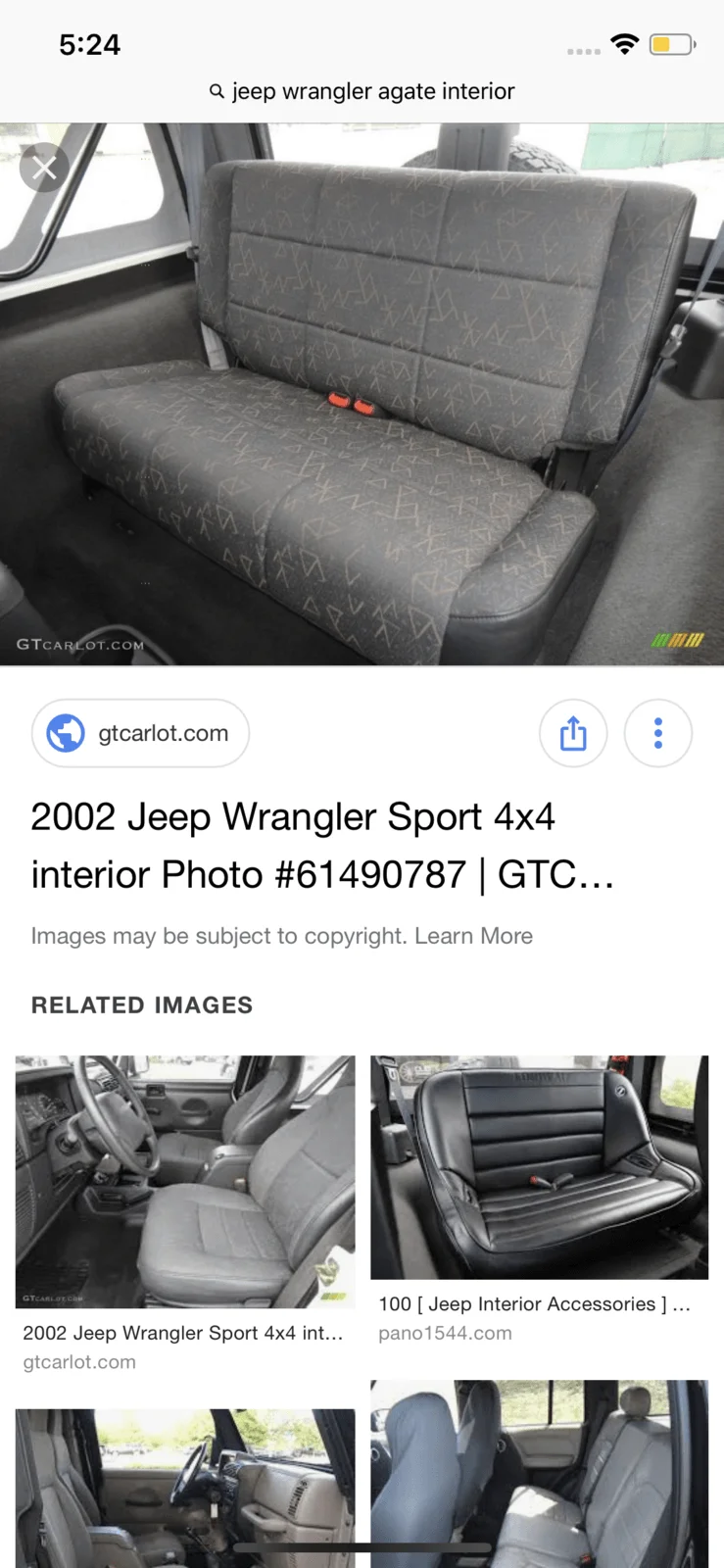

This is awesome!! I have a s197 mustang and I’ve been on the s197 forums and none have given me this much detail!! I really appreciate that a lot! But any word on those seats as far as anyone knows? I don’t want seat covers but I really would like those 01-02 seats I’ll post a pic if anyone knows and there’s 2 I’m currently looking at that one looks super clean and I’m not sure if I should commit to it or wait longer till I get closer to coming home? I have about 2-3 months left and I really don’t want to not have a vehicle at all. But I’ve never driven or even drove in a wrangler but they just seem like they last and a fun project and as close to a truck as I can get.

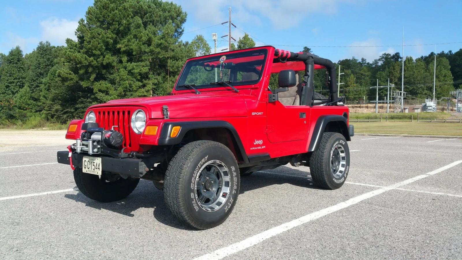

The TJs are actually comfortable to drive and ride in....well mine is....it has a 1.75 inch lift ...comfortable h&r german coils and bilstein shocks. Nice comfomfortable ride.
I dynamatted the interior to keep noise to a minimum. New exhaust from cats to the tail with oem quiet muffler.
Its not my dd but i can drive it all weekend long to the beach, mountains etc and not be completely worn out.
Its quite capable with a winch/synthetic and locked front and back.

Lol @ the seat pattern requirement. Gotta love the simple things in life.
I am pretty sure the seats are interchangeable, so if you do find a solid tj that is off year.. maybe you can source the seats from a yard or someone parting out his jeep.
