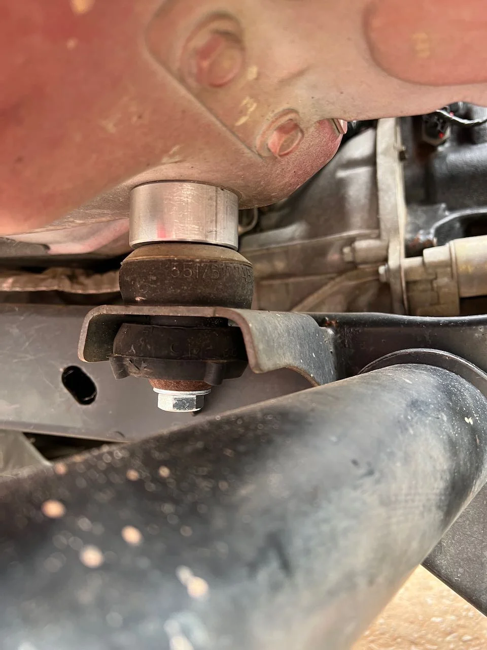

Whether you need one varies. It's best to look at you steering shaft, where it comes out of the firewall.
Before the riser and after

Doing this also gives you a chance to check the stock steering pillow block and grease it.

I pulled the steering shaft bearing bracket out cut it in the middle and welded a 1” piece of metal 14 gauge or 1/8”. Just easier than ordering and waiting. On the transfer case shifter I have a rubicrawler installed so both shifters are cable already.
