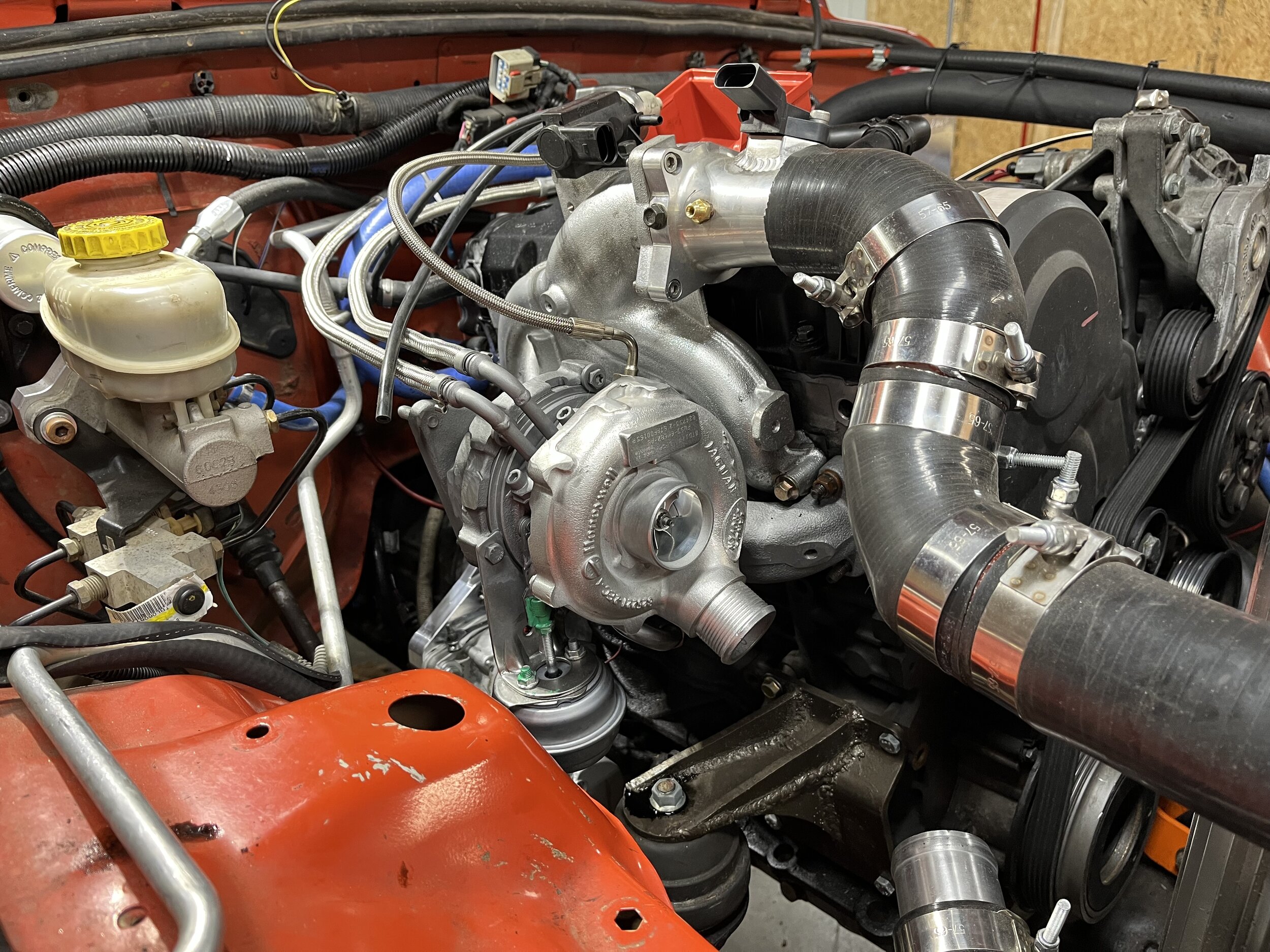

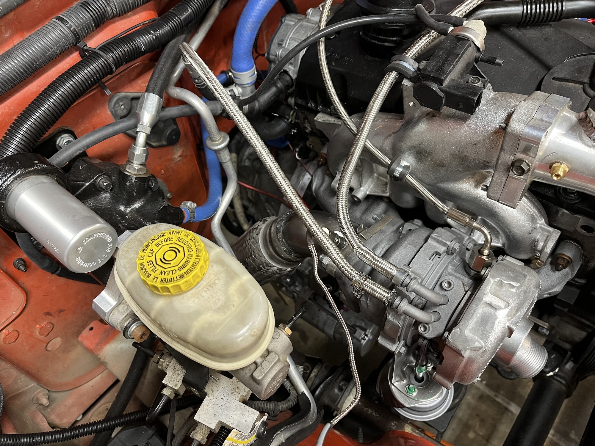

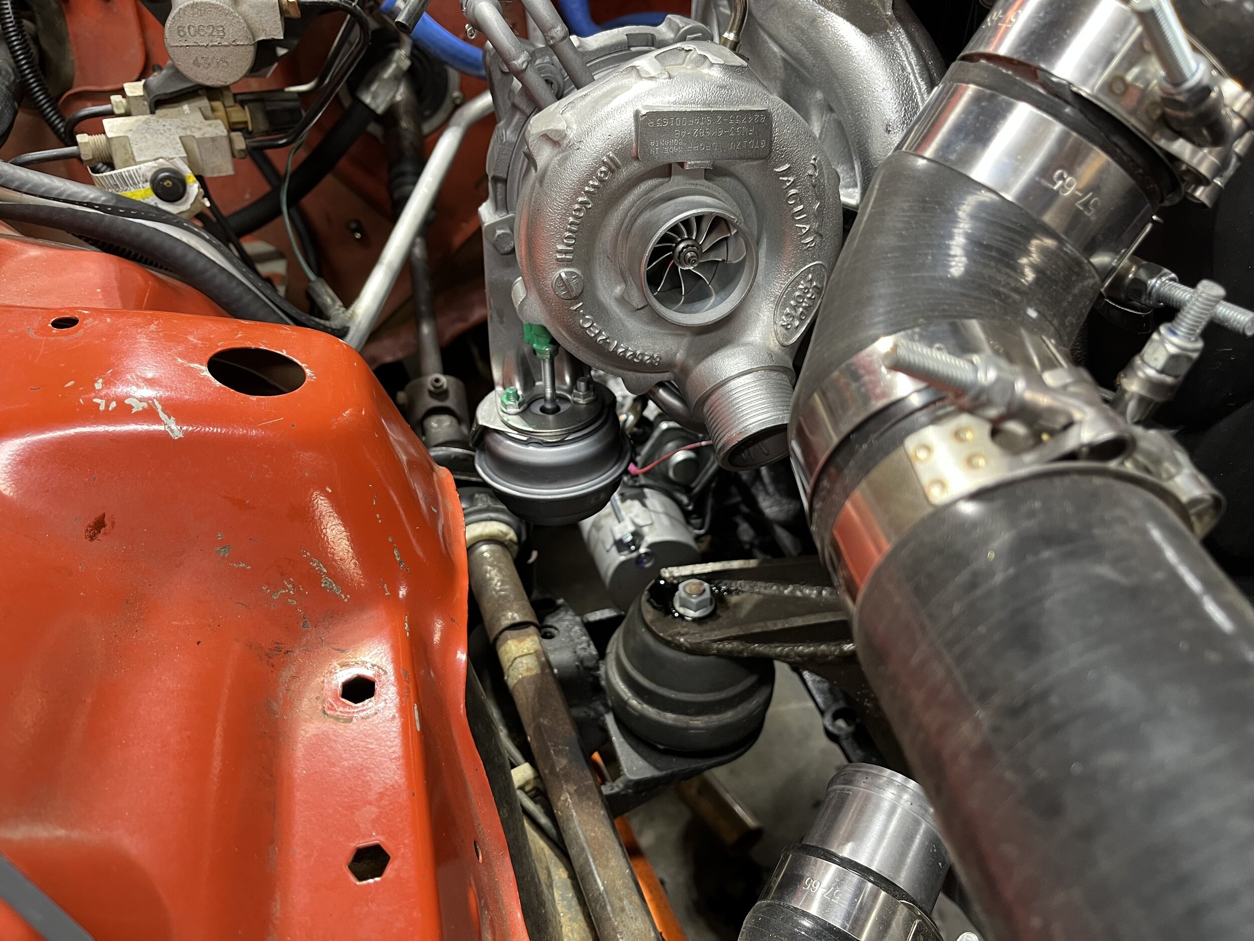

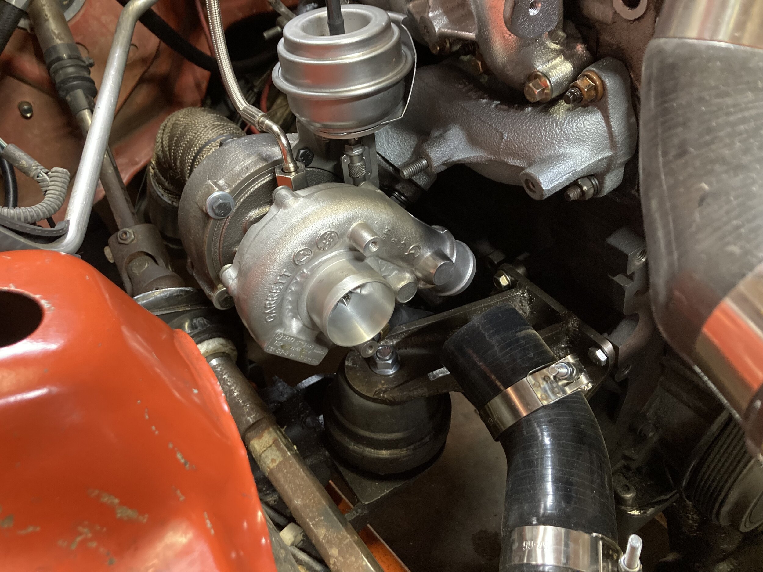

For a while now I've known that my turbo setup was too close to the steering components in my BEW TDI powered TJ Wrangler. With recommendations from people on where and what turbo and tune combination to get, I decided to upgrade my turbo setup from a GT1749 that was on my swap to a GTD1752vrk that has been custom welded to an exhaust manifold so that the turbo is higher up and further forward in my engine bay of my TJ Wrangler.
Old GT1749 Turbo setup:
New GTD1752vrk setup:
I've actually had this turbo setup for about 6 months now, but with the weather being too hot to work in my shop and the fact that I've been waiting on a few transmission parts to come in, I decided to go ahead and install this new turbo setup that I bought from https://en.powertdi.pl/series-gtd. The turbo I was running, a GT1749, was a first generation series of turbo, where as this GTD1752vrk is a 5th generation of turbo, basically it flows better, spools faster, and gets heat out of the system fast as well, all around it's just a newer version of the turbo I was running but with lastest turbo technology.

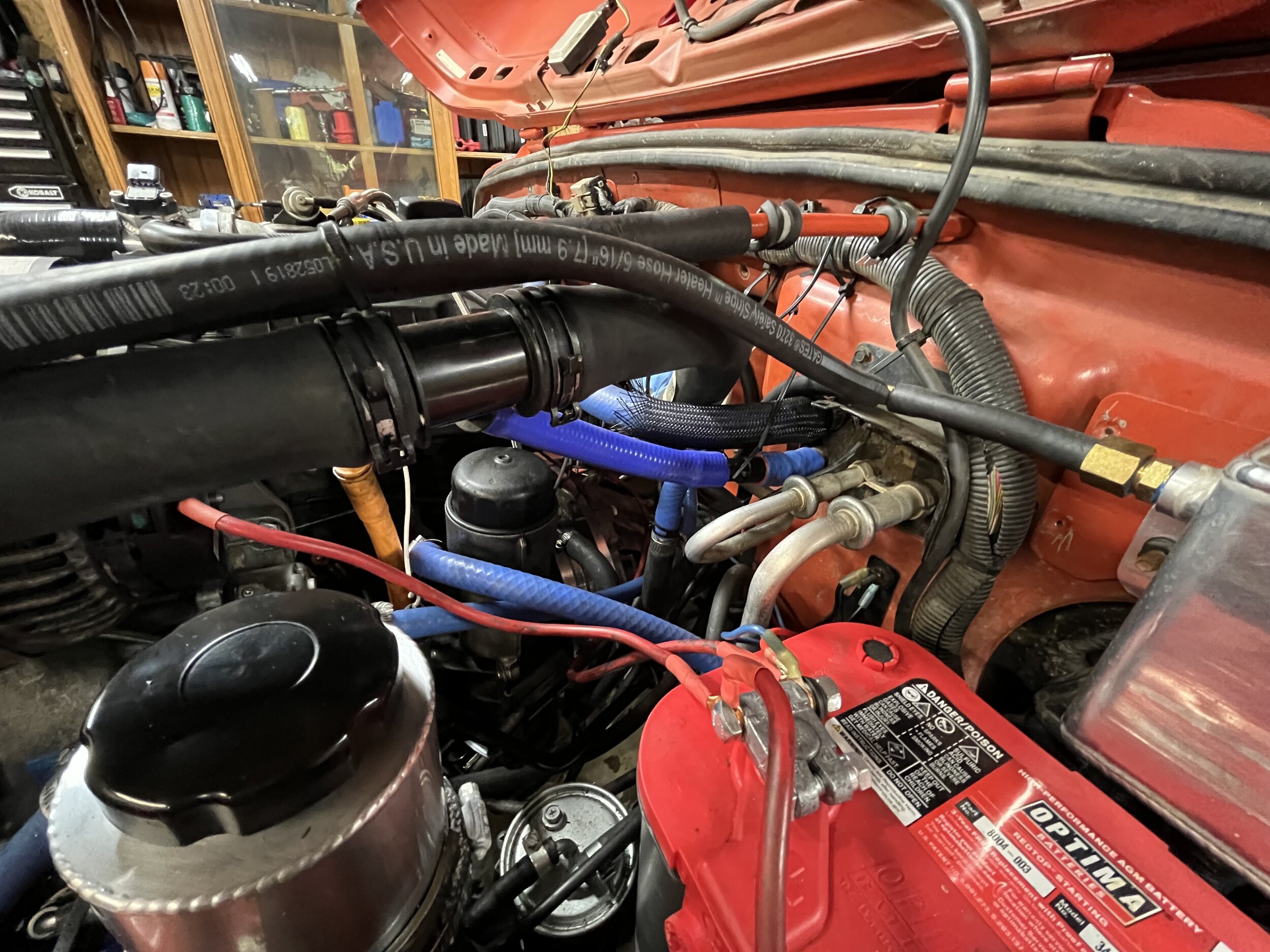

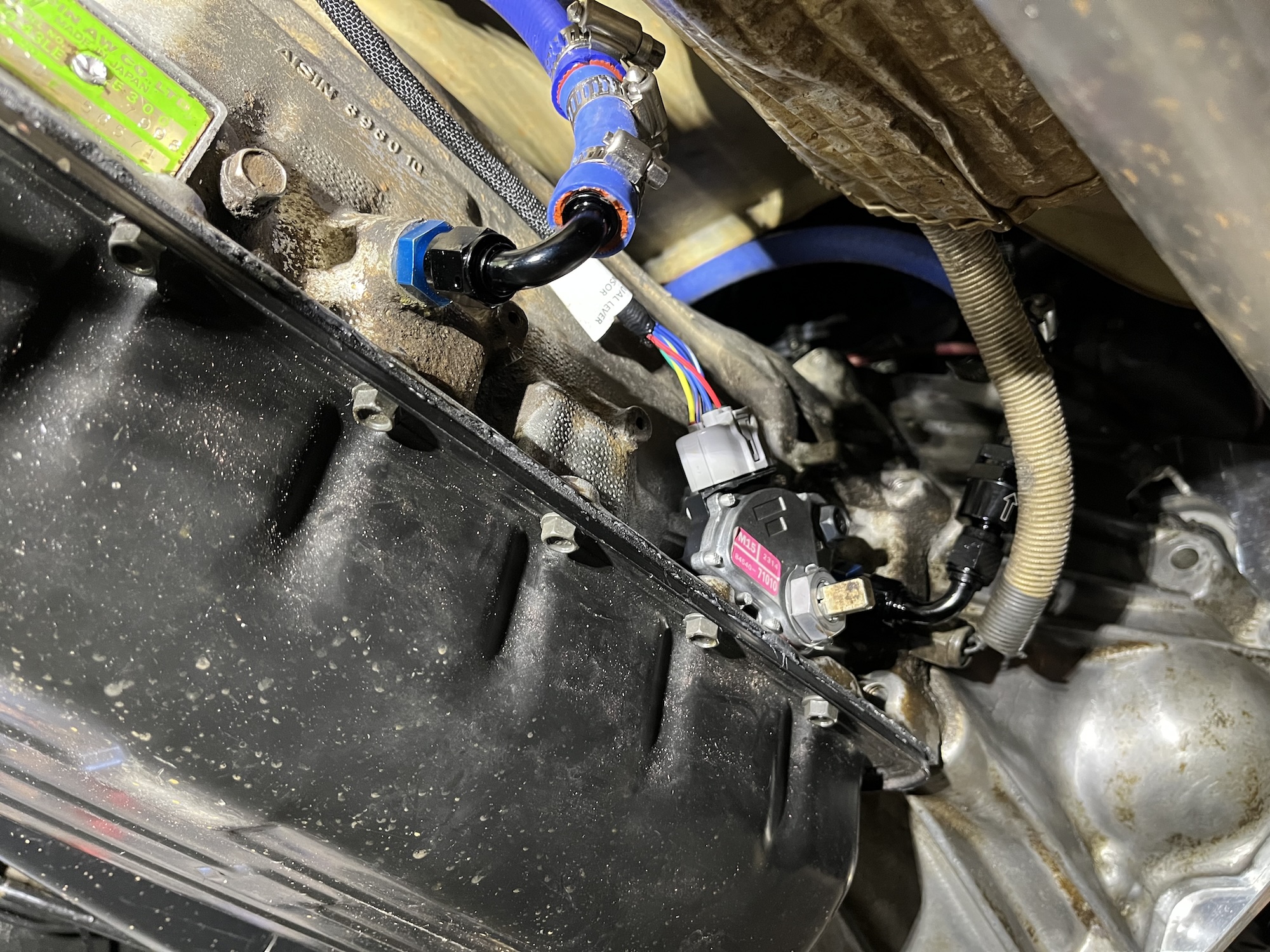

The one main difference between this turbo and the one I had been running is that this turbo's center section is water cooled. This turned out to be a blessing because when I went to figure out how to route the water lines into my cooling loop I realized I had a dead head in my original cooling loop setup on my TDI swap. I has pushing both hot and cold coolant into both outlets of my heater core. This actually explains so many issues I was running into with the cooling system that I wasn't able to figure out last year.
So after installing the GTD1752vrk turbo, I spent time redoing all my cooling system lines to make sure that coolant would always be flowing in a loop, which pretty much just involved buy random hoses from various parts stores that had both Y and T hose joiner pieces and using the molded sections of hoses to tidy up the abundance of cooling hoses that I'm now having to run in my engine bay.
So far everything is fitting well, I have the cooling and oil system sorted out, next I'll be working on fabricating a new down pipe and connecting it to my exhaust system as well.
