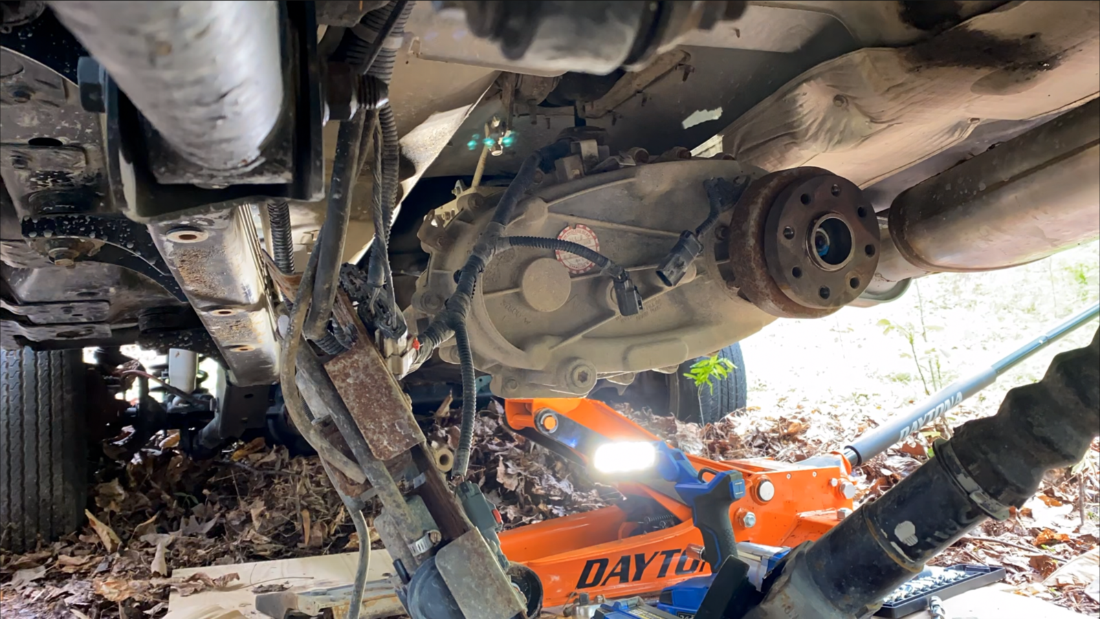

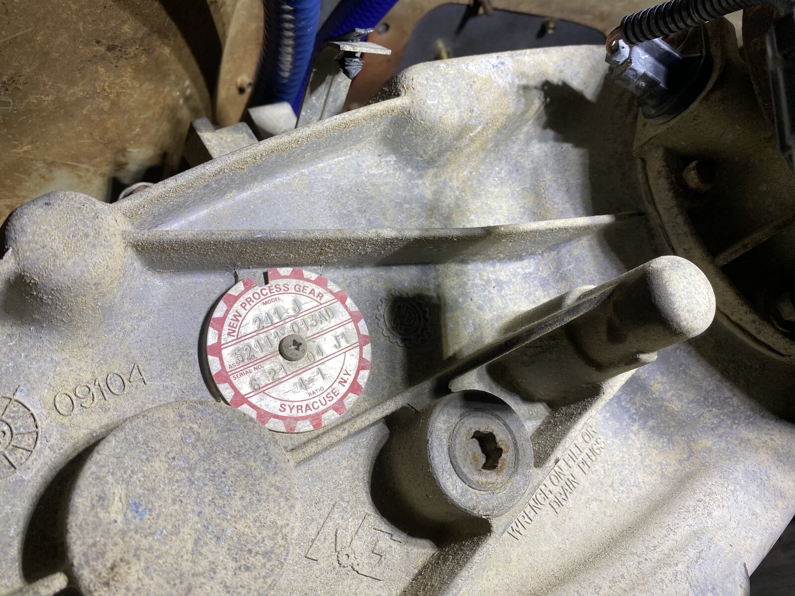

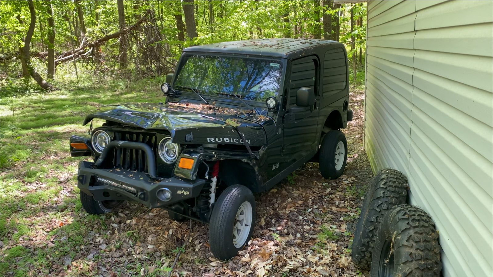

In January of this year, I purchased a wrecked 2004 TJ Rubicon which I plan on using several parts for my Right Hand Drive TJ Wrangler, specifically the axles and transfer case. For now, I'm just focusing on the transfer case as swapping the axles isn't going to be a bolt-in swap because of the different bracket locations on the axles between the Left Hand Drive and Right Hand Drive versions of the TJ.

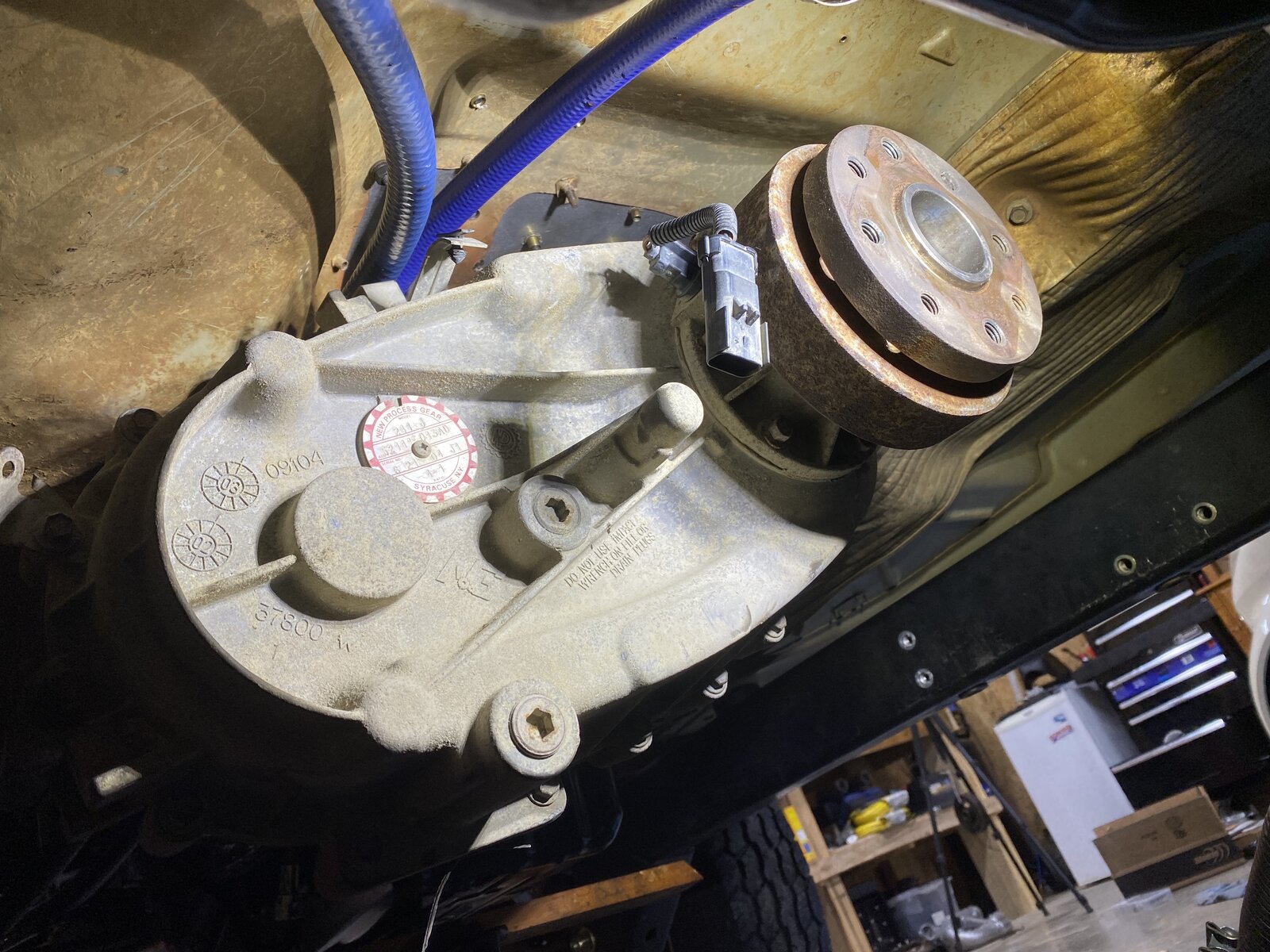

Pulling the NP241OR wasn't too difficult thankfully though getting the Rubicon up onto vehicle ramps so I had enough room to do the work was rather challenging. Once I got the Rubicon transfer case out and went to test fit it into my TJ Wrangler.
I quickly realized just how much bigger the NP241OR transfer case is compared to the NP231. I can lift an NP231 off my chest and deadlift that transfer case into place, but the NP241OR is big enough that I wasn't going to risk it. I ended up having to use a clocking ring to tilt the NP241OR down 5° so that I will have room to lift the transmission and transfer case where I want my driveline to go.

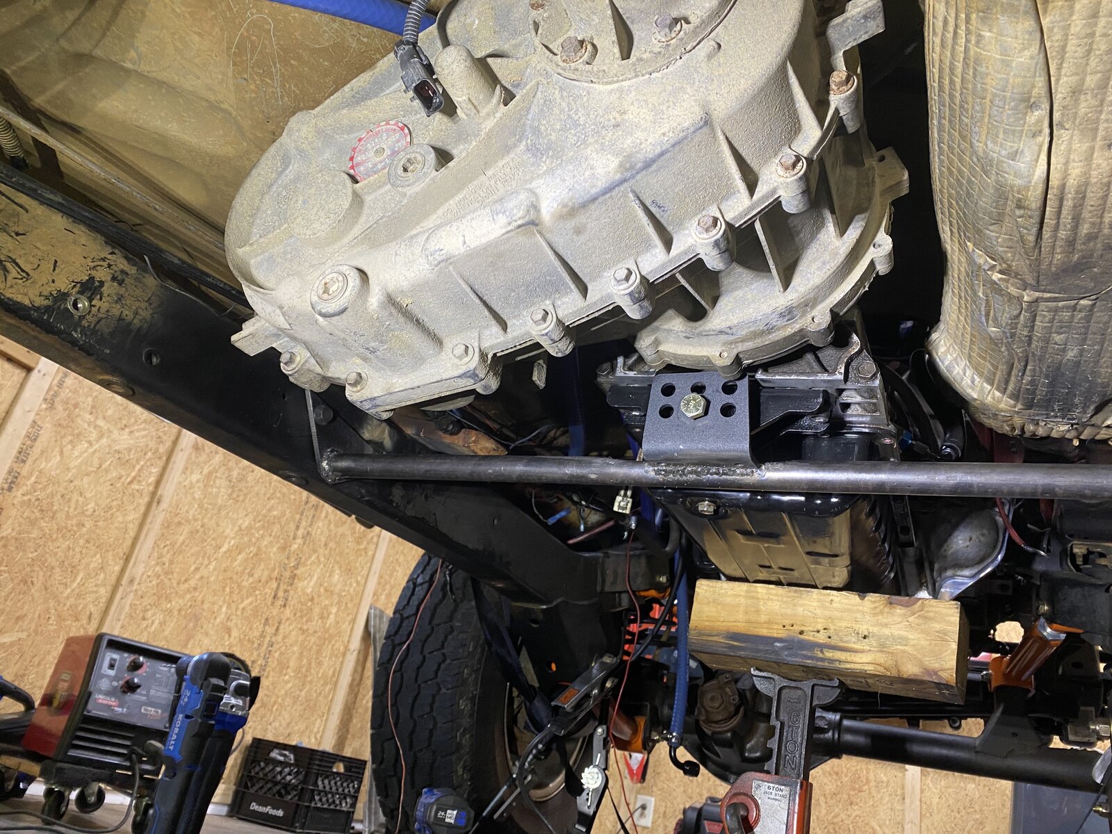

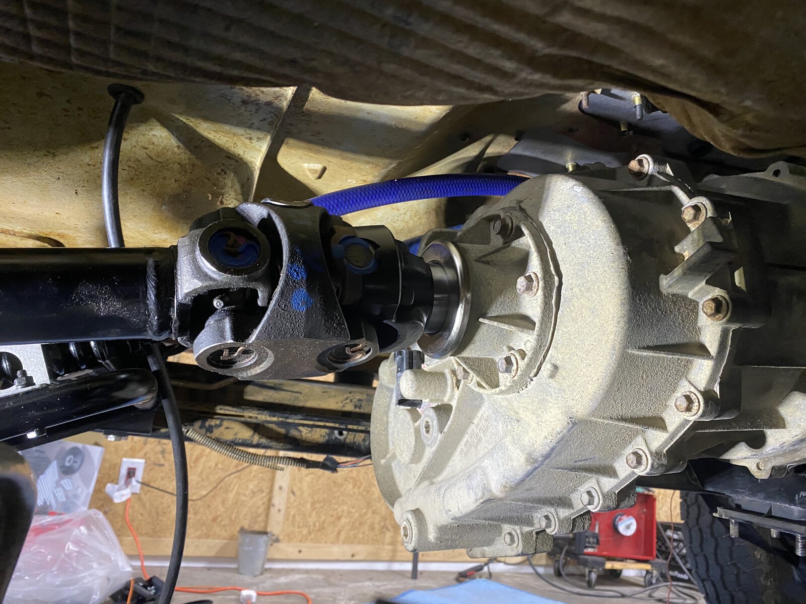

I got the new CV-style output yoke in for my Rubicon transfer case and then finally finished the fabrication on the crossmember to hold up the AW4 automatic transmission/Rubicon transfer case on my BEW TDI-powered TJ Wrangler.
The first thing I did was install the new CV style 1310 output yoke from JB Conversions onto my NVG241OR Rubicon Transfer case. I switched to this output yoke with the hopes that I might be able to run the same driveshafts that I had on my TJ when I was running the Ford 6r80 automatic and NP231. With an impact and a 3-jaw puller, replacing the output yoke went quickly. The surprise of the day though was that both my front and rear driveshafts fit. It was great getting a little bit of luck on this build!

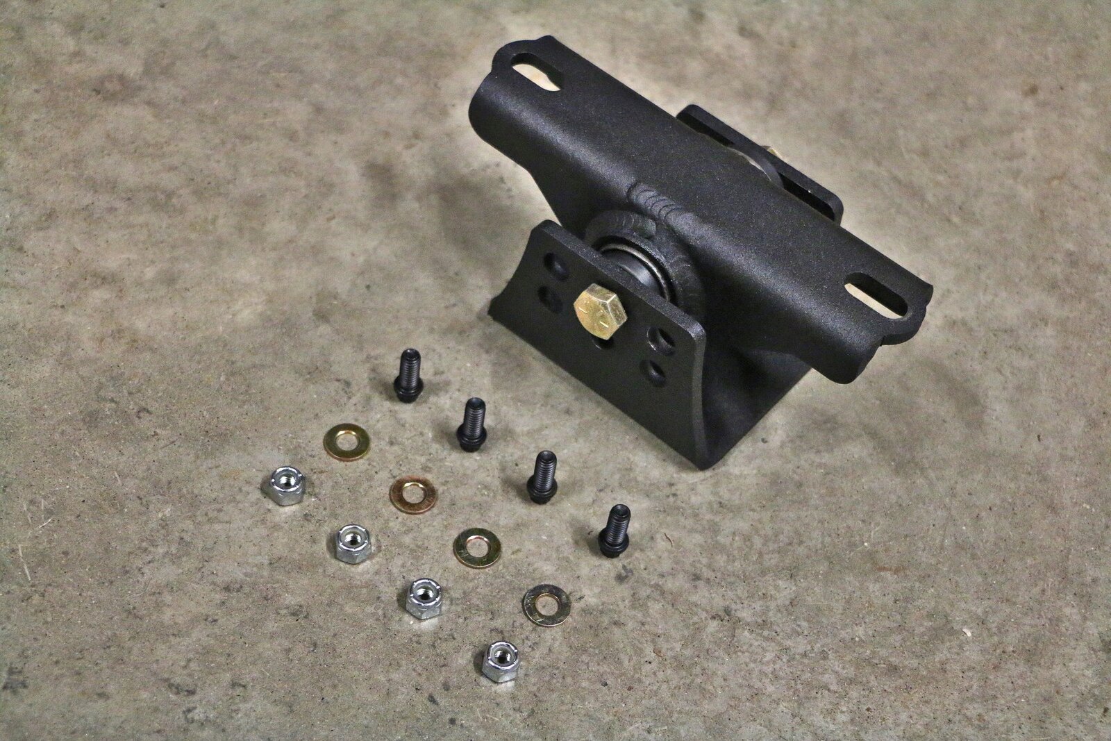

Next, I turned my attention to the transmission mount for the AW4 automatic. I was planning on using the factory transmission mount but the rubber has so much play in it that trying to figure out where everything was going to live with the tight tolerances I was fighting with the body because annoying so I got a heavy-duty transmission mount from Ironman4x4Fab. With the new transmission mount, I was able to easily figure out how to fabricate the rest of the adapter out of the thick-walled round tubing I was using.

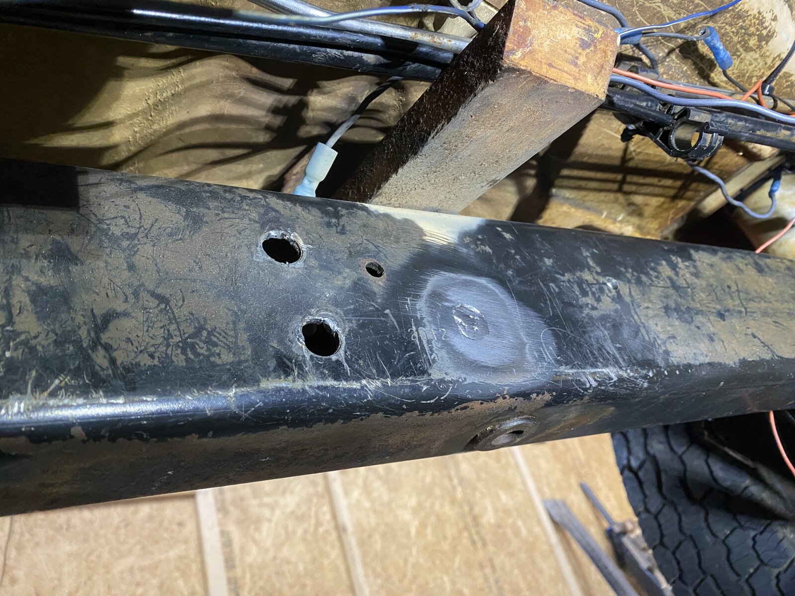

One thing I did decide to do was clean up all the old and used nutserts that I had installed on my frame where previous crossmembers had been installed for the various iterations of this Jeep's diesel swaps. This was my first time welding up the frame, grinding the welds back to a smooth finish, and repeating to fill any gaps that I missed. This came out better than I was expecting. Another reason I had to do this was the currently installed nutserts were going to interfere with where my new crossmember was going to be installed.
With that done, I turned my attention back to getting the crossmember fabricated and welded up. One trick that I finally learned about making this crossmember was to use painter's tape and washers on the frame to simulate how far the nutserts were going to stick out of the frame. That worked perfectly. Once that was done it was just a matter of triple checking all my cuts, weld the crossmember together, and drill new holes into the frame for the mounting hardware.
I say easy but somehow I still messed up one of the center punch holes for the crossmember which I will be fixing this coming week. It's a simple matter of hammering out the nutsert, welding/grinding the hole in the frame back up, and reinstalling the crossmember with the other bolts in place so I can drill the last hole correctly. Even with that mistake, the new drivetrain is now being supported in my TJ by itself and I'm moving forward with making progress on this build.

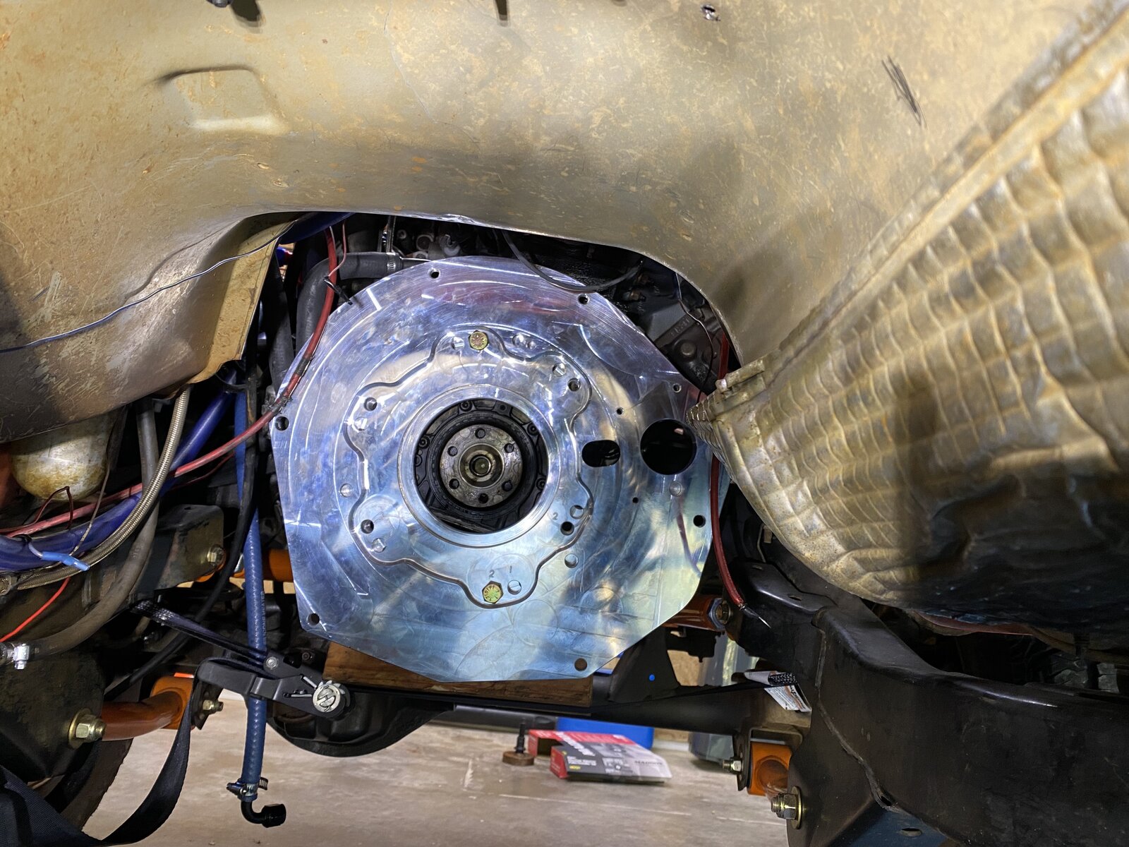

Next, I removed the AW4 4-speed automatic for a few reasons. First I had just put a few bolts into the TDConversion's adapter plates so I could test git everything but also I needed to clearance the bellhousing on the AW4 to make room for the supplied Toyota 4.7l starter.
I am sure there are better ways to clearance the bellhousing but I found a sanding disc, zaw saw and drill worked surprisingly well to clearance the bellhousing for the starter. One of the things I like most about the AW4 is that the bellhousing is removable which made the job much easier as well.

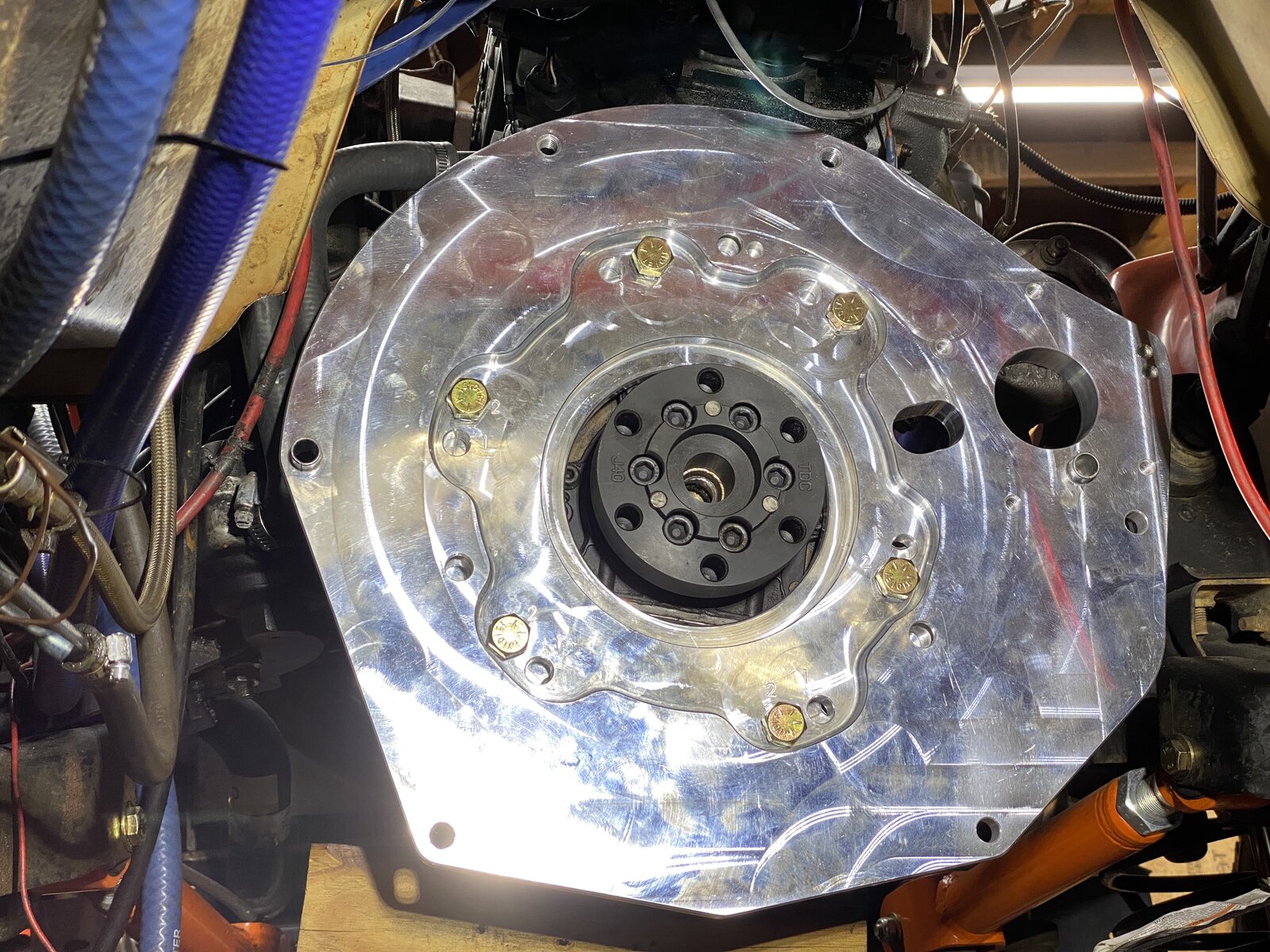

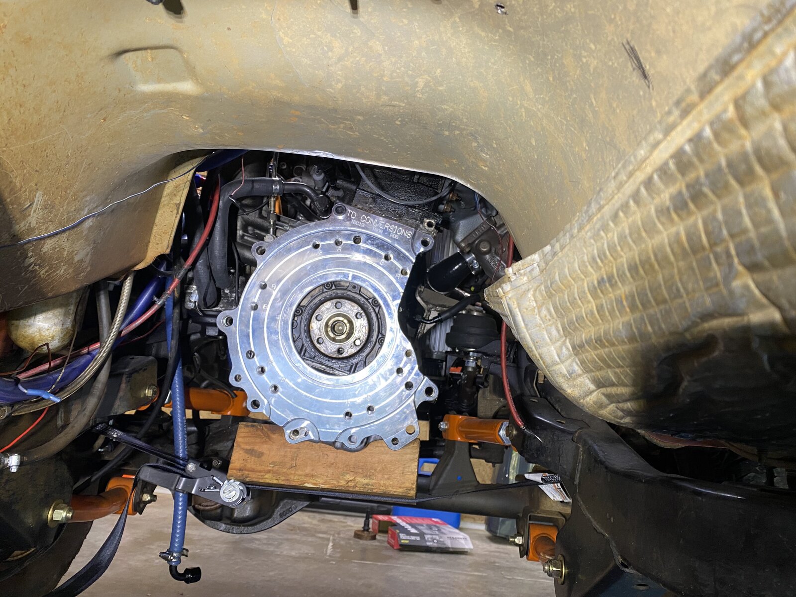

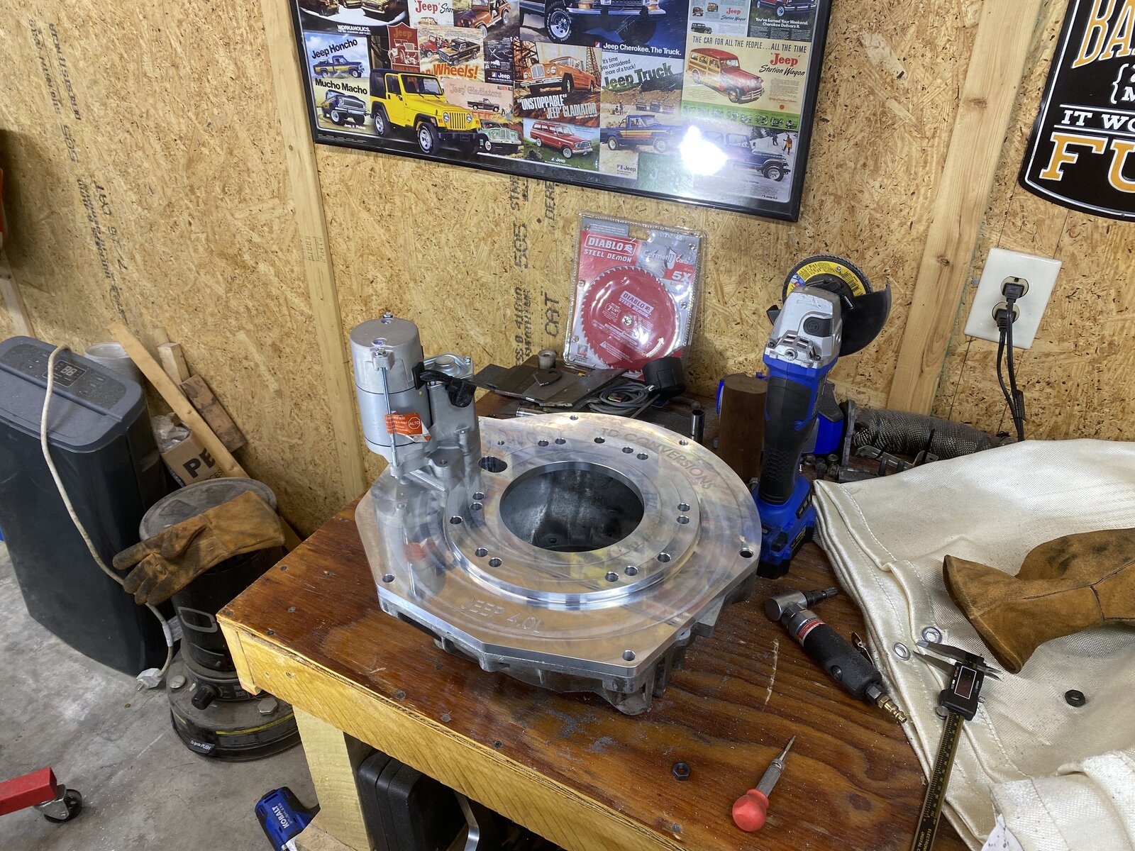

I then went about installing TDConversion's crankshaft adapter, engine plate, and transmission plate onto my BEW TDI. This was a straightforward process with their instructions minus a quick trip out to buy some Blue Locktite which I ran out of in my shop.

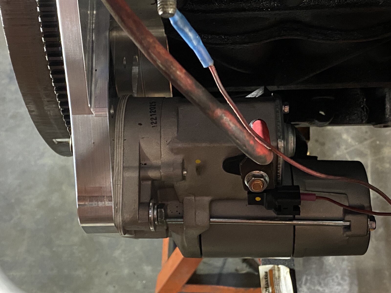

The only minor hiccup I ran into was the test fitting and installing the Toyota 4.7l starter onto the transmission plate. The instructions from TDConversion are thorough and very detailed but admittedly I missed a section about all the measurements that need to be checked when installing the starter onto their transmission plate.

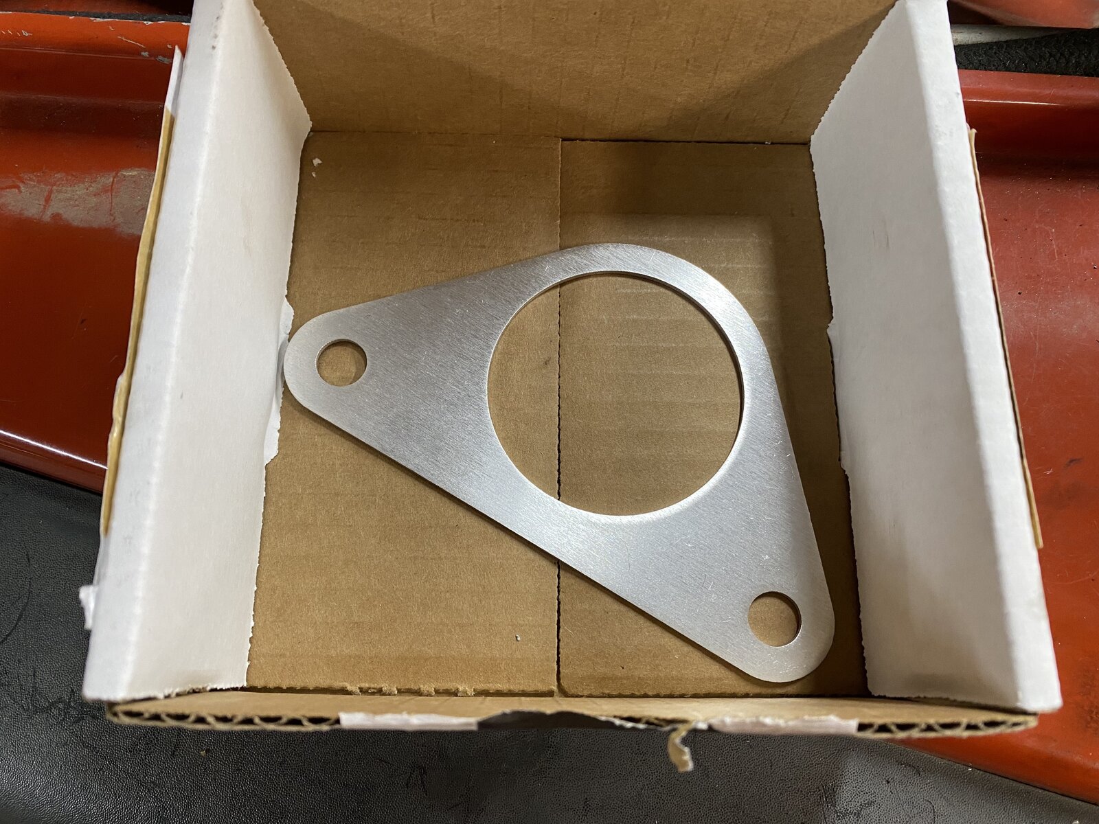

I was running into an issue where the starter bendix gear wasn't wanting to mesh correctly with the flexplate for my AW4 automatic transmission. While I had checked the clearance between the bendix gear and the flexplate teeth, I had not measured the distance between the face of the flexplate and the starter motor.
After re-reading the instructions from TDConversions, I realized I need some starter shims to space out the starter correctly. Their instructions said to email them if shims were needed, which I did and 3 days later I had the shims in hand. After installing the shims, the Toyota 4.7l starter motor worked perfectly.

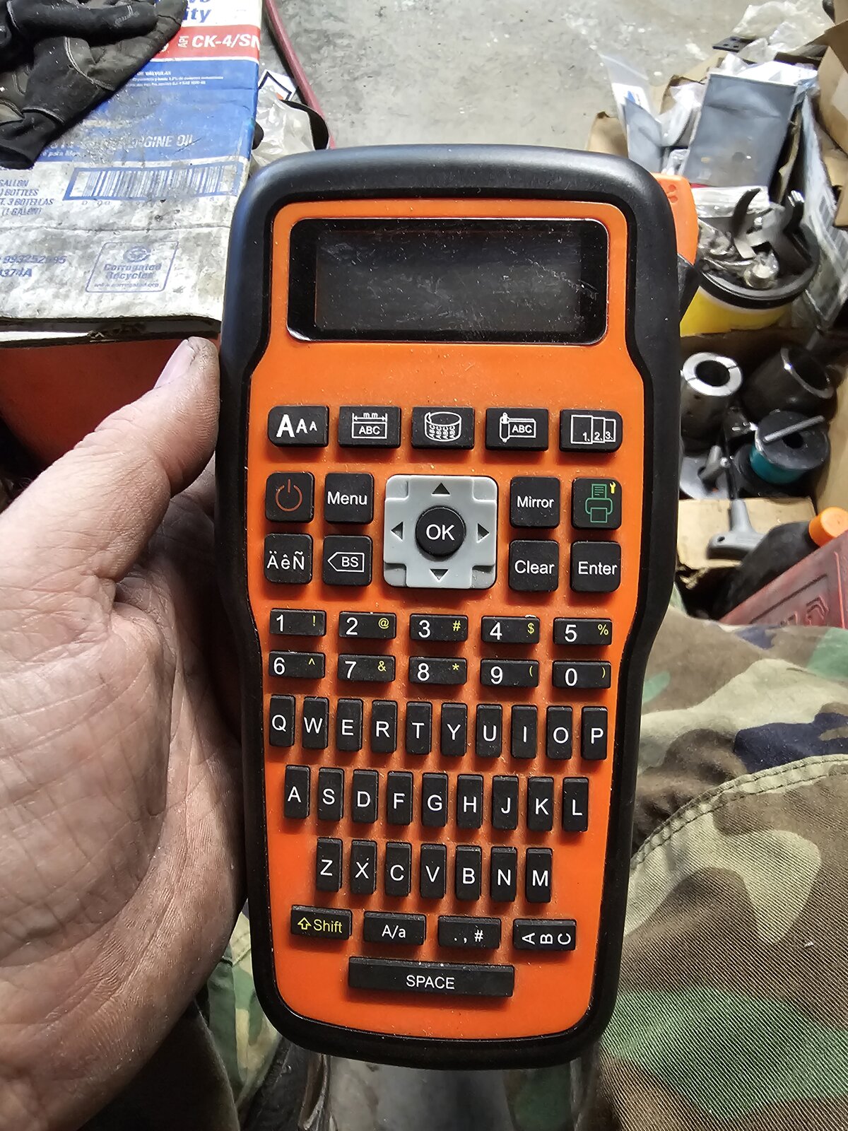

I learned my lesson the hard way too about labeling the wiring and plugs. I got a label maker and now try to label everything.
Reactions: RustyAutoholicGuy
Which label maker are you using? I have an old one that I've owned for probably 15 years and the labels just keep failing off, I either need a new label maker or different labels so they stick better.
Reactions: Wildman
I bought a Brady. You can print heat shrink or get self laminating labels
It's a Brothers knockoff. It uses the same cartridge as a Brothers so you have a lot of options. The one app has is nice.
Reactions: Apparition
Okay that is SICK, I need to look into that, heat shrinking a label onto a wire harness seems like the way to go for sure!
Look into the self laminating also, they are much cheaper than the heat shrink version. I have not tried the heat shrink myself but it's been in my cart for a while incase I got a good deal. There are tons of options.
Yeah I'm looking into both options right now. My labeler is so old I can't find anything for the one I have so I'm checking out both Brothers and Bradys at the moment.
How well do the self-laminating labels hold up, Ryan? One thing I don’t like about the Brother is that when I do a label on a wire, they eventually delaminate. On a flat surface they seem to last forever.
Heat shrink is cool, but only useful with a clipped wire. If a wire is already terminated you usually can’t get it on.
Not sure since I haven’t used any on my blue Jeep. The laminate is wrapped around the outside a wrap or two so I’d assume it’ll hold up as well or better than a non laminated tag and you don’t have to worry about the ink wearing off as it’s covered.
