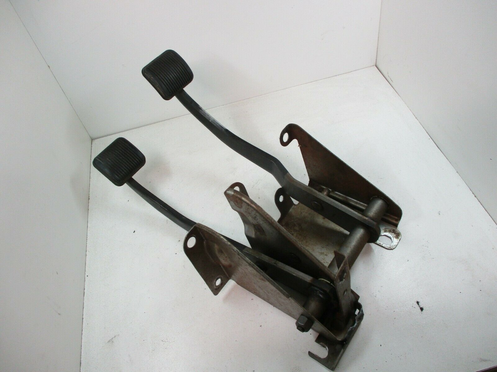

Yeah I know what you mean, in many ways swapping just the engine is SO much easier. I've already decided to keep my driveshafts, adapter, transmission and crossmember for the 6r80 so if and when another company comes out with a controller for the 6r80, I want to be able to bolt everything back into place and see how it does. Theoretically I should be able to switch everything back in a weekend that way.
I actually considered going to an AX-15 to just be done with it. I actually got a set of Manual Transmission pedals for a Right Hand Drive TJ Wrangler in from Australia as a last resort back up plan.
But I'm still bound and determined to have an automatic. The other nice thing about the CompuShift that I forgot to mention is it can get all the information it needs from the CANBUS on my TDI ECU. So to wire the controller up will only be 4 wires. Ground, Key Switch Power and the two CANBUS wires.
