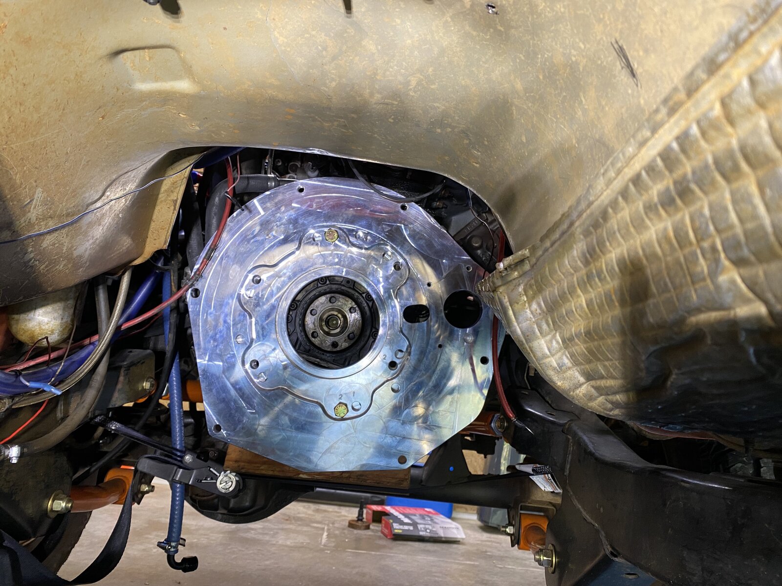

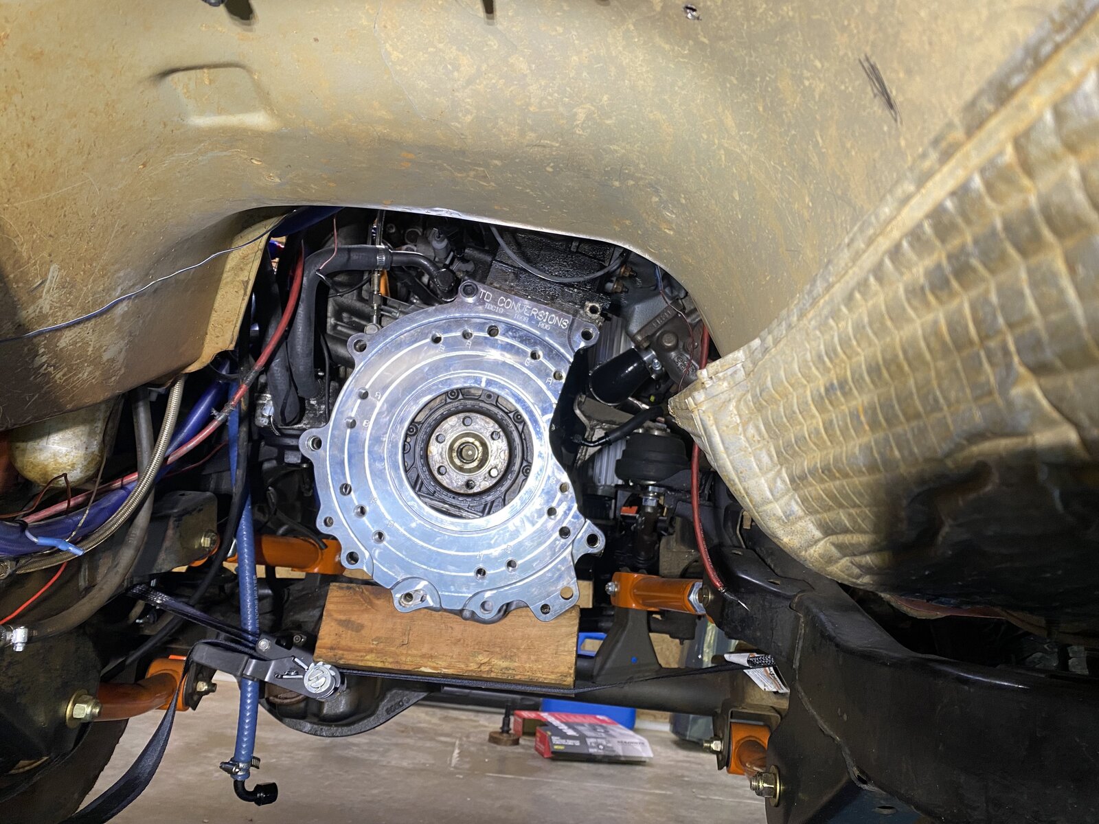

Hey TJers,
Finally getting back to working on my BEW TDI-powered TJ Wrangler Project. On top of waiting for parts, I've moved as well which delayed everything I was doing. With that said, I've gotten the new adapter from TD Conversions test fitted onto the engine and have the AW4 automatic and NP241OR Rubicon Transfer case installed in my TJ.
The adapter from TD Conversions fits perfectly for my application. I went with their adapter because I had already installed my BEW TDI engine into my engine at a 10° angle. Their adapter had a tilt for that angle which just made my life easier by not having to redo all the work on my motor mounts.
Getting the AW4 4-speed automatic installed and test fitted was a breeze which highlighted just how small this transmission is compared to the Ford 6r80 and also just how much lighter it is as well.

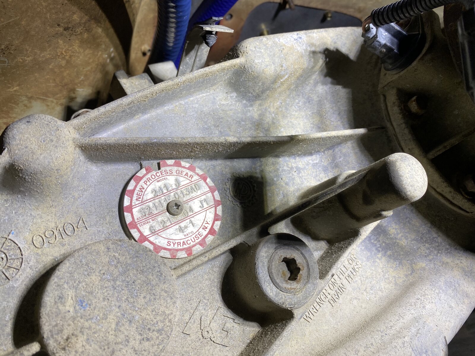

In January of this year, I purchased a wrecked 2004 TJ Rubicon which I plan on using several parts for my Right Hand Drive TJ Wrangler, specifically the axles and transfer case. For now, I'm just focusing on the transfer case as swapping the axles isn't going to be a bolt-in swap because of the different bracket locations on the axles between the Left Hand Drive and Right Hand Drive versions of the TJ.
Pulling the NP241OR wasn't too difficult thankfully though getting the Rubicon up onto vehicle ramps so I had enough room to do the work was rather challenging. Once I got the Rubicon transfer case out and went to test fit it into my TJ Wrangler.
I quickly realized just how much bigger the NP241OR transfer case is compared to the NP231. I can lift an NP231 off my chest and deadlift that transfer case into place, but the NP241OR is big enough that I wasn't going to risk it. I ended up having to use a clocking ring to tilt the NP241OR down 5° so that I will have room to lift the transmission and transfer case where I want my driveline to go.
