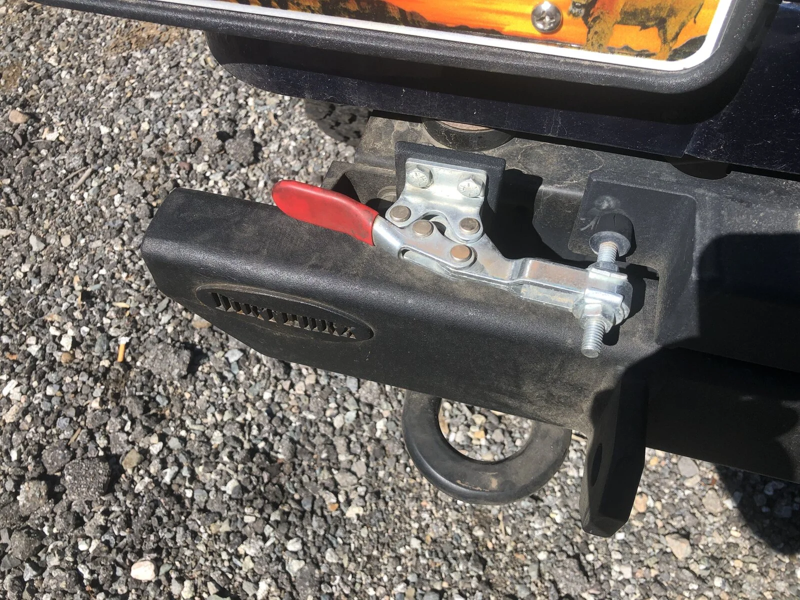

I have a DirtWerks bumper/tire carrier. Overall it’s good and solid. The main weakness is the mechanism that holds down the carrier. It sucks big time. It has come lose more than once in the few miles I’ve put on. It only needs to move a 1/4” and it will release. I plan on adding a safety cable in the future. What ever you get pay attention to how the carrier is retained and that it is greasable.
Make sure it is adjusted tight. It should take some effort to open that latch.

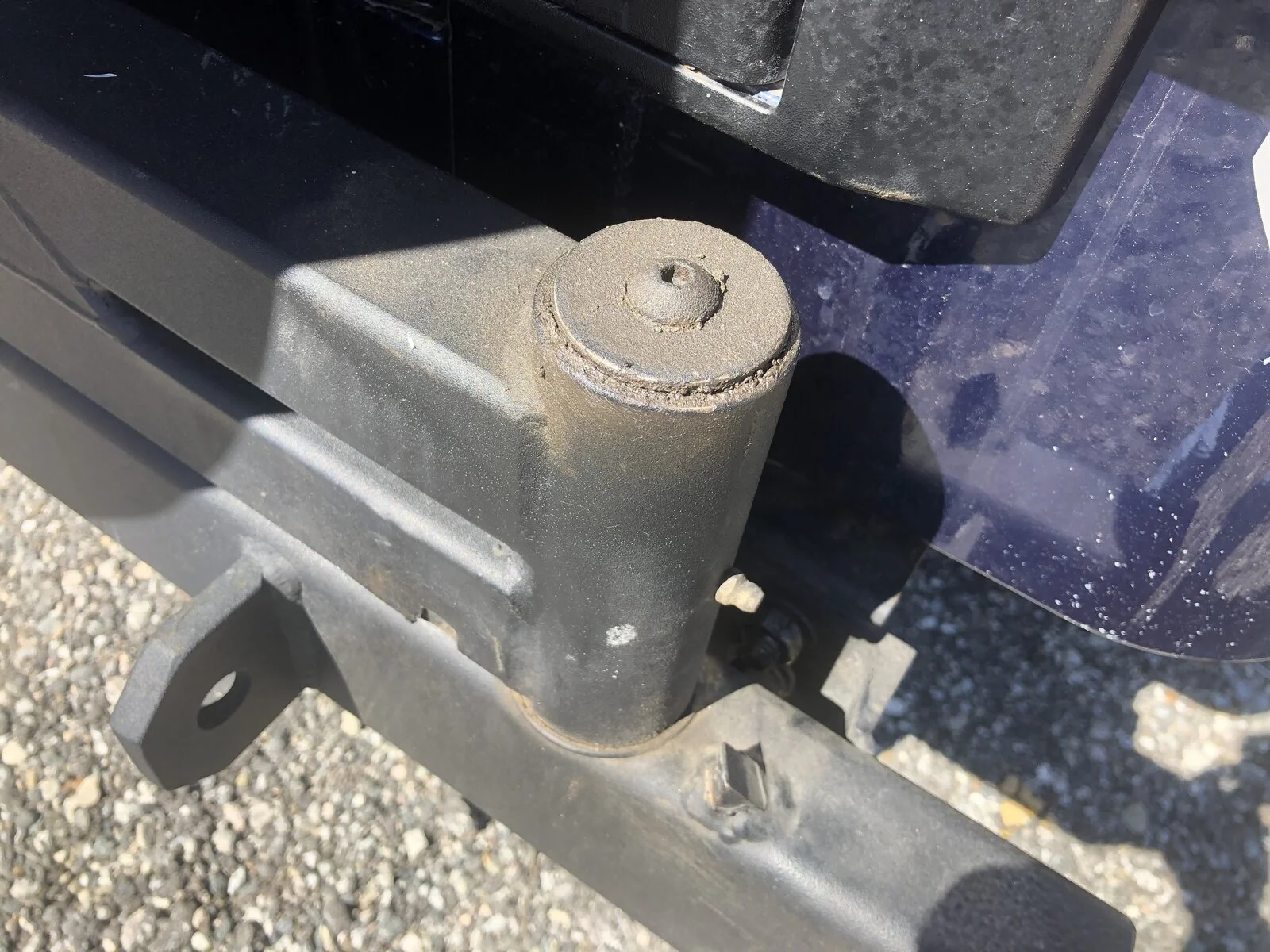

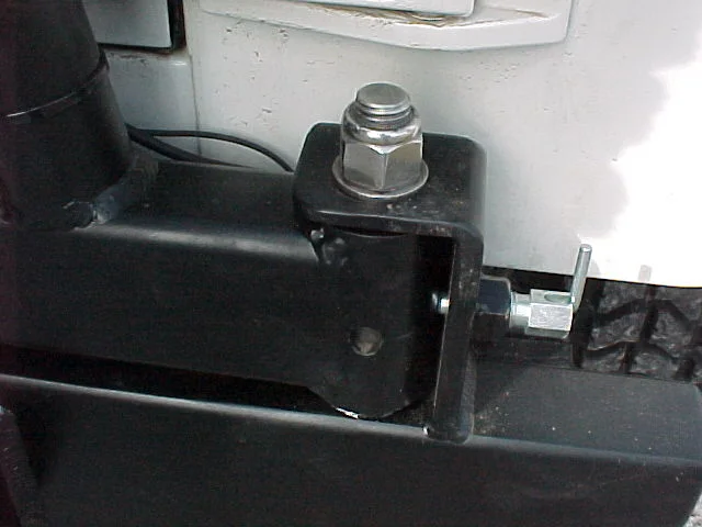

I dug up an old pic so everyone unfamiliar with the Bulletproof bumpers can see what he is working with and how the carrier attaches.
Reactions: JMT

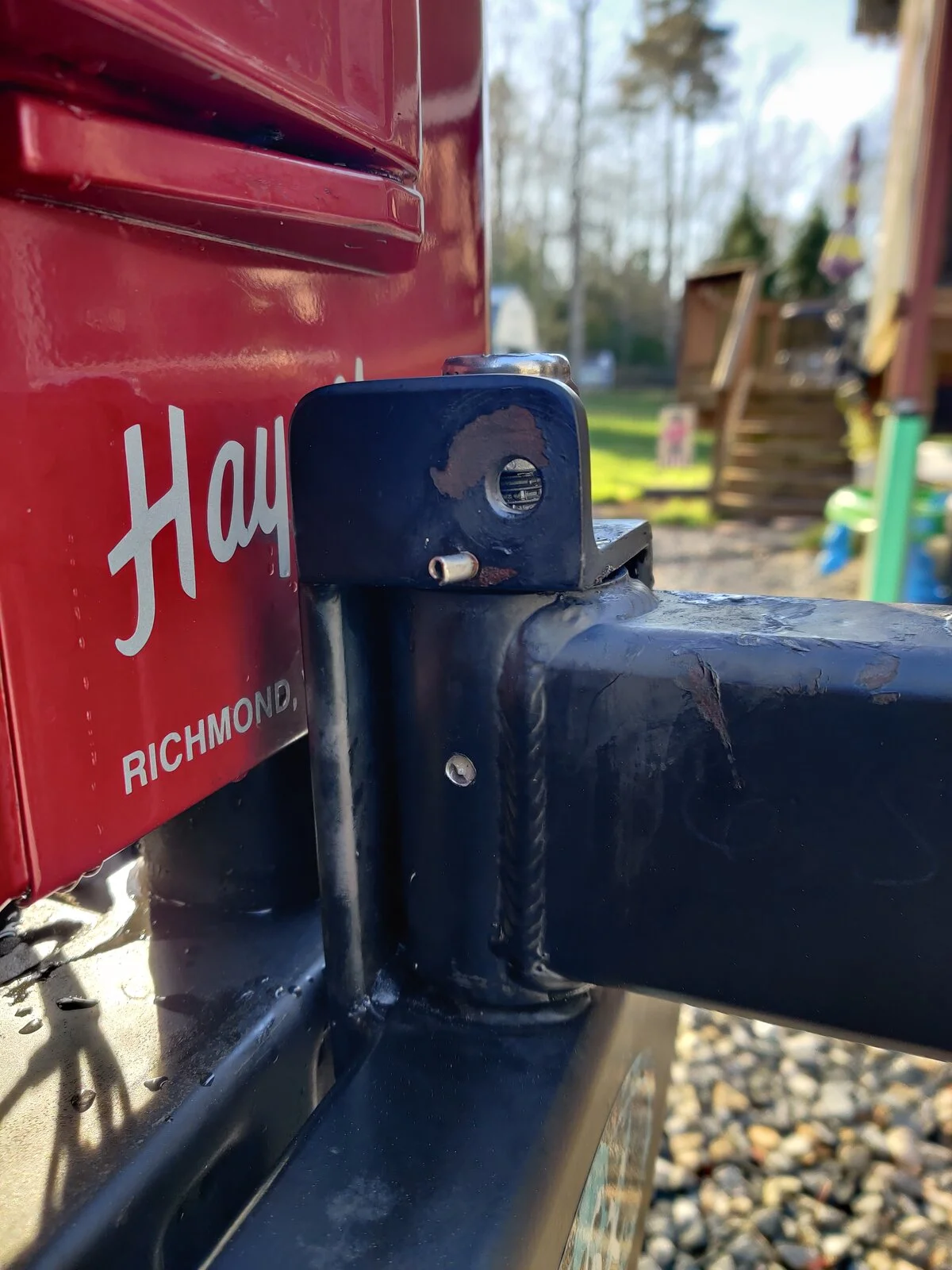

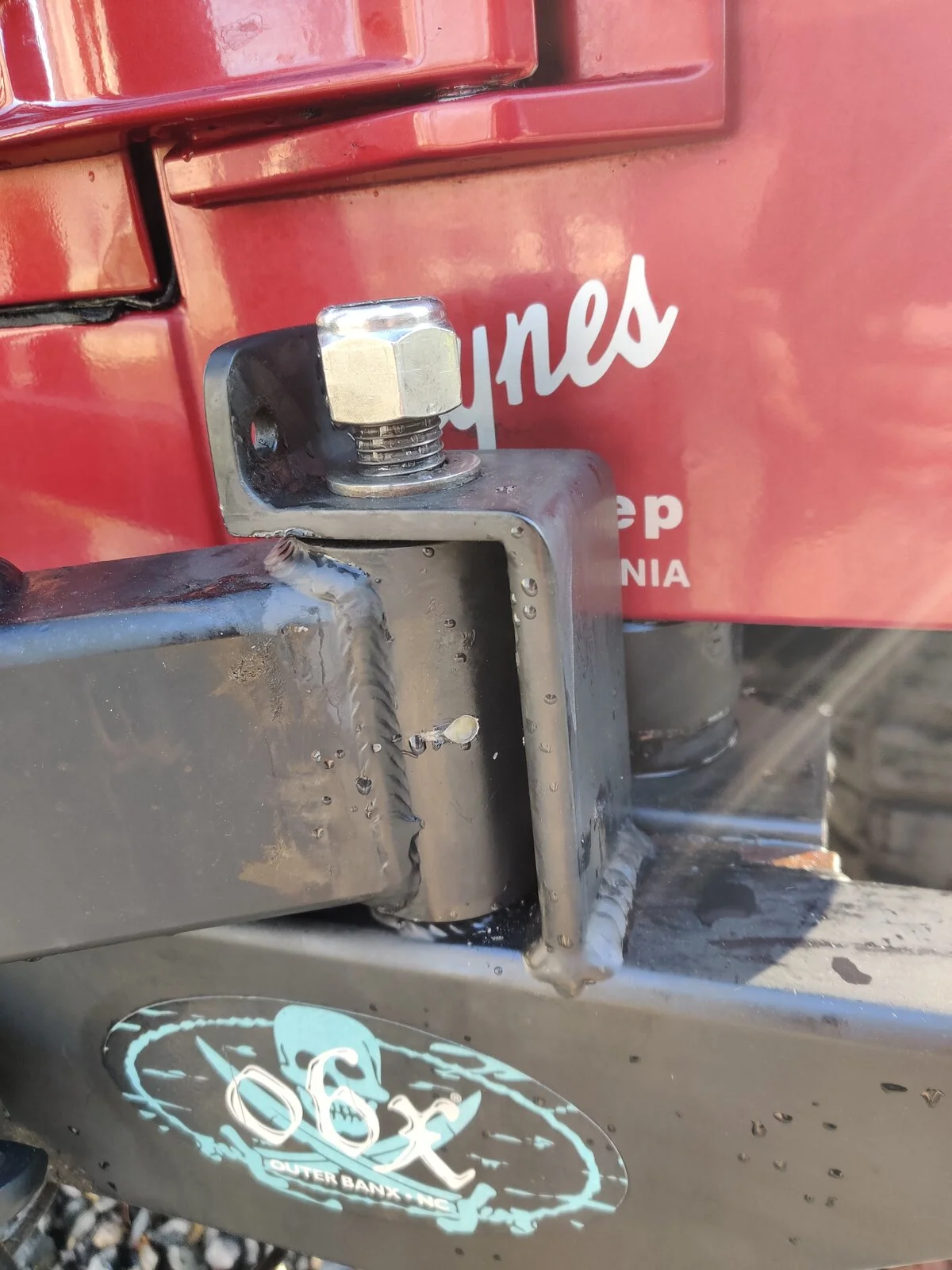

Thank you all for the replies. I'm posting pics here showing what I've tried, which is drilling each side for grease fittings (which I take out and plug because you can't swing the carrier without knocking the zerk off). I'm trying to pump grease in there a little each day and just work it back and forth . Interesting enough it's completely temperature related, cold weather-works ok, warm to hot weather, nearly unmovable.
I did not think of that. Thanks for the idea. I feel like a branch hitting it just right or some asshole will just release it. I’ve had people play with my trailer hitches before so I always check when I get back after leaving the vehicle. PO gave me 2 extra spares. Still seem like a hokey system compared to the rest of the bumper and carrier.
