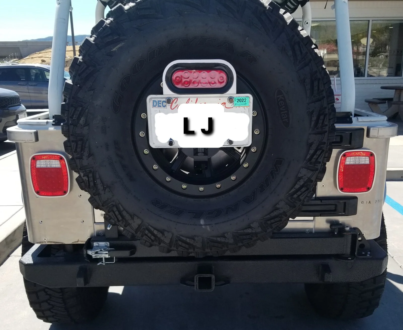

Get a carrier that mounts to the body/tailgate. Having to open a carrier before opening the tailgate is a pain. Plus, a body mounted carrier is stronger and sturdier than a single pivot point on a bumper
Unless you have a use case for a swing set, stick with a tailgate mounted spare.

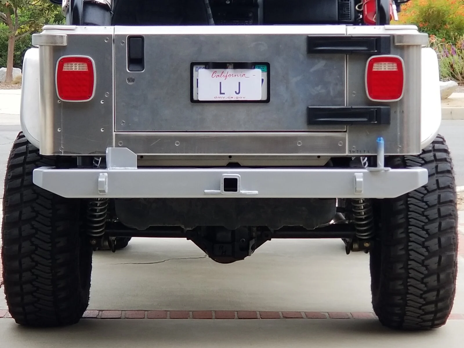

I have an ARB rear bumper with a swing out spare mounted on it. It's built like a tank. Doesn't rattle. I've had it for years and have been all over with it.
Reactions: L J

what size tire you running? If a 35 or less, check out the Moryde tailgate Hinge system
31 inch tires. Mostly relatively mild off roading. Don’t rock crawl nor do I go looking for the max mud or body damage.
Again, unless you're wanting a swing sway, you don't need one.
You really don't need anything other than the stock carrier for 31s.

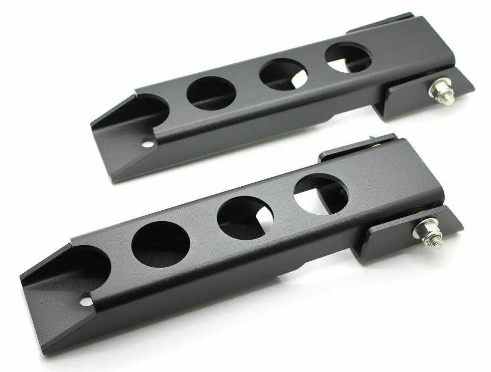

If you're concerned about the tailgate hinges, you can upgrade them.
My OEM spare carrier held the OEM Rubicon size 30.5x9.6 for nearly a decade without issue.
IMHO anything more than a alloy wheel and stock tire will eventually waste the tailgate. I put a Dirtworx swing out on mine. Very very nice setup and more more rattles. Robert makes great stuff.

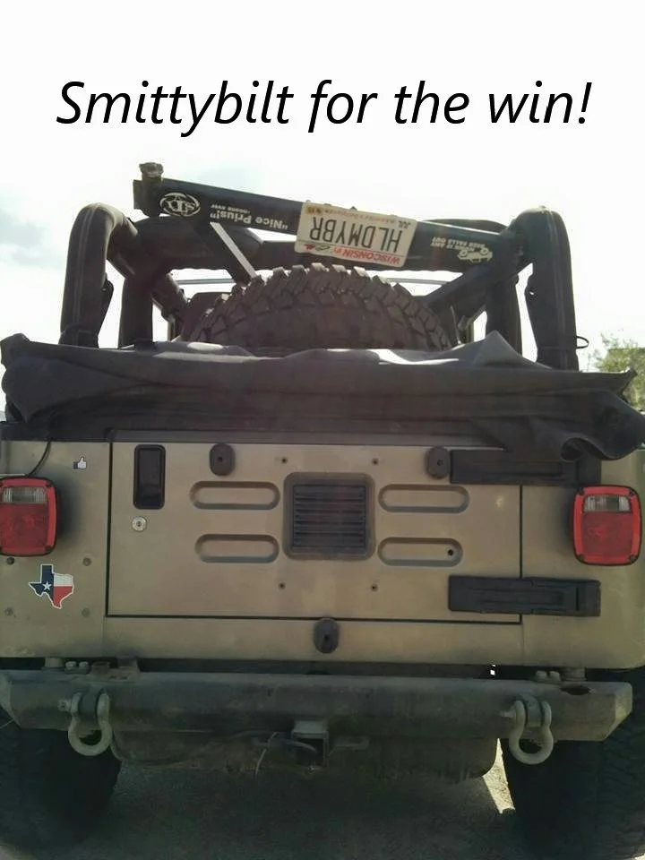

The last thing I'd run would be a bumper-mounted swingout tire carrier. Their pivot points are seldom up to the task and often the bumper itself isn't strong enough to support the swingout mount.
This is (was) a Smittybilt swing-out tire carrier.
Reactions: L J
