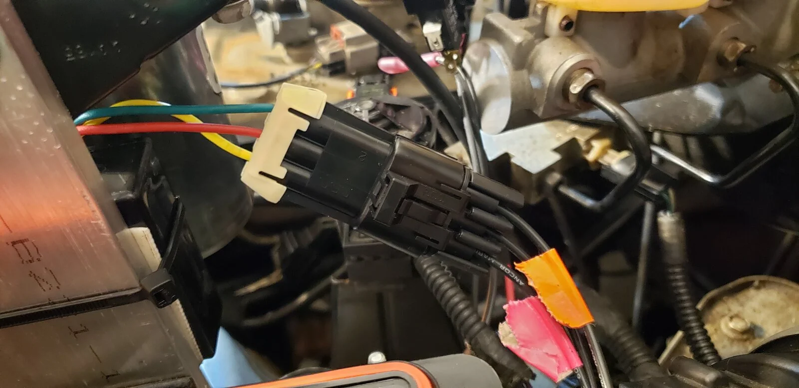

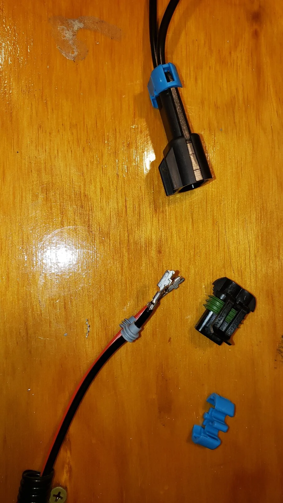

One advantage of having the Metri-Pack 280 Series connectors on hand is that they can also be used to construct wiring harnesses from scratch anywhere from 1 connection up to 62 connections in one harness. Here is a dual connection harness:

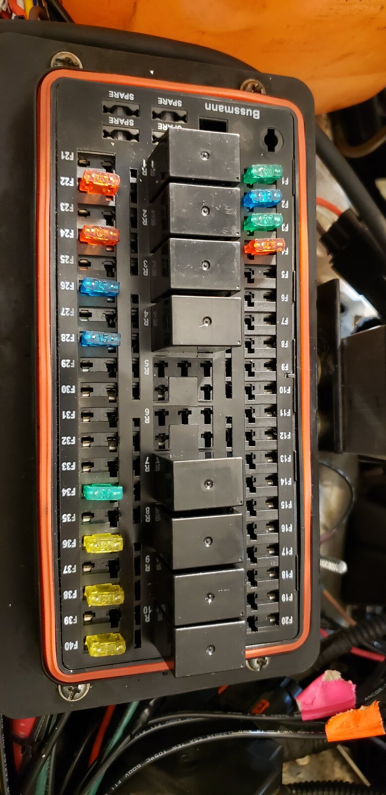

Added four additional circuits to the Bussmann RFRM the past few days.
  • Toad Charge (30 amp fused)
  • Trailer Charge (30 amp fused and relay)
  • Vacuum pump (25 amp fused and relay)
  • Toad braking (10 amp fused)
I will also be adding a power line for a trailer brake controller as well. I'm in the process of installing a 7-way RV plug in the front for flat towing plus a 7-way RV socket in the rear for towing. The way it is set up, it could be used for triple towing, but I have no intention of testing that.
Also, it seems having the ability to make OEM-grade waterproof wiring harnesses in mere minutes is a lot more useful than I thought. Somehow I've already burned through 100+ female terminals...

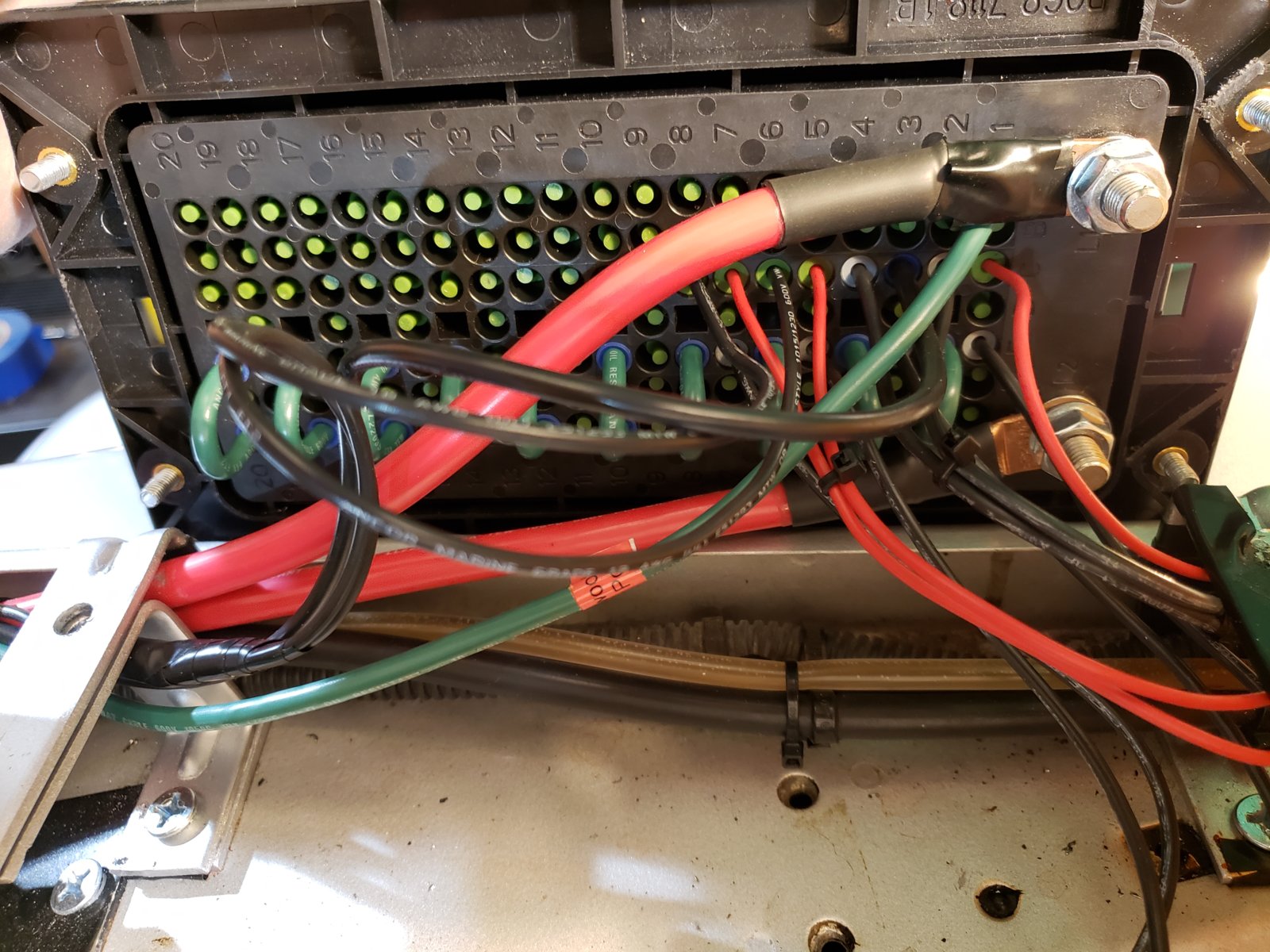

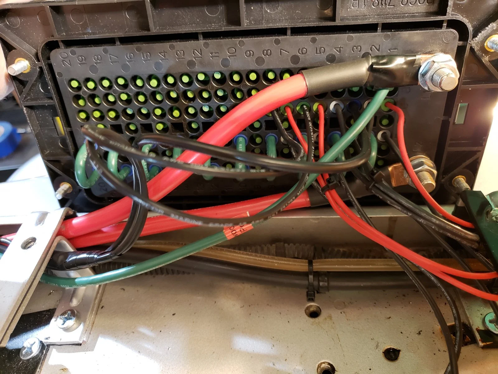

Underside of the RFRM. The green rubber pieces are removable cavity plugs to prevent water from getting into open holes. Note that every wire is sealed with a cable seal. The terminal post caps are missing in these photos.
(Unfortunately, I'm not the neatest person when it comes to cable management.)

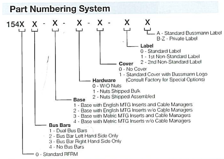

You're right (again). Here's the part numbering system from the RFRM data sheet:
The fifth digit signifies the bus setup. Not sure about the RTMR, though - I didn't consider using that one, so didn't grab the data sheet.
