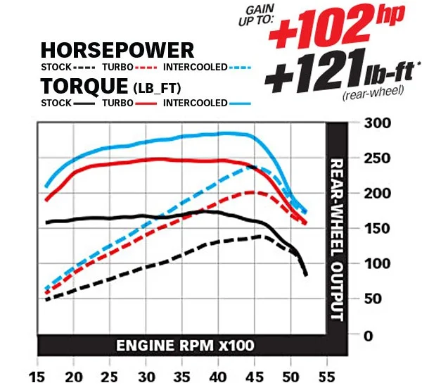

I couldn't bring myself to cut a hole in the hood so I left the cold air intake off. As I recall, the Banks dyno results for the turbo with intercooler were without the scoop. The dyno results for the turbo without the intercooler used the scoop. I will speculate the scoop doesn't make much difference if you have the intercooler.

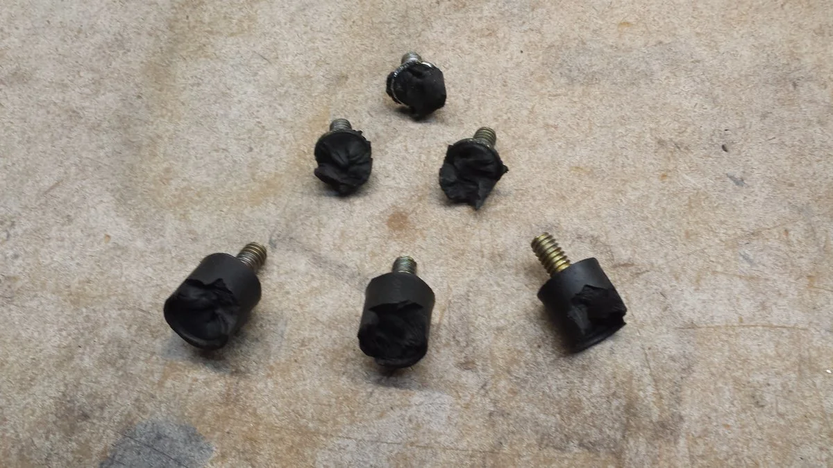

Soon after I installed my system, the three rubber mounts for the cold air housing sheared off. I contacted the company and their response was "we never saw that before", and that was the last I heard from them. I made my own mounts with a bolt all the way through the rubber mount, and they never sheared again.
I guess I don't expect much service from companies any more, so I'm rarely disappointed with what I get.......View attachment 118512
Same, damn thing happened to me. I think I'm going to replace with some stainless steel springs. I think that give will allow the vent and filter to mate better.
I had contacted Banks and sent them pictures, they said they had never seen that before.......
