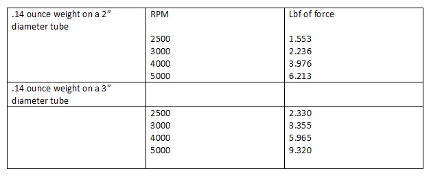

This topic has been discussed extensively but sure, lets beat the dead horse a little more. Here are some things to consider.
  • Most of the time TJs work fine with 5.xx gears. Gearing extra low doesn't guarantee high speed vibrations but it does increase the probability of high speed vibrations.
  • Nothing is perfectly balanced. The smallest weight we can get is 0.14 ounce. https://neapcoparts.com/dlw-1-driveshaft-weight/. Other factors contribute to the level of perfection that is achievable as well but for now lets just assume that we can only add weight in the increments of .14 ounces or more.
  • The bigger the diameter a shaft is the faster the surface speed is and the greater the force of the balance weight will be. Critical speed is important to consider when ensuring that the shaft is not flexing at high speeds but generally speaking in a TJ critical speed is a non-issue. Which means that keeping the diameter small is actually advantageous as it minimizes the centrifugal force of any imbalances.
  • The equation to calculate centrifugal force is F = m v² / r. I'm not smart enough to do it manually so I use the calculator linked above. However, I am smart enough to know that the little number 2 in that equation is important, it means squared. It tells us that as speed doubles the force quadruples. Just as 4² = 16 and 8² = 64, the base number doubles but the squared number quadruples. Same applies to the force of an imbalance. This is important to note because the effect of going from 3,500 rpm to 4,000 rpm, a 500 rpm increase is far greater of a change in force than going from 2,500 to 3,000 rpm even though it is also just a change of 500. The faster the shaft is spinning the more a couple hundred more rpm will affect the force of imbalances and thus vibrations.
  • I've run the calculations for how much force this tiny weight creates, which is about the diameter of a nickel but not as thick, using the force calculator on this page https://www.omnicalculator.com/physics/centrifugal-force. Remember, it calls for radius so I'm halving the diameters.
Now that I've demonstrated how much force the smallest balance weight can produce at different RPMs I'll explain some of the other factors that cannot be controlled by means of adding balance weight.
