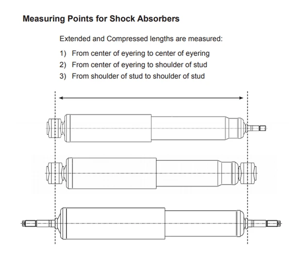

When I calculate compressed shock length from the bottom mounting bracket to the upper bracket, I calculate that I have a space of 15.5". Sounds perfect right? However, there is a problem. When shock companies measure shocks with a stem like our front shocks, they measure to the shoulder of the stem. They don't include the bushing and hardware that sits on top of the shoulder. So now, assuming a 1" bushing and shoulder plate, I am suddenly over compressing by 1". In short, that 15.5" shock actually measures 16.5 when you measure from mounting point to mounting point.

Here is a good image of how shocks are measured.

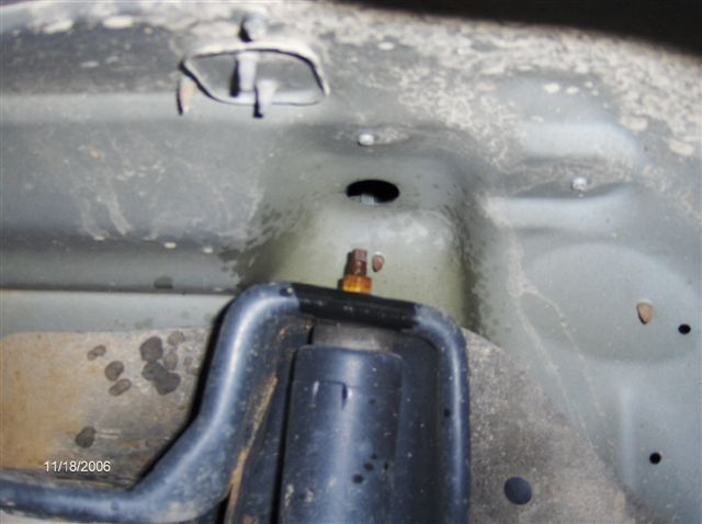

When I replaced my springs last summer I took some measurements with the springs removed so I would have accurate measurements when I needed new shocks. Looking at the front shock, I measured from the base of the shock where it bolts in on the bottom to the top mount where the 2 bushings will sandwich the shock mount.
You can see in the picture I found online how the stock shock mounts with a bushing on top of the shock. There is also one on the other side of the mount so the 2 bushings sandwich the mount.
So with my springs and shocks removed, when I measured my collapsed space between the bottom mount and the top mount, I measured 15 5/8". So I figured I was all set to run a 15.5" shock. However, it has now come to my attention that shock manufacturers do not measure to where the bushing will meet the mount. Instead they only measure to the top of the shock where the bushing sits on the shock. So when calculating collapsed length, I will need to add in the additional space that is taken up by that bushing that sits on top of the shock. Is that correct or am I missing something?
It seems ridiculous to me that they measure it that way because that means that a 15.5' shock will only collapse down to 15.5" plus the thickness of the bushing. For example my old shocks are spec'ed at a collapsed length of 14.5". However, if I measure to the top of the bushing that will press against the mounting surface, they actually measure 15.5". So that bushing just added an inch of collapsed length to the shock.
