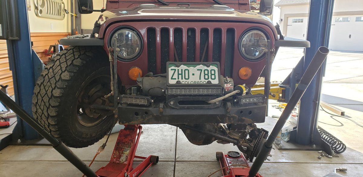

I'm trying to figure this out, so I'm sorry to ask, but what I got from ARB is my front shocks have a range of 15.43 to 26.79 inches, and the rear 14.41 to 24.49 inches. I've got a 4" suspension lift, and I'll be adding a 0.5 inch and 1.0 inch spacer, front and rear, to compensate for sag. At the same time, I was thinking of either Currie, Rokmen, or Metalcloak adjustable bump stops. Why can't I just install everything, cycle the suspension, and adjust the bump stops based on the numbers from ARB? I guess I'm most confused on the need to remove the coils, and disconnect the bottom of the shock. I'm guessing the removal of the coil is so it'll be easier to manipulate the suspension?

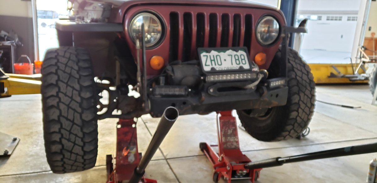

Correct. Remove the springs, the jounces and disconnect the sway bar. This will allow you to move the axle through its entire range of motion with just a floor jack. Keep the shocks attached while cycling unless you are wanting to find the limits without shocks.

Disconnecting the AR just makes it easier to move things around and get the full range of motion without the weight of the Jeep acting on the axle. The shocks should not be disconnected while cycling. Doing so only makes it easier to pull the springs out.

If you don't remove the springs, you will start lifting the Jeep before the suspension fully compresses.
Removing the sway bar makes it easier to lift the entire axle into full compression and will allow you to get better accuracy if you ever plan to disconnect it when off road.
Your goal is to make sure to get the right bump stop that allows you the most possible uptravel without the shock being the limiter to travel or worse, the tire hitting the fender.

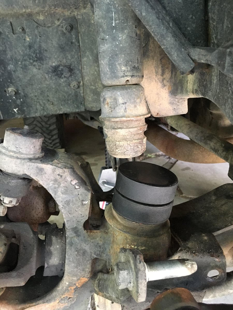

Keep in mind that for the front, you don't want to extend the factory jounce bumpers, you want to install bump stop extensions on the bottom spring perch.
See my writeup on bump stop extensions
https://wranglertjforum.com/threads...nsions-on-a-1997-2006-jeep-wrangler-tj.31063/
For the rear, installing the extensions above the bump stop cup is preferred.
I planned on adding extensions on the bottom, but why are extensions preferred in the rear? Can I do bottom extensions in the rear as well?
