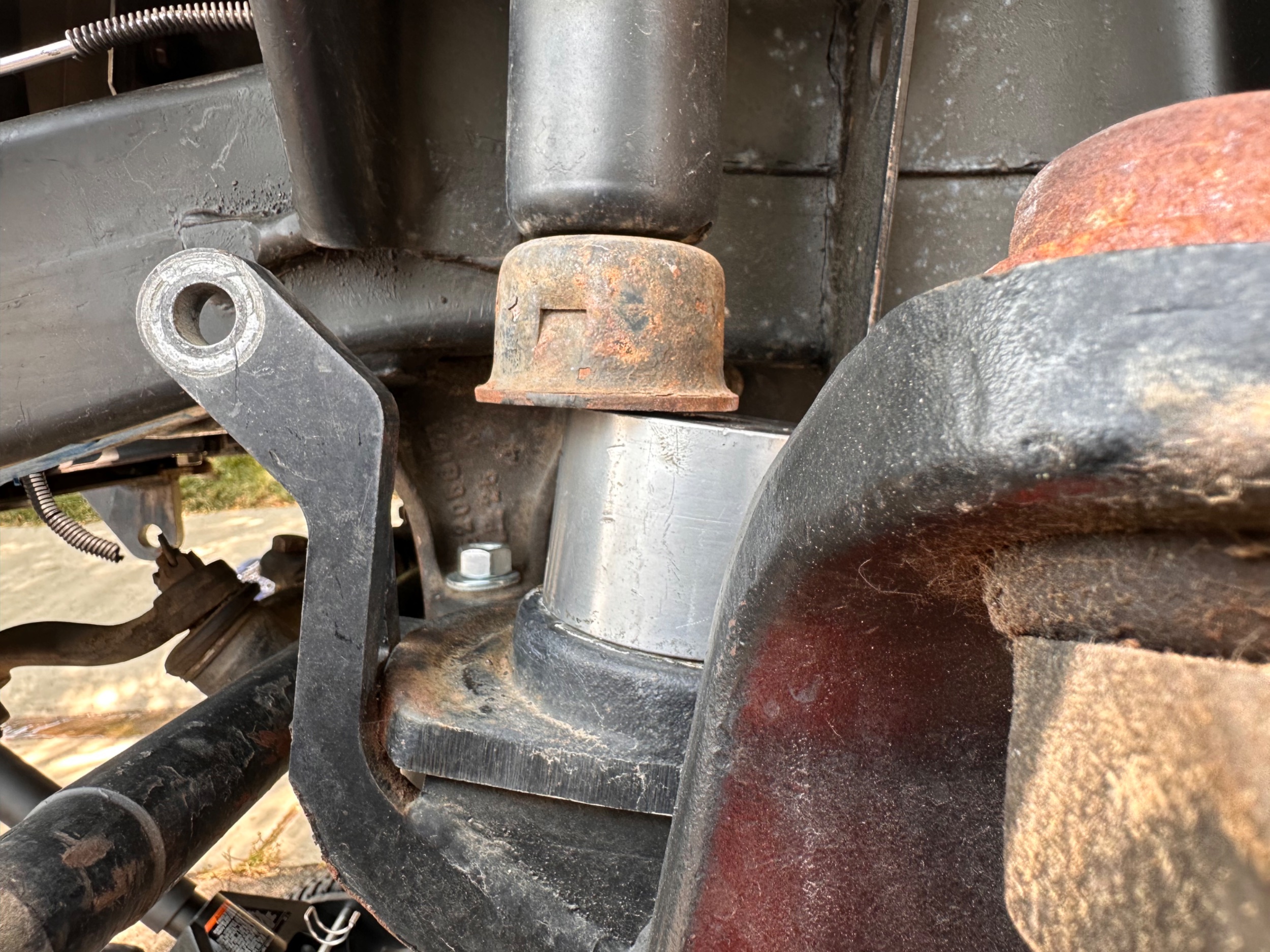

I have a 2” lift which is actually probably more than 2” because my jeep is on the lighter side. The front axle being very visibly off center has been driving me crazy so I figured while I was doing everything else I would install adjustable track bar. Ordered the rock jock track bar. I am test fitting today, I think I have the axle centered after messing with it for hours. Now I’m checking the clearance. It looks like I am going to need 3 3/4” - 4” Bumpstop to keep the Dana 44 pumpkin off of the track bar. This seems like a ridiculous amount of bumpstop to me.
It does look like I could pull the front axle back some, but that will definitely put the jounce cups a little out of alignment with the bumpstops.
