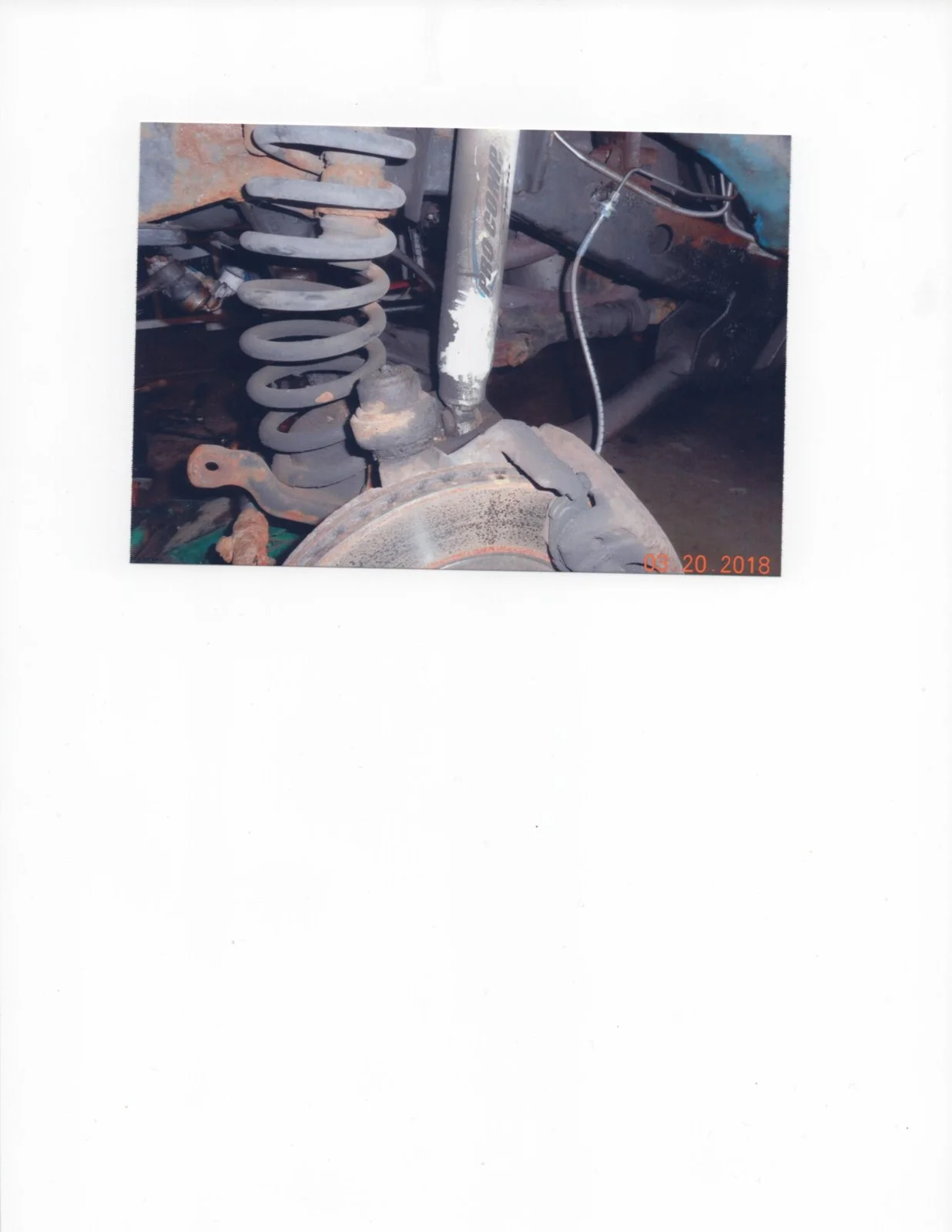

How much should I extend my bumpstops?
In previous configurations, my front tires scraped the steel fenders before the shocks bottomed out. My bumps were extended to prevent that interference.
Additionally, just measuring the shock shaft won't tell you if the aftermarket front track bar is interfering with the aftermarket diff cover.
2003 Rubicon
why didnt you guys tell the axle would roll forward when taking off both upper arms.....shows the jounce bounce hitting the spring though. :)
see them shiny new stainless steel lines..... what a difference after putting them in all around, lines an hoses. no sponge what so ever.....
