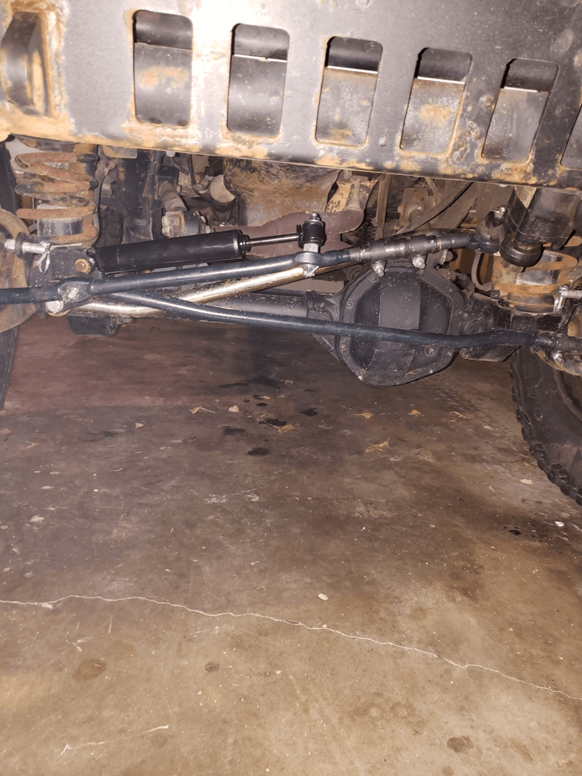

The Johnny Joints themselves have nothing to do with it. It is possible however that you have one or more control arms fighting against the other one. Meaning one is extended far more than the others and is thus putting pressure on things.
This is what I'm thinking. Luckily I got an appointment with the 4x4 alignment shop tomorrow. Hopefully they can set me straight.

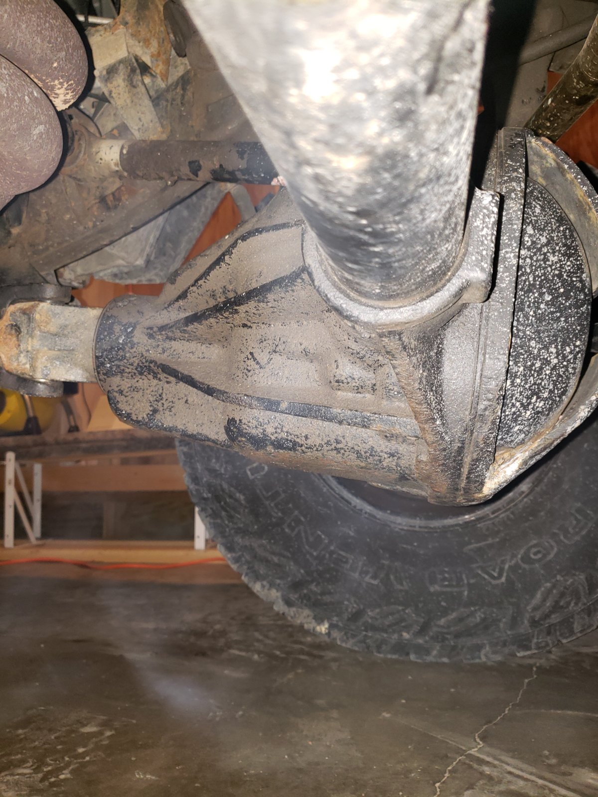

What are you showing us here Brad? Pinion angle? By that I can guess you have to little caster, still need a rack. Regardless, to straighten the wheel as Chris has mentioned just adjust your Drag link. It is the upper of the steering bars connected to the pitman arm.
Changing the axle side UCA bushings DOES change caster amount dependent on the wear of the old ones. All irrelevant to the steering wheel.
But not much should have changed on height of the vehicle or axle centering.
Can you post a picture of what you changed?
Yeah honestly I'm trying to get caster and whatnot. The draglink and tie rod adjustments are pretty easy to get. The guy at the shop said he would show me how it all works. Thanks everyone!
