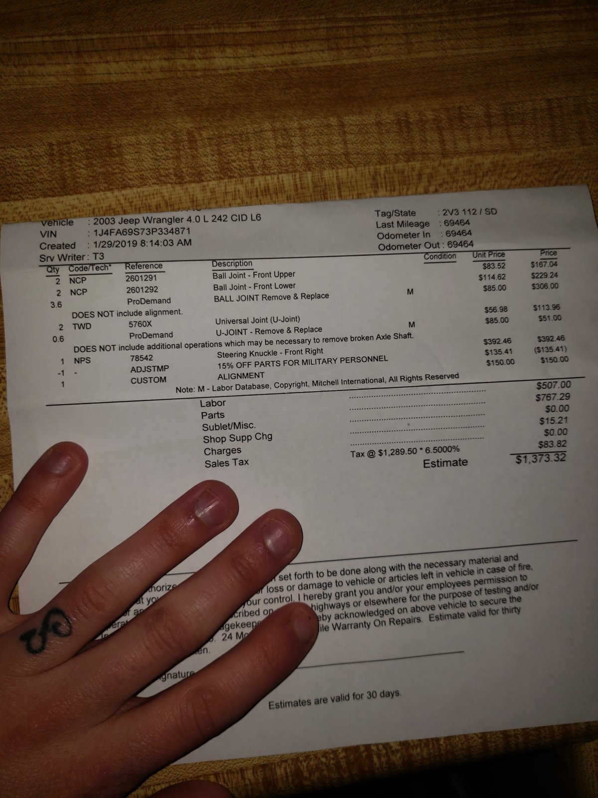

This is what I really needed. I have all the means to do the work just need the know-how and the tools. It also does not help that its been in the 10-20's for the past two weeks. At this point, working in the cold is just part of the jeep life....I guess :)
Well there's that.
