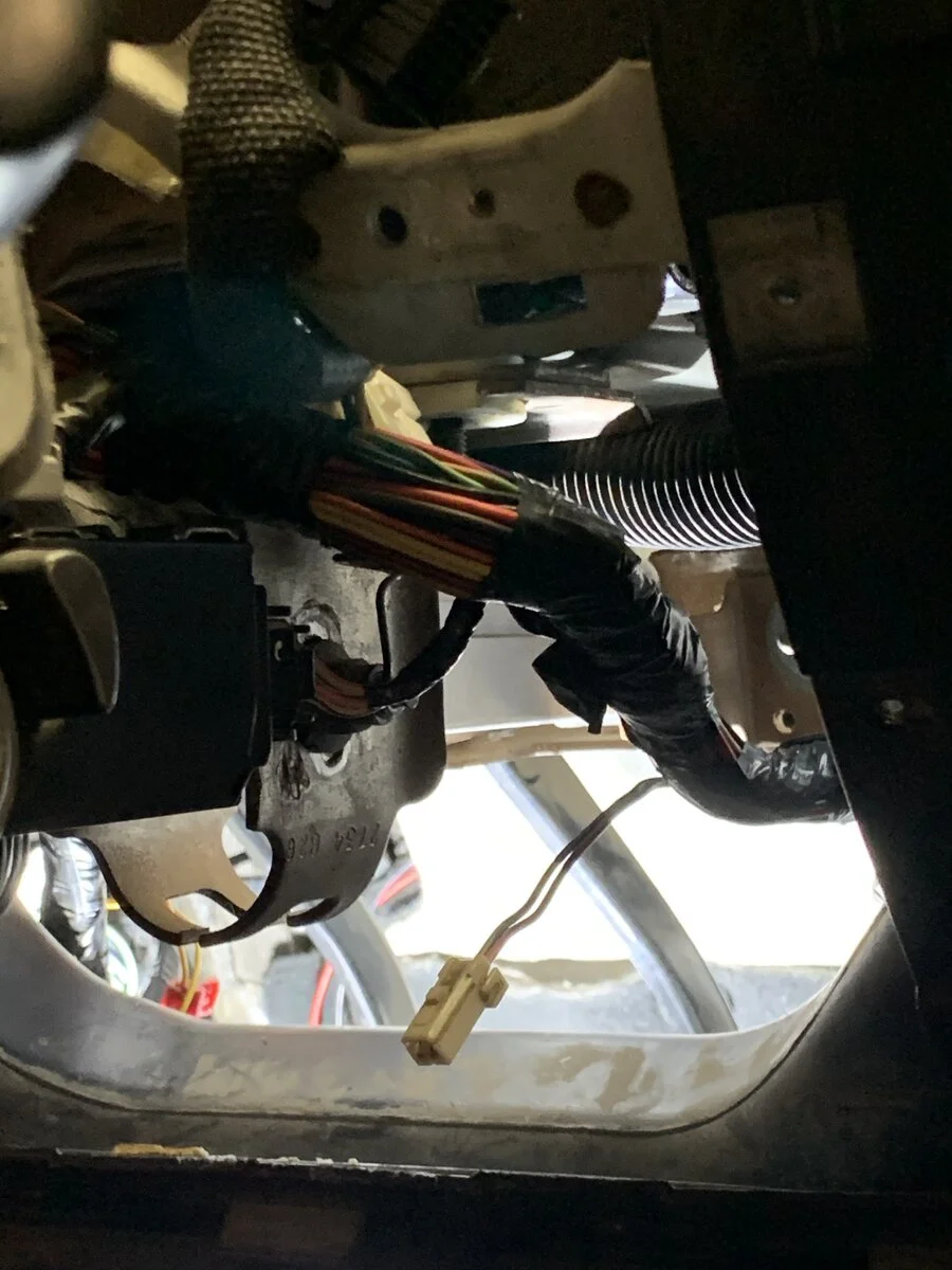

I’m pretty sure this doesn’t go to anything to my specific Jeep, but sanity check anyone?
Simplest way to figure out what that connector is for is to search the wire colors in the service manual. If that is DG/WT & PK/YL, it's the brake transmission interlock, which would not connect to anything in your case.
